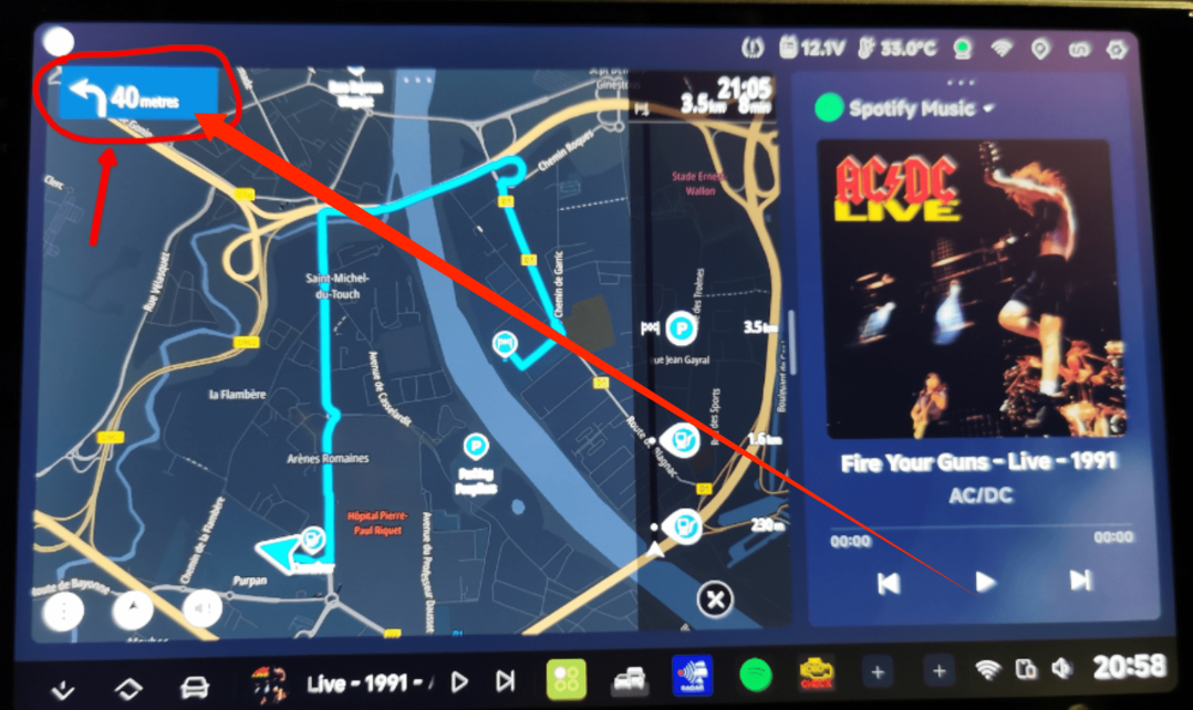

JhonnyD Hi Jhonny, it is actually what I have done. I have totally disabled the Navigation Widget (I am using minimal mode), and I have set up a task that launches TomTom 12 seconds after the WiFi of the Dudu7 is connected to my phone hotspot. That way I have the navigation prompts on the top left correctly. 🙂

I tried Sygic also maybe to replace TomTom, which I have in premium too. It runs faster compared to TomTom a tad smoother, I'd say, but the navigation environment of TomTom is way better of any other navigation software. Sygic looks so out-of-dated... In Sygic there is no bug like with TomTom with the next-turn navigation prompts on the top-left when you change from the navigation widget to full screen (they appear in the same place as TomTom).
