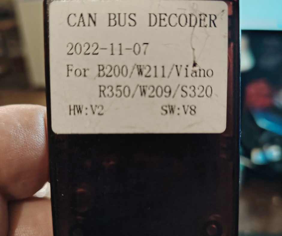

It works perfectly with the LZ(HZ) box. can this be fixed using the Hiworld box?
According to Hiworld a 2006 Mercedes C180 Kompressor W203 should be set to Benz - B200, however even with the updated software for it the Hiworld box does not work on that setting(no SWC or door opening) it works on Benz - old but not well and interferes with central locking, but do get car info. So I contacted hiworld who sent the update and suggested using the Volkswagen - PQ setting and with that setting I get SWC and door open plus car info and no key interference.
As I stated before I have also used this box
With that set on LZ-benz-B200 I get SWC door open, but no info and unknown canbus version.

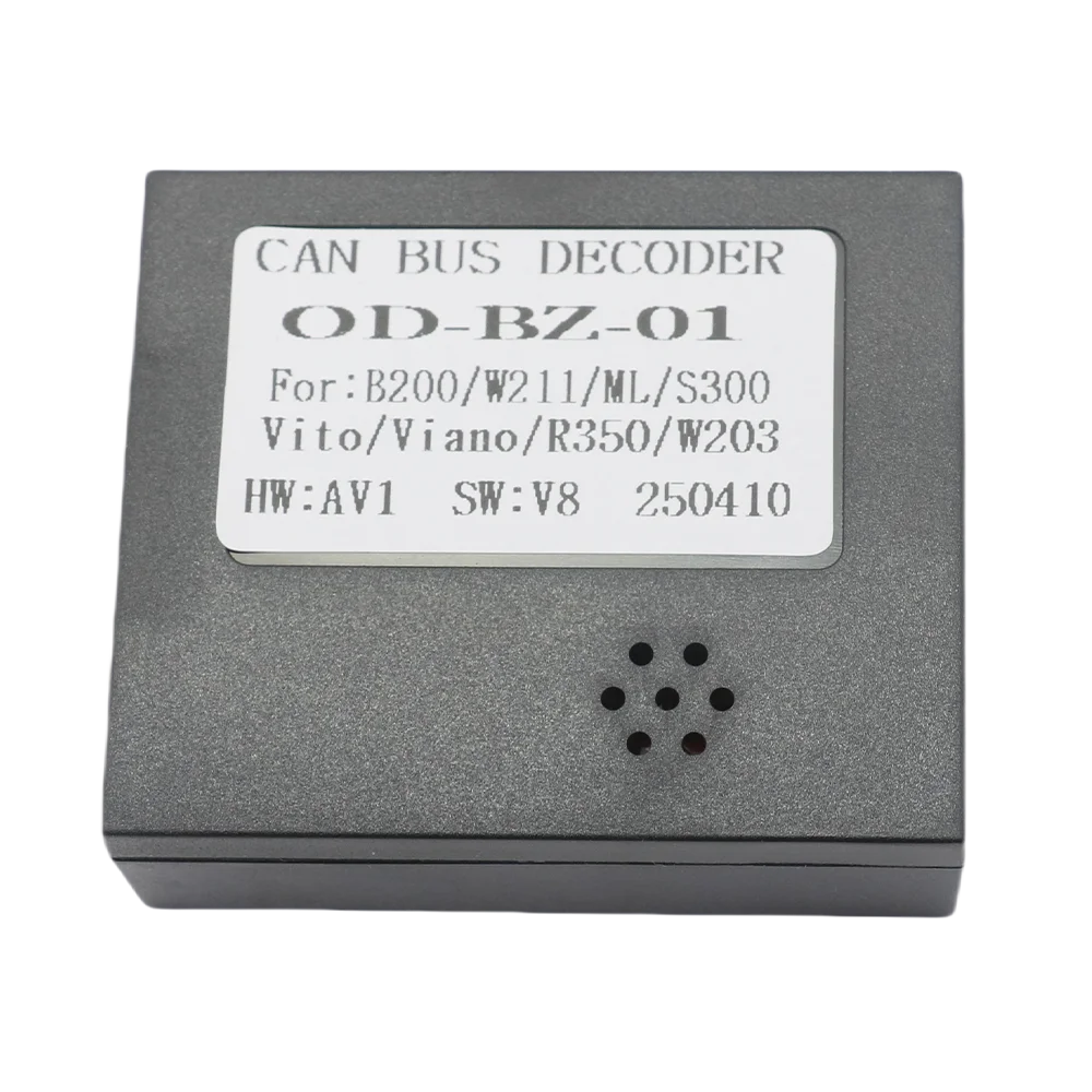

A mercedes forum advised me to buy and try this box
I have tried it set to OD-benz-B200 as instructed and I get the same as LZ box, works SWC and door open but again no info and unknown canbus version.
The best ans smoothest operation I get all round is with the Hiworld set to Volkswagon-PQ
Are the LZ and OD boxes actually compatible with dudu7? just seems strange that neither will read vehicle info yet the Hiworld will even when set on benz - old when the SWC and door open doesn't work
