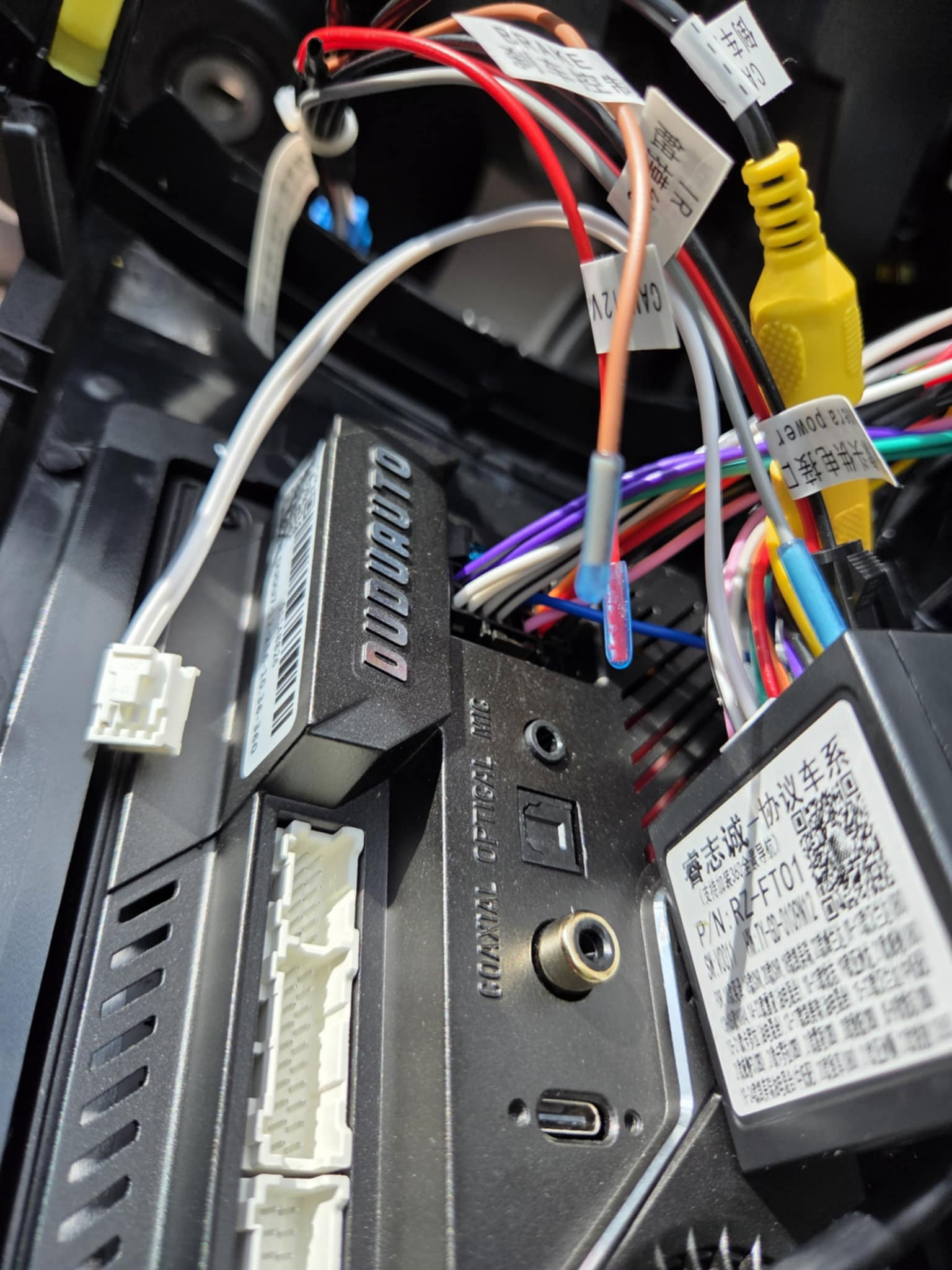

Hi everyone, im stocked to have the best Android head unit. Just need to do finishing touches
Camry 2014, no jbl amp. Whatsapp sales asked me for a pic of my dash and sent me the appropriate canbus and fascia. Sorry if other infos are needed.
It only has 2 wires to it, forgot to take front picture of it. It has maybe 4 to 6 possible pins wide.
What im I supposed to do with it? Right now, I cant seem to be able to train my steering wheel controls if that helps, will do a separate post abiut it.

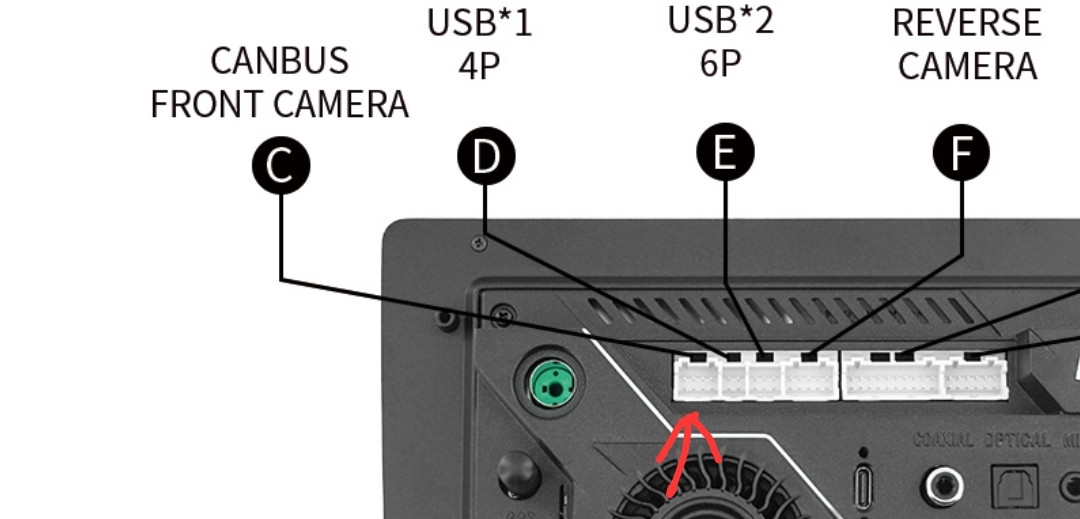

    You're supposed to connect it to this socket.
    Don't worry if it has only 2 cables. Third one is probably ground which is served commonly with another plugs.
    Thanks a lot! Steering wheel controls work! Now I can start to discover the software 😊
