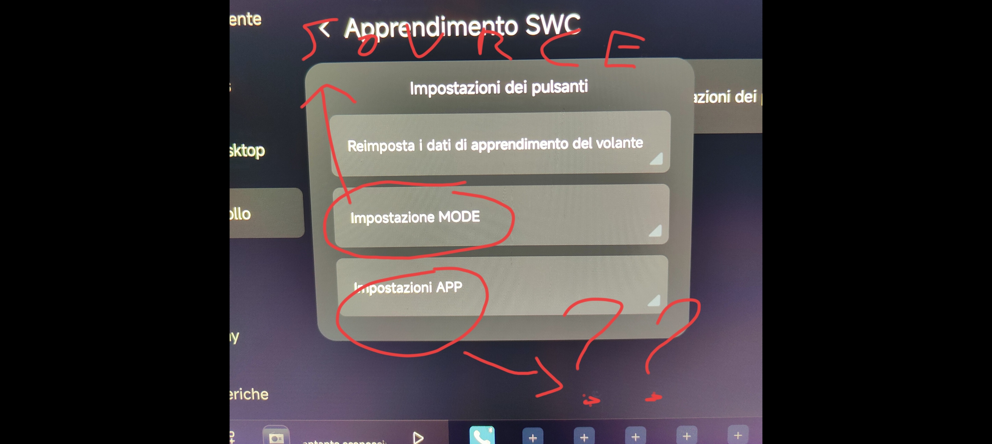

danzaywer Hi, i have a Ducia Duster II connected with simplesoft can-bas, My control are this "Souce audio" button Is associated with "MODE" in SWC settings and open in sequenze the apps I set while "MODE OK" button open directly FM RADIO and no button opens apps I set in "APP" Is there a way to change "MODE OK" association? I would likes to open voice assistent with It. Can-bus Is set to symplesoft-renault-dacia-2021, tried also renault- capture but same result.
DUDU-Meng If your SWC is connected via Canbox, only the MODE key can be set. Only SWCs that are MCU-learned can support all the functions here.
