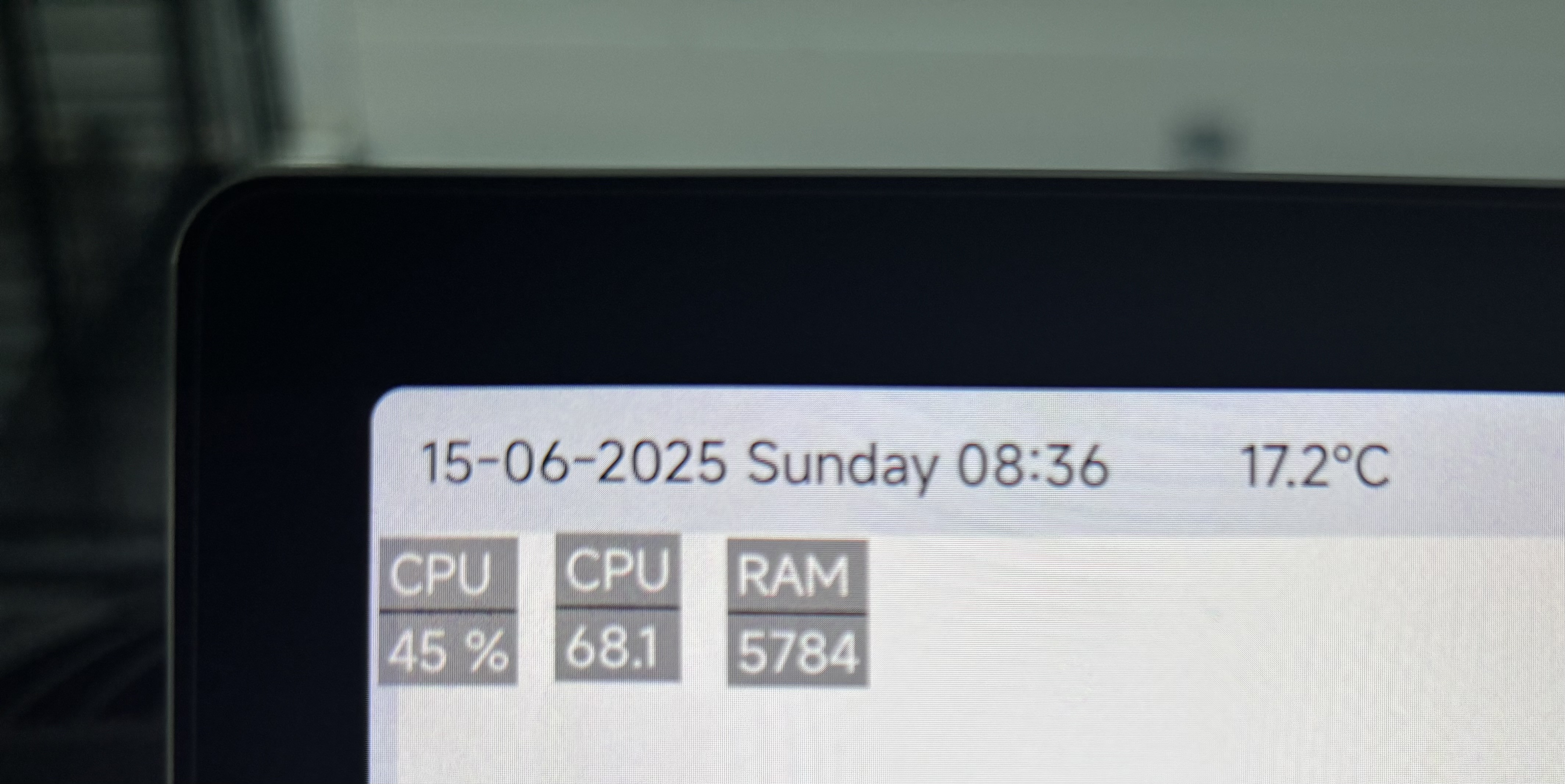

My unit (DUDU7 12G 512G 11" with 360) of only a few months old is getting very hot CPU temperatures.
I am using the app DevInfo Overlay and have selected the SOC temperature sensor to display the CPU temperature.
The fan is at default setting so turns on when the sensor above shows +60C.
I have turned screen brighness down to 0 during the day which is still good enough to read, the unit feels warm to the touch which is normal.
I have seen a few Launcher crashes in the last few days, that might have been related to the CPU heat.
The units temperature rises to 60C within 30 minutes of use and mostly remains between 60-70C but that is with about 40-60% CPU use, when being pushed to 90-100% usage the temps go up to 80-90C I have seen.
