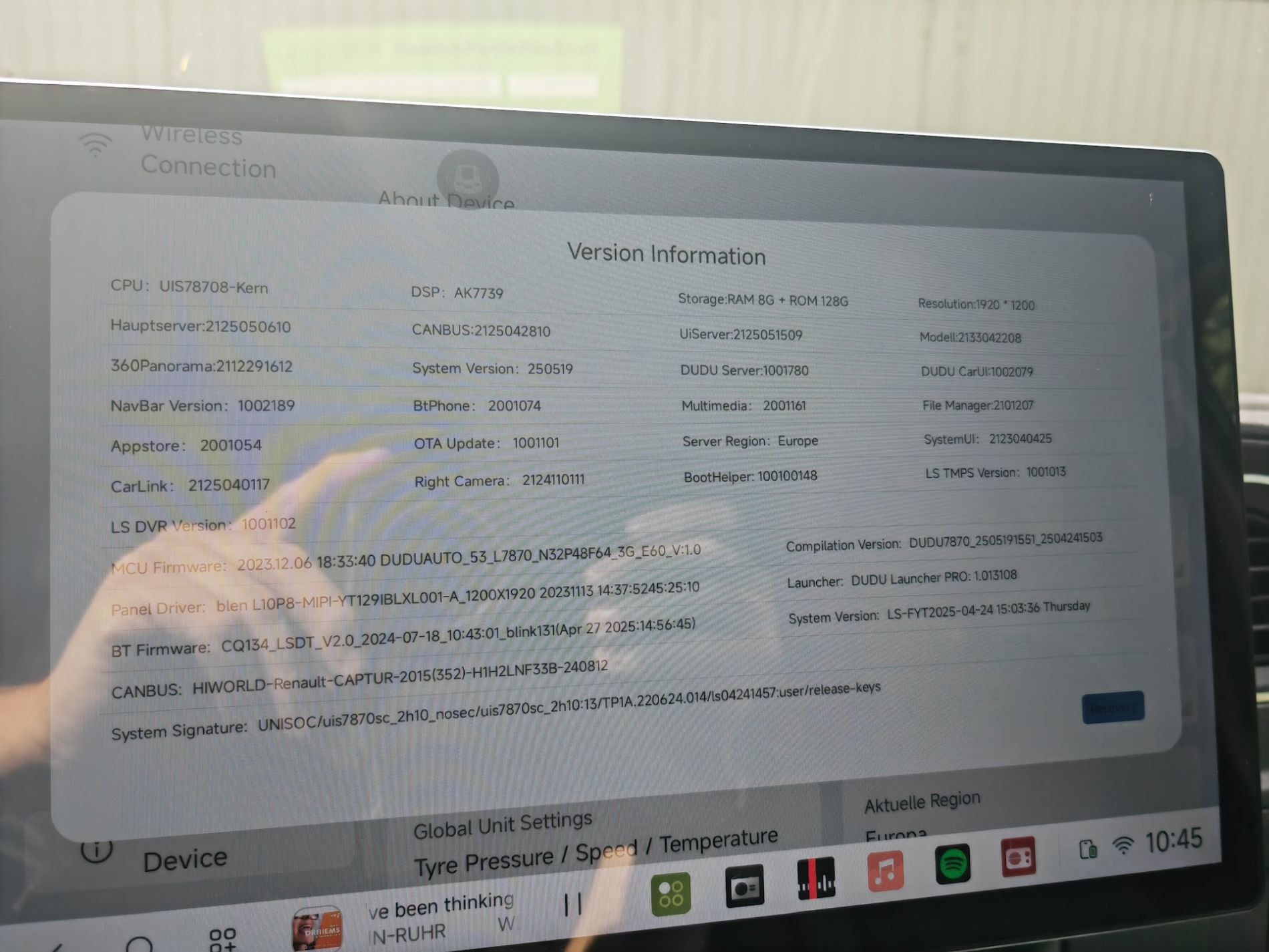

    Cabrioman
    1. Please upload a photo of your system information by going to Settings > About > and holding down the image in the upper left corner.
    2. Please specify whether your phone's Wi-Fi hotspot is 5G or 2.4G.
