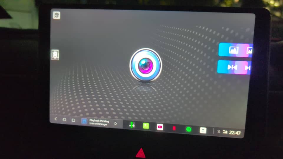

Did anyone has experienced the same? After reverse camera, the figure below is displayed around 8 to 10second before go to normal/ main layout

    Settings - Vehicle Protocol - Reversing Image - Other Settings - Switch to Front View After Reversing.
    Check if this switch is turned on.
