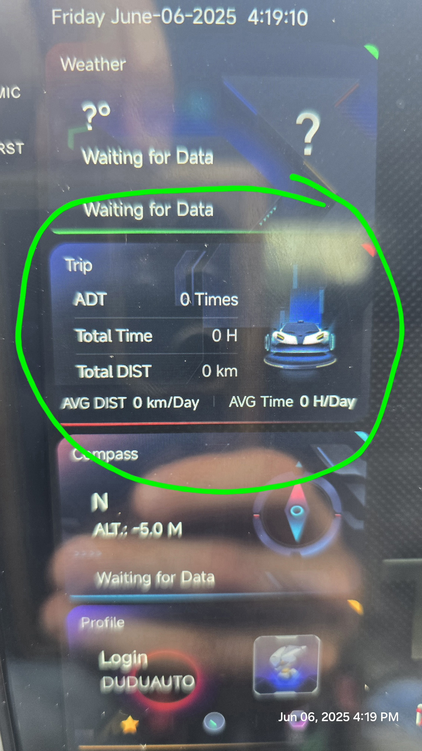

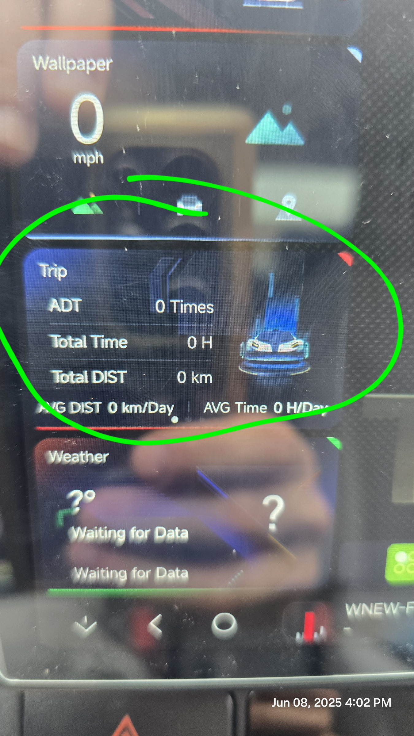

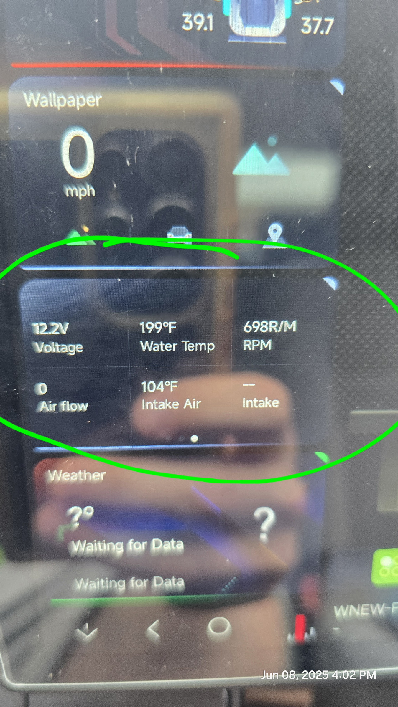

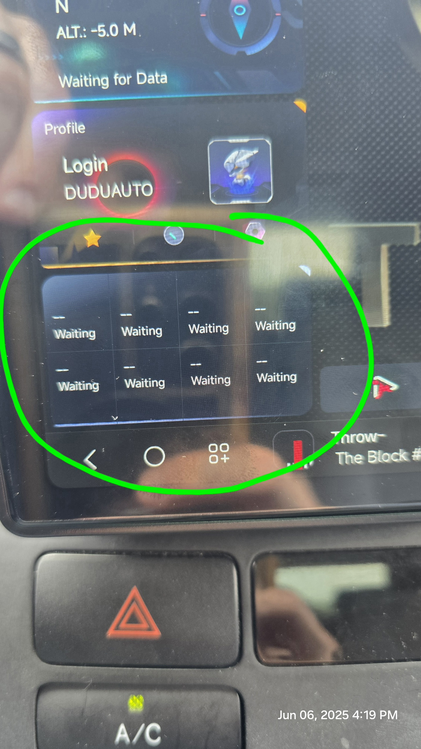

Skillzo1 What are these widgets for and what controls them? None of the apps seem to work with them and i cant get them going to see what its for. This is where you can share your experiences, tips and tricks with other DUDU OS users. Explore the possibilities of this innovative platform and learn how to get the most out of your DUDUAUTO device!

Skillzo1 DUDU-Meng i got this o.e to work with a canbus. Even tho its not for my car it still works by picki.g a similar car and the obd2 being connected. It give me some but not all which is ok. But i still cant get this one to work. What do you mean using gps? How do i do that?

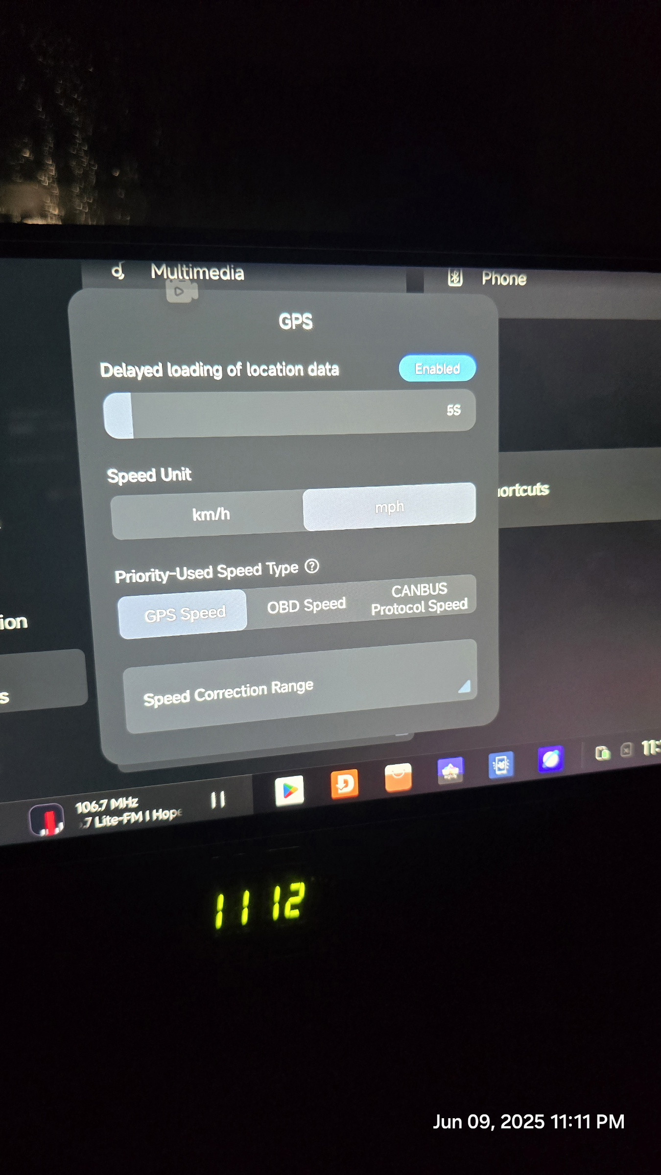

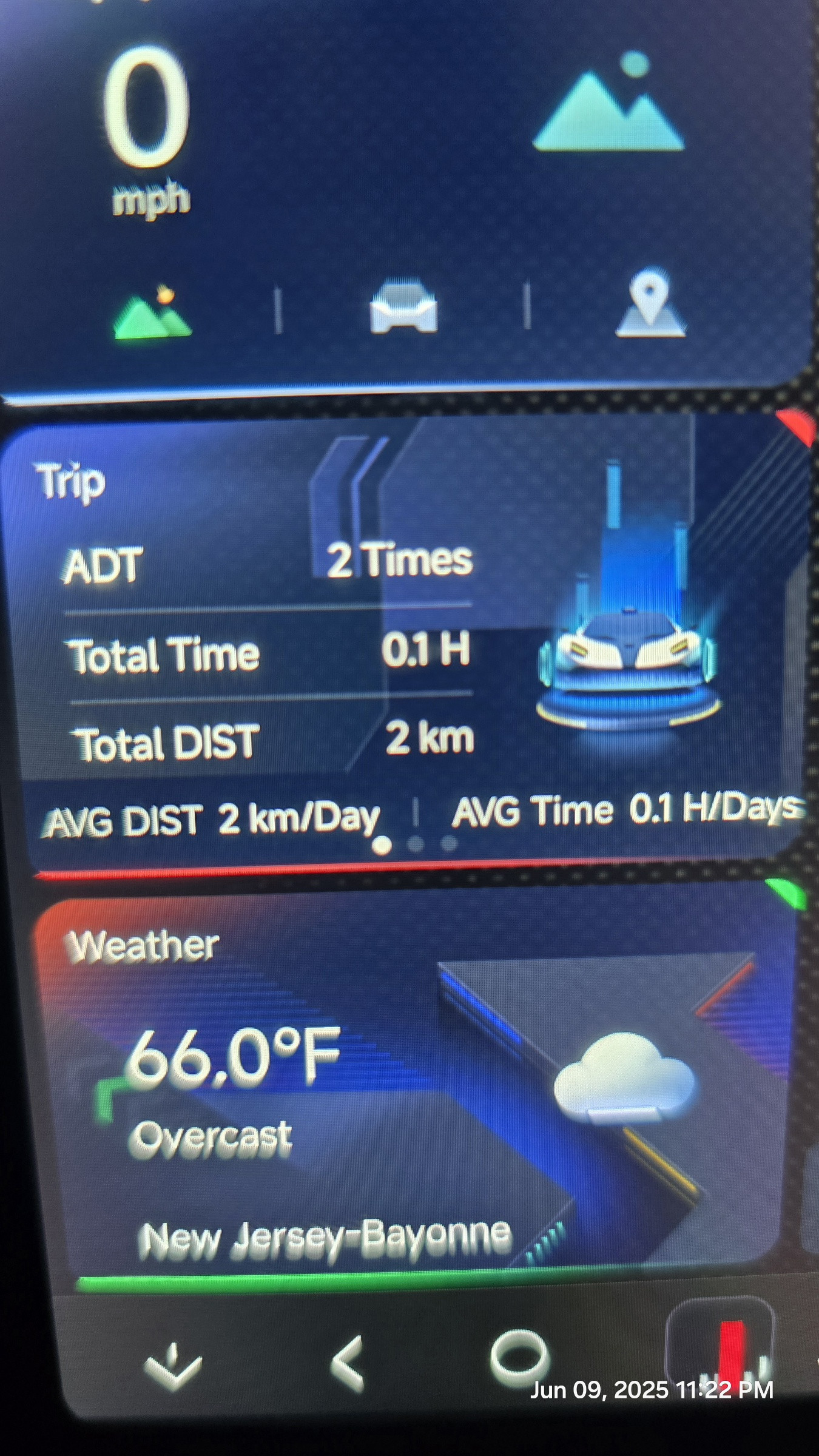

DUDU-Meng Skillzo1 Settings - More Features - Positioning and Speed. Try switching the data source from here to test it
DUDU-Meng Skillzo1 Just select MPH, but there are some data that don't support mileage units, and your picture is pointing out that these don't work yet
