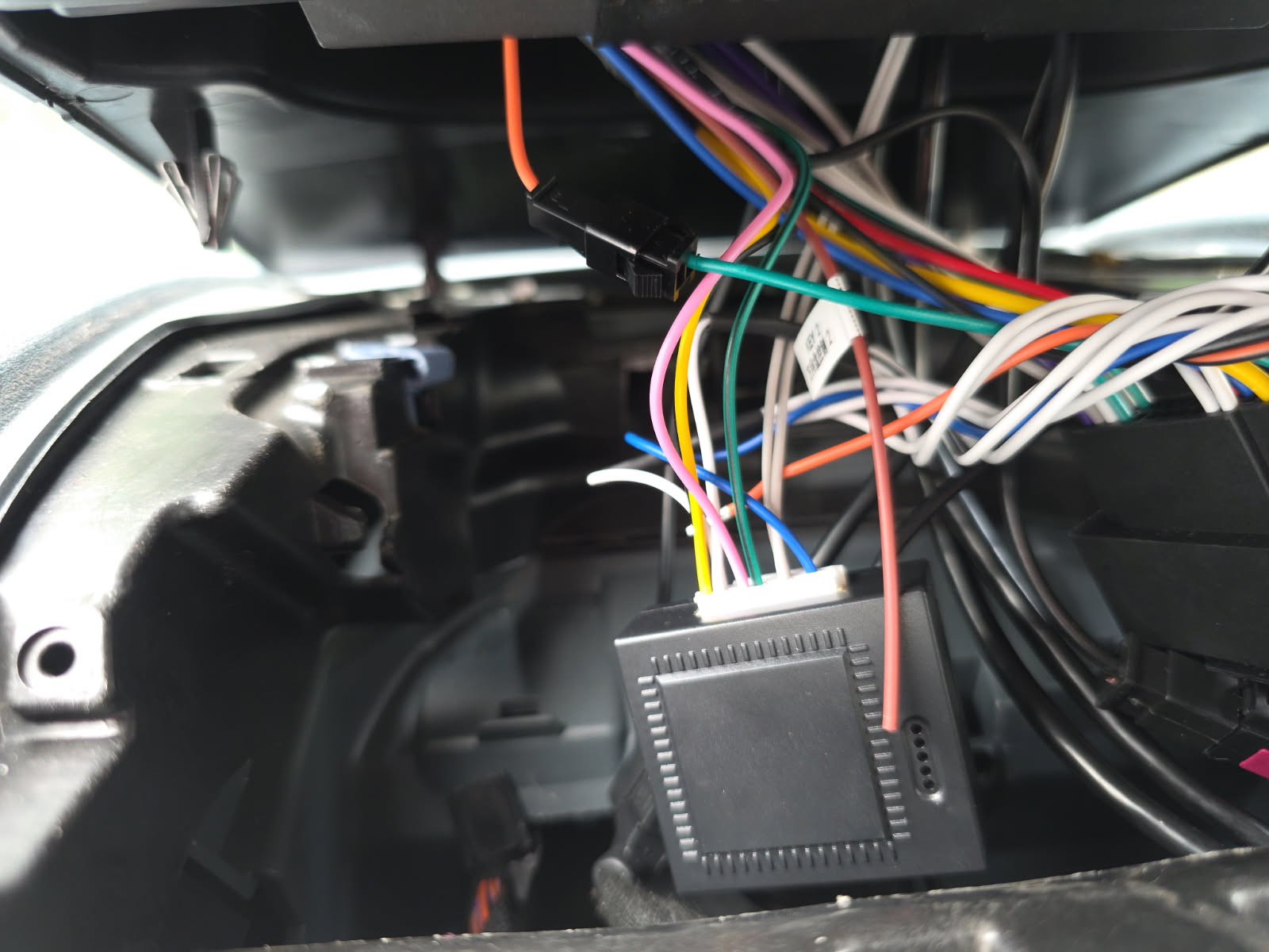

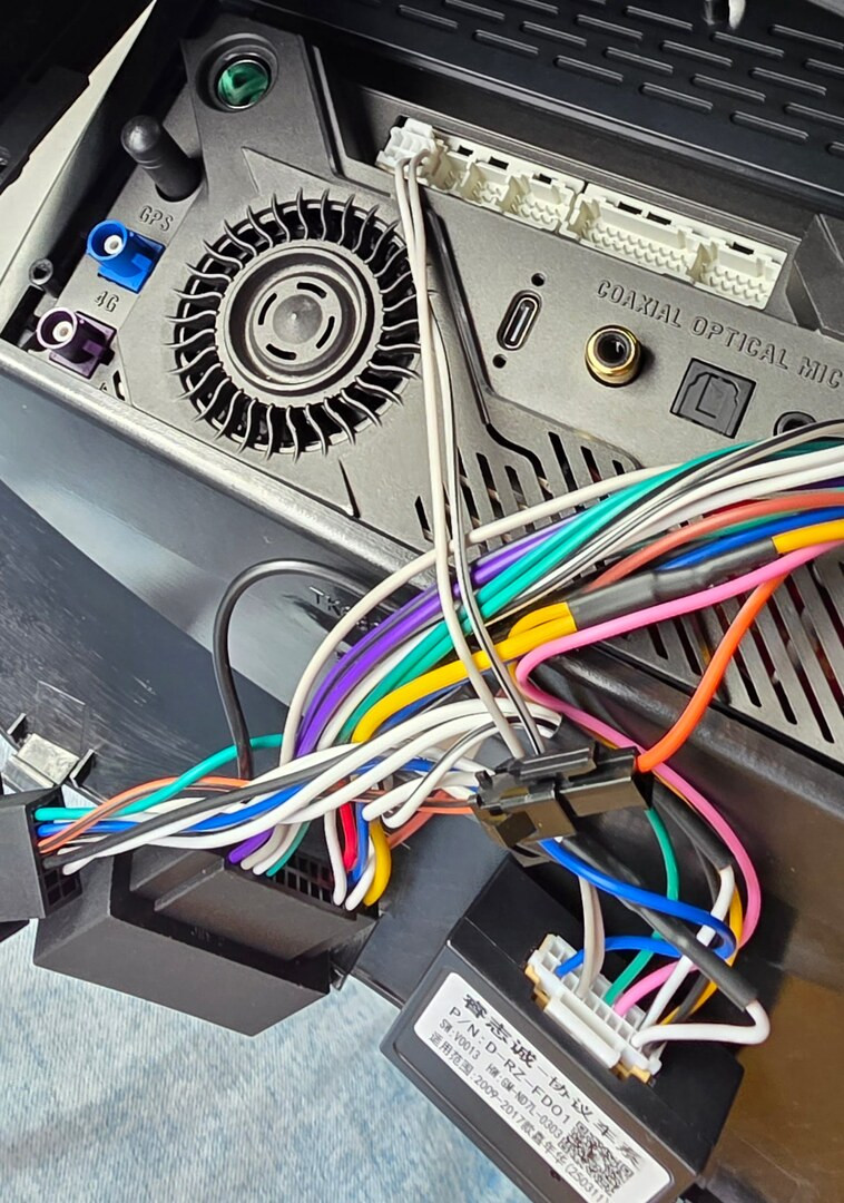

Hey i have problem with my car ford fiesta mk7 I can't connecting canbus can you help ?
Yes in dudu i selected ford fiesta and check all model canbus rise
Yankes What do you mean you can't connect the canbus? Physically or you can't get it to work with for example the steering wheel controls? I have the same problem at the moment with my ford fiesta 2014 all the connections are done but the steering wheel controls don't work
stefano_na write to me in WhatsApp a send you photo 721--860--057
Orange and green cable
Yes! It worked with the green plugged in the brown one! I was trying green with green but it didn't work,
then I tried the green and brown and it worked for me. Thank you my friend , Were you able to solve the problem with your Ford Fiesta?
