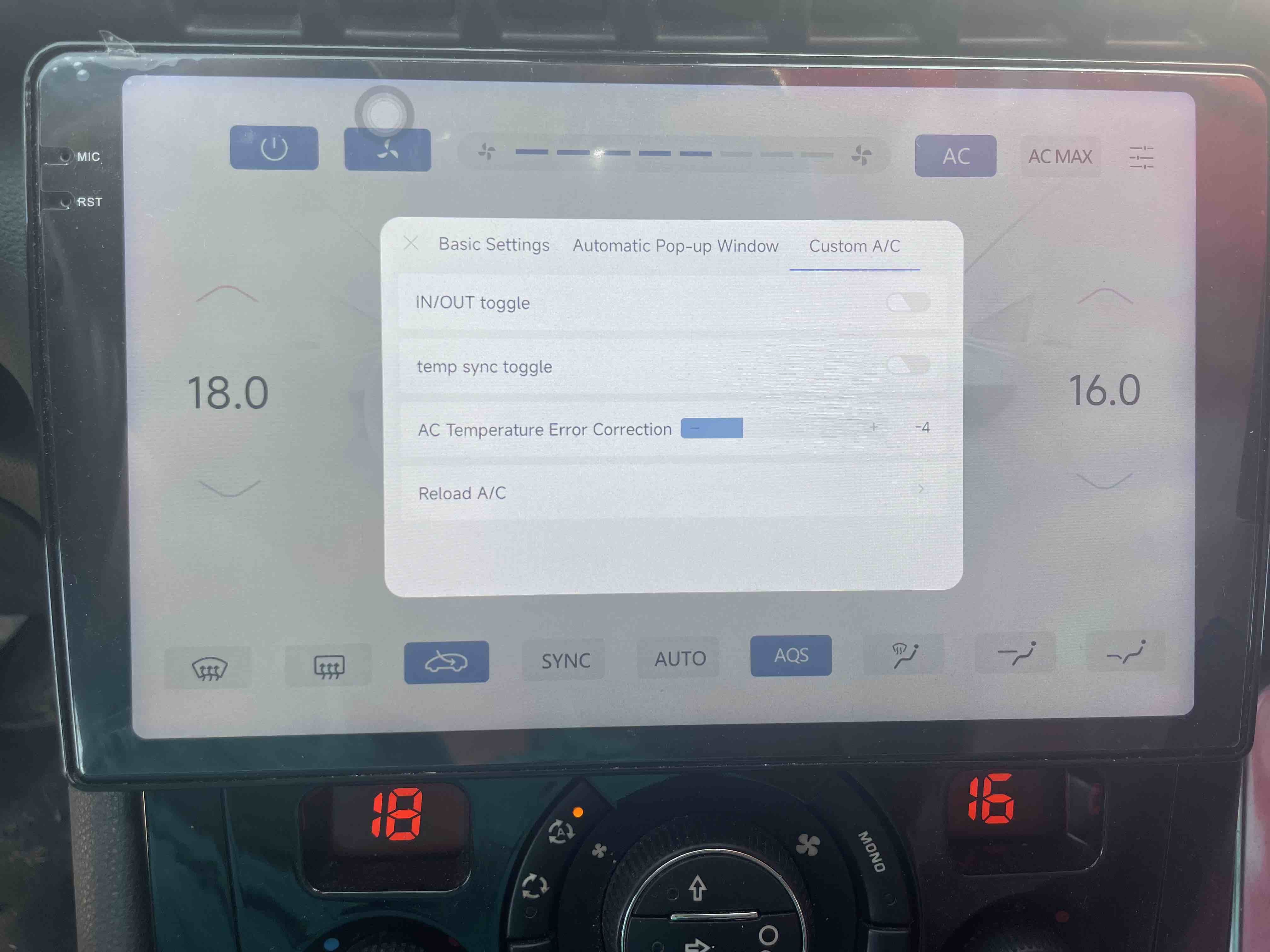

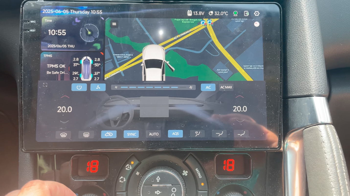

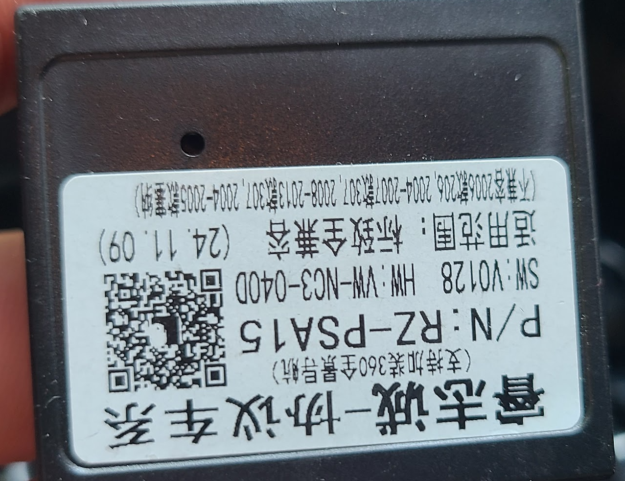

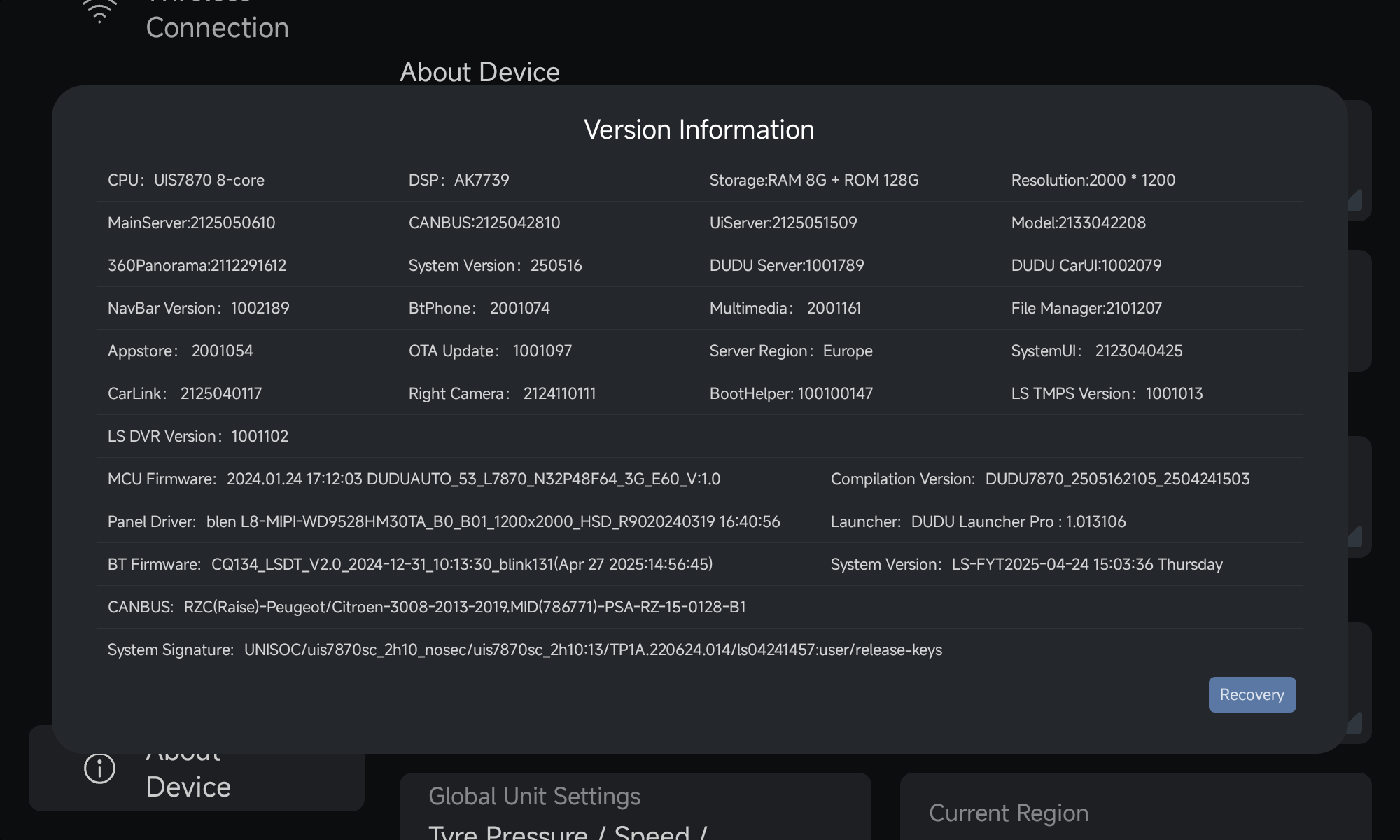

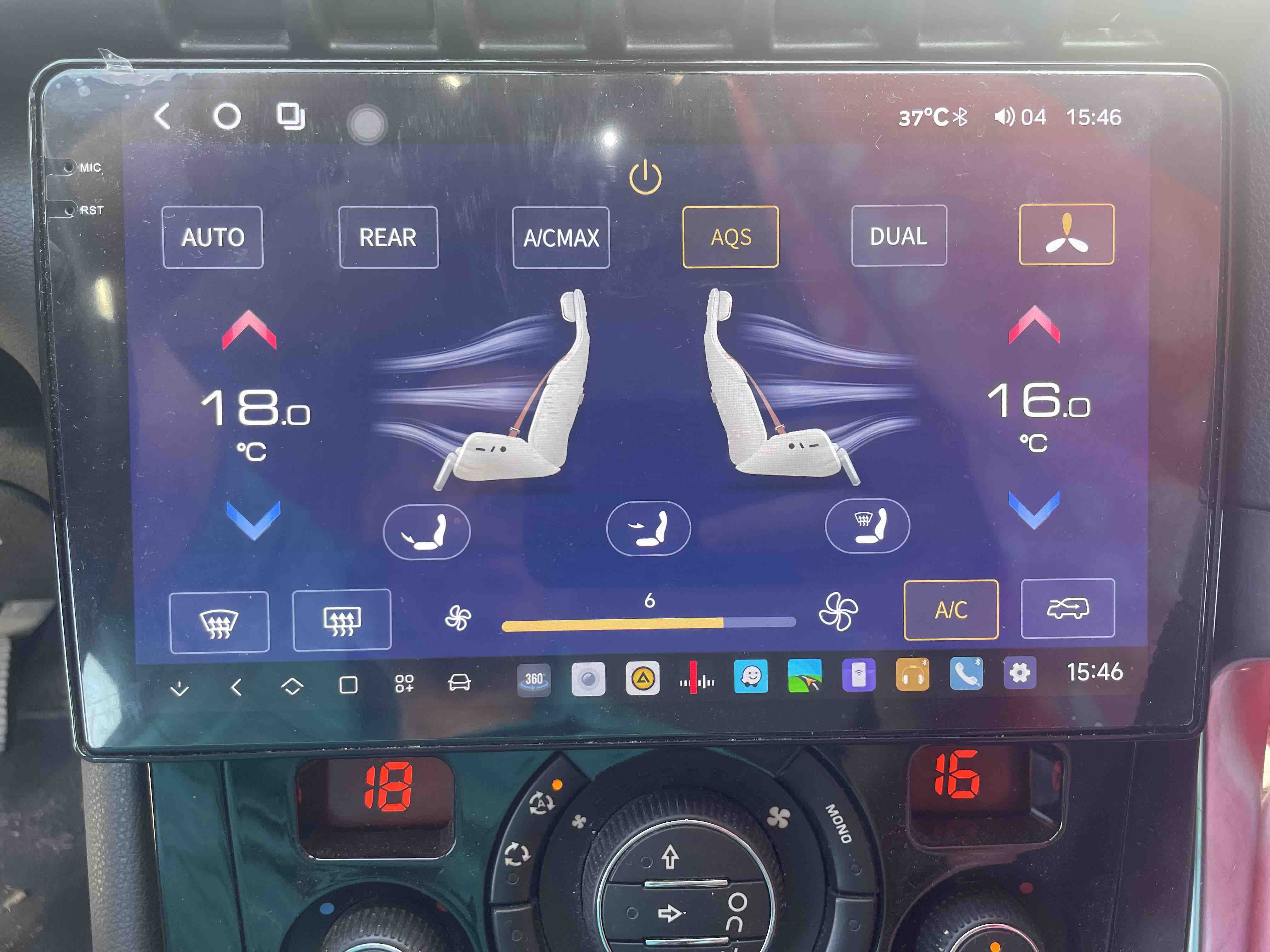

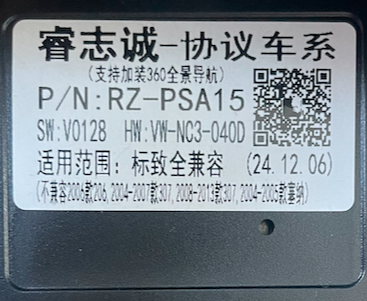

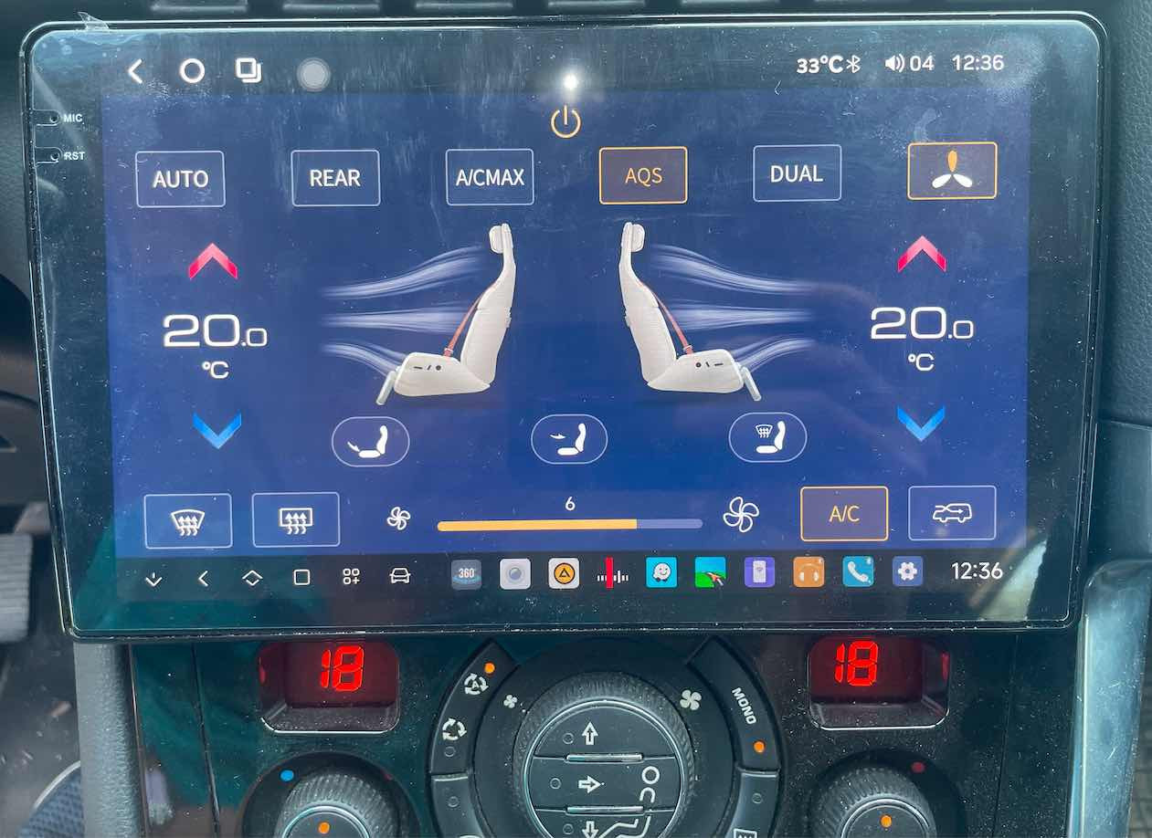

viksantoro A/C status out of sync Car: Peugeot 3008 Year: 2009 Canbus: Raise RZ-PSA15 v.0128 System Information Video of the problem Canbus Log on screen Canbus Log File

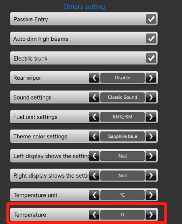

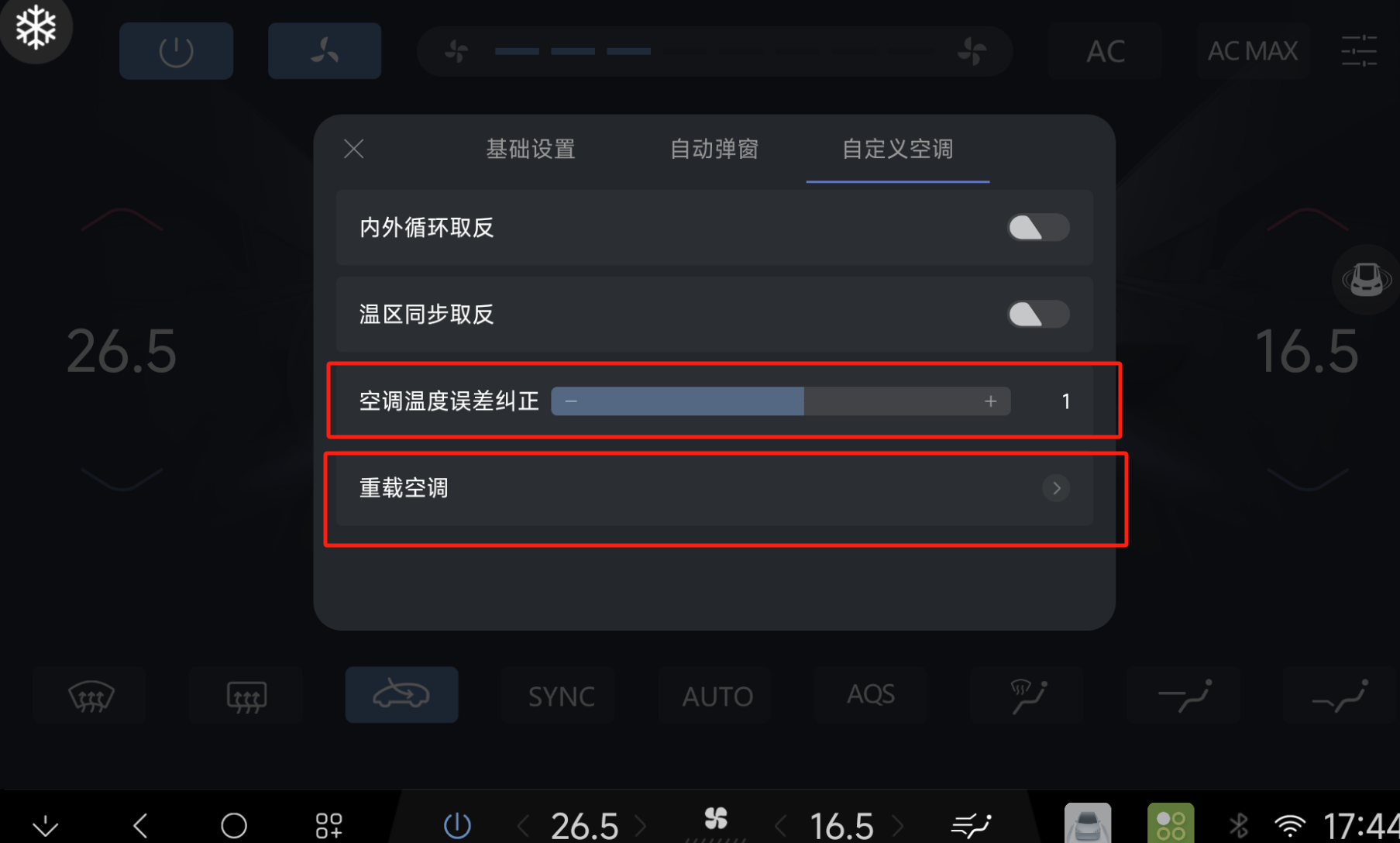

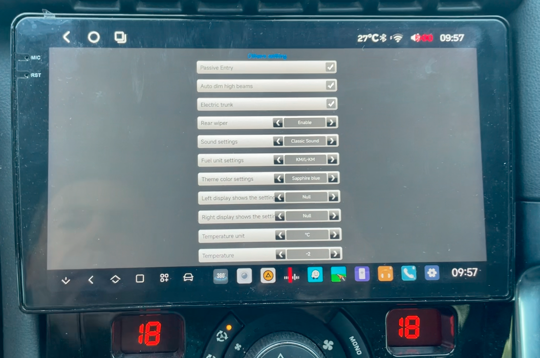

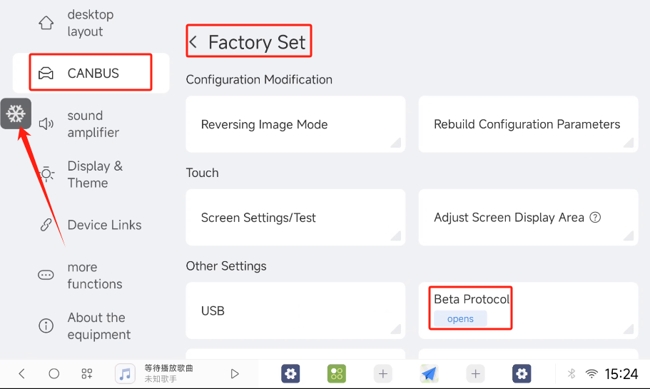

dudu-lai viksantoro Open the test protocol in Settings, download the Touchscreen Assistant app from the App Store, then tap the snowflake icon to go to another air conditioning UI and try to see if temperature-2 takes effect
dudu-lai Record video if the AC UI for the snowflake icon is valid and the DUDU AC UI is invalid If the AC UI for the snowflake icon is also invalid. Record CANBUS logs as the temperature increases or decreases (use cell phone camera to record video)
dudu-lai viksantoro Please install these 2 APKs to try it out https://drive.google.com/drive/folders/1-oQriksyIFuWoJ37-kTTEFp4WRuReZMS?usp=sharing
viksantoro dudu-lai Thank you very much! After installing the two APK files, everything works as it should!

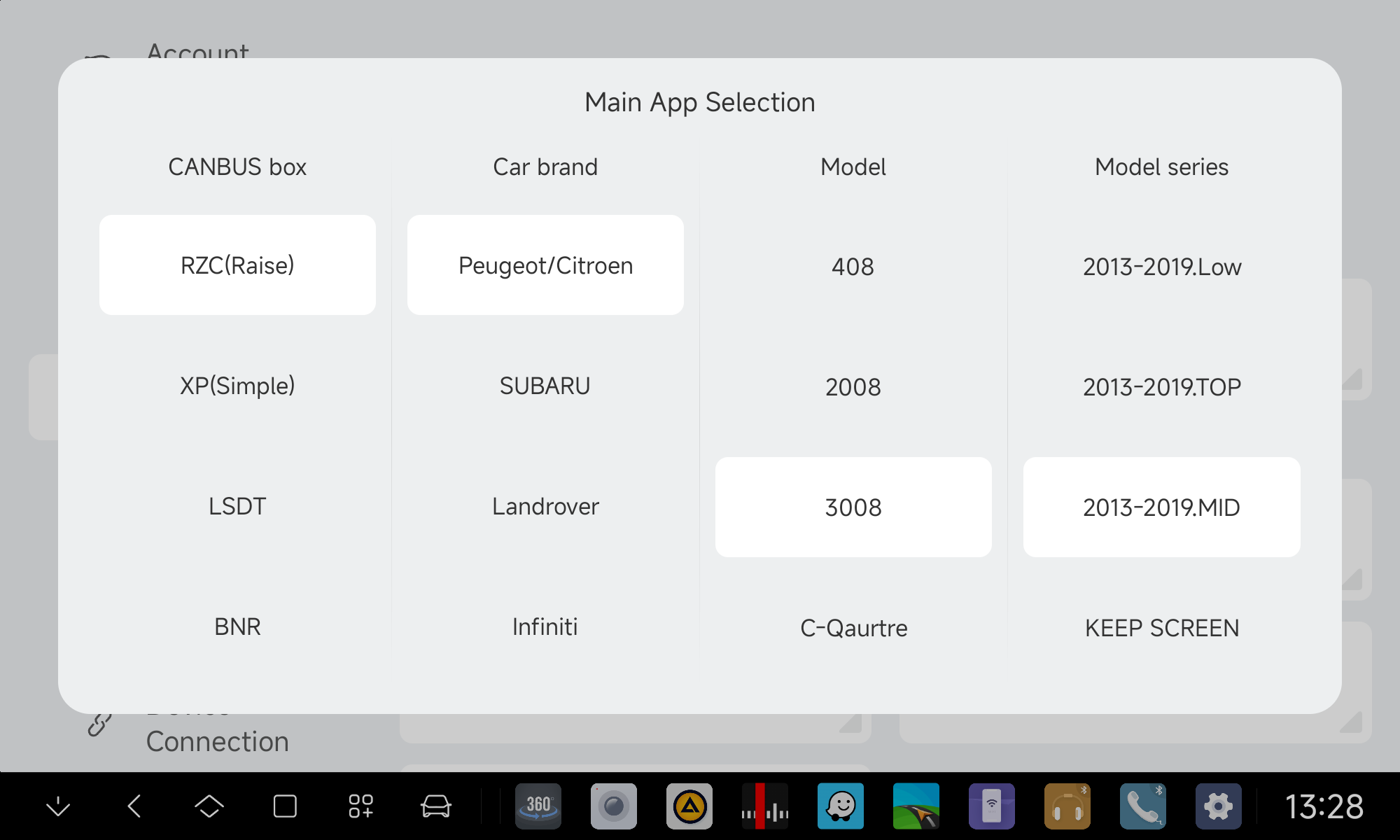

dudu1897 @dudu-lai The settings RZC(Raise) / Peugeot / 3008 / 2013-2019.MID are working for the climate control of my Peugeot RCZ. (The settings RZC(Raise) / Peugeot / RCZ/ KEEPSCREEN are not working for climate control). Please update the settings for climate control for Peugeot RCZ in the next release with the configuration from Peugeot / 3008 / 2013-2019.MID.
