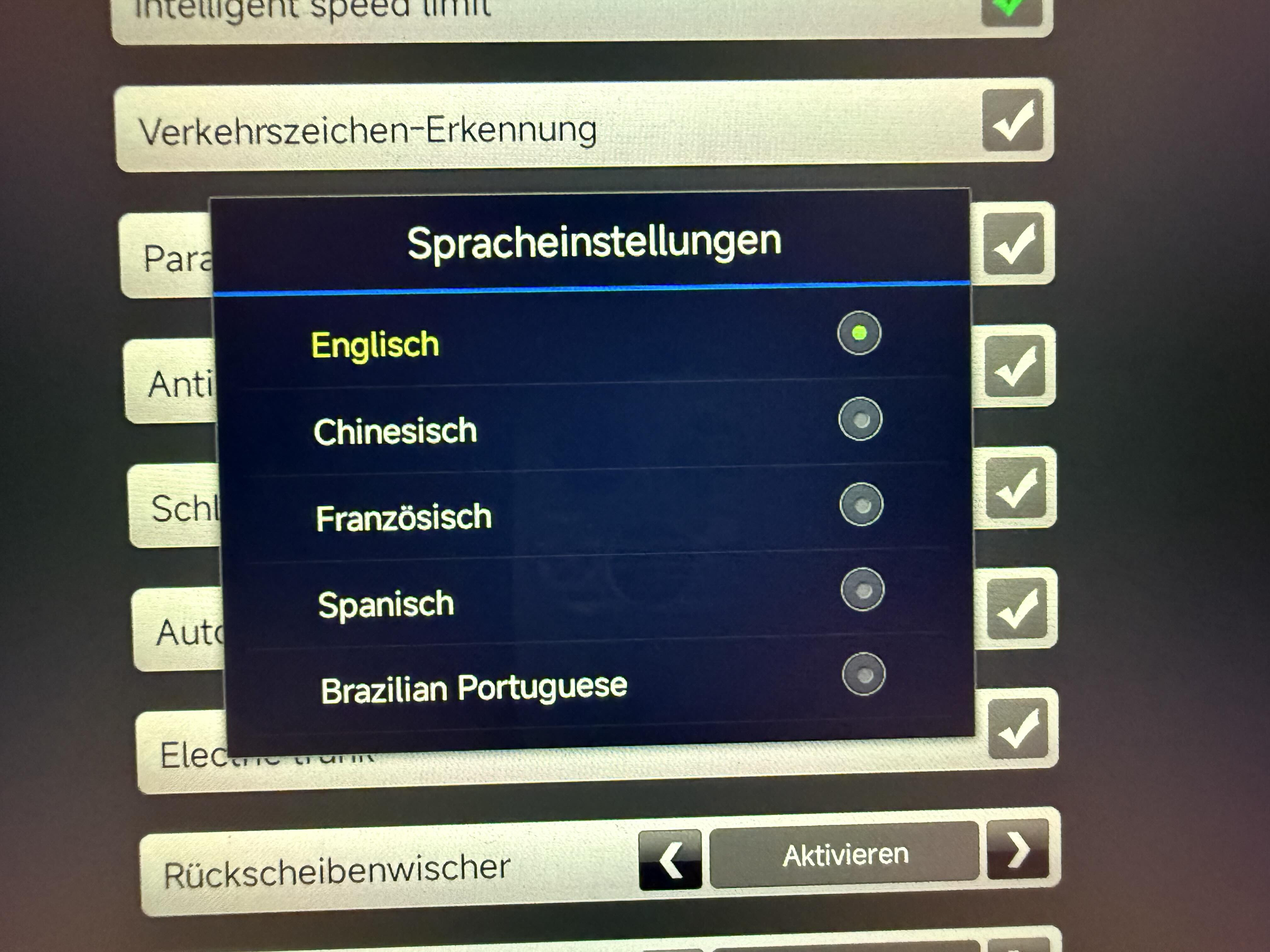

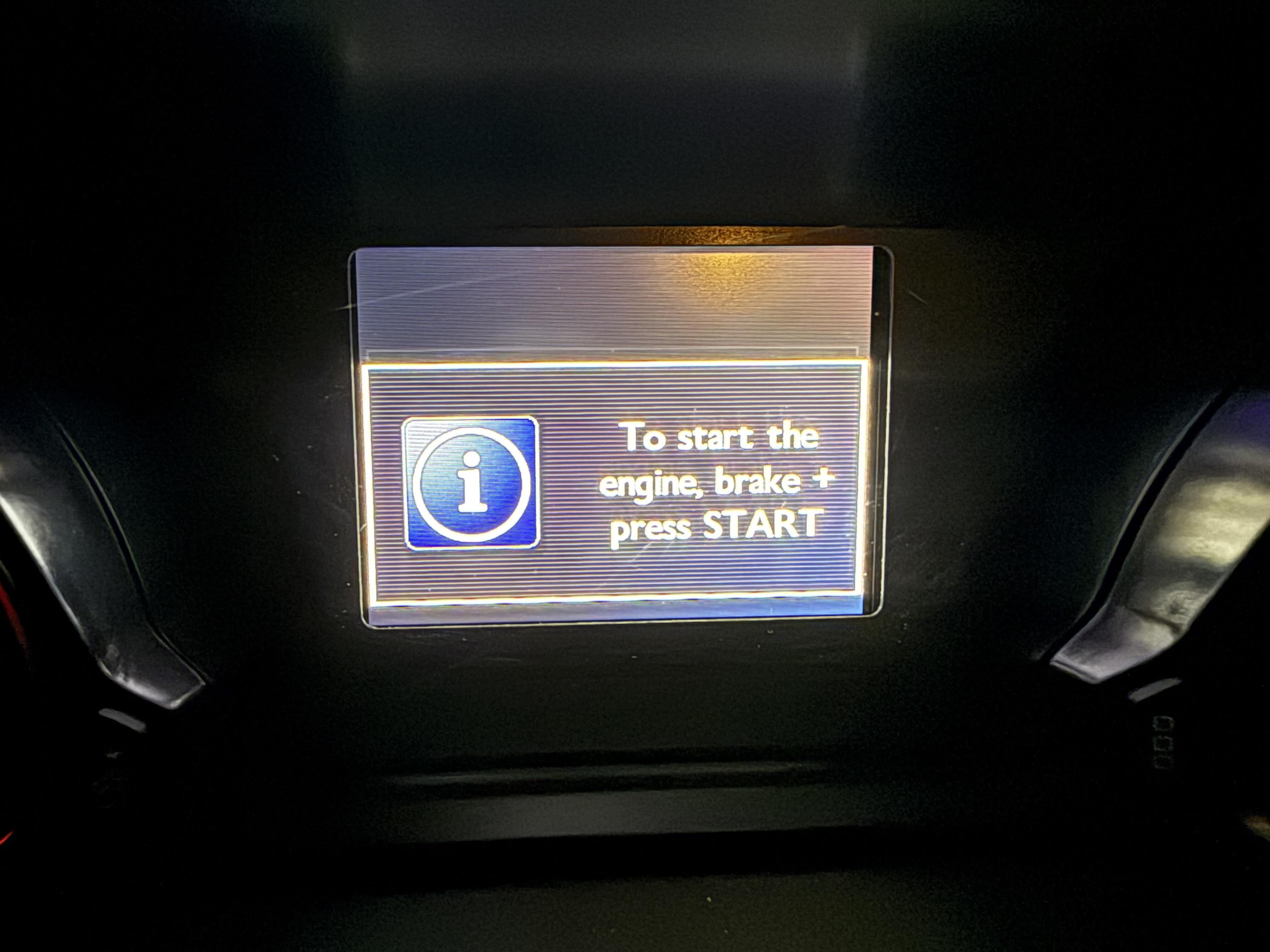

  • i can't set up german for the car messages (the car does german). i can select the language but it goes straight to chinese. the only language i can set is englisch or chinese. any ideas?

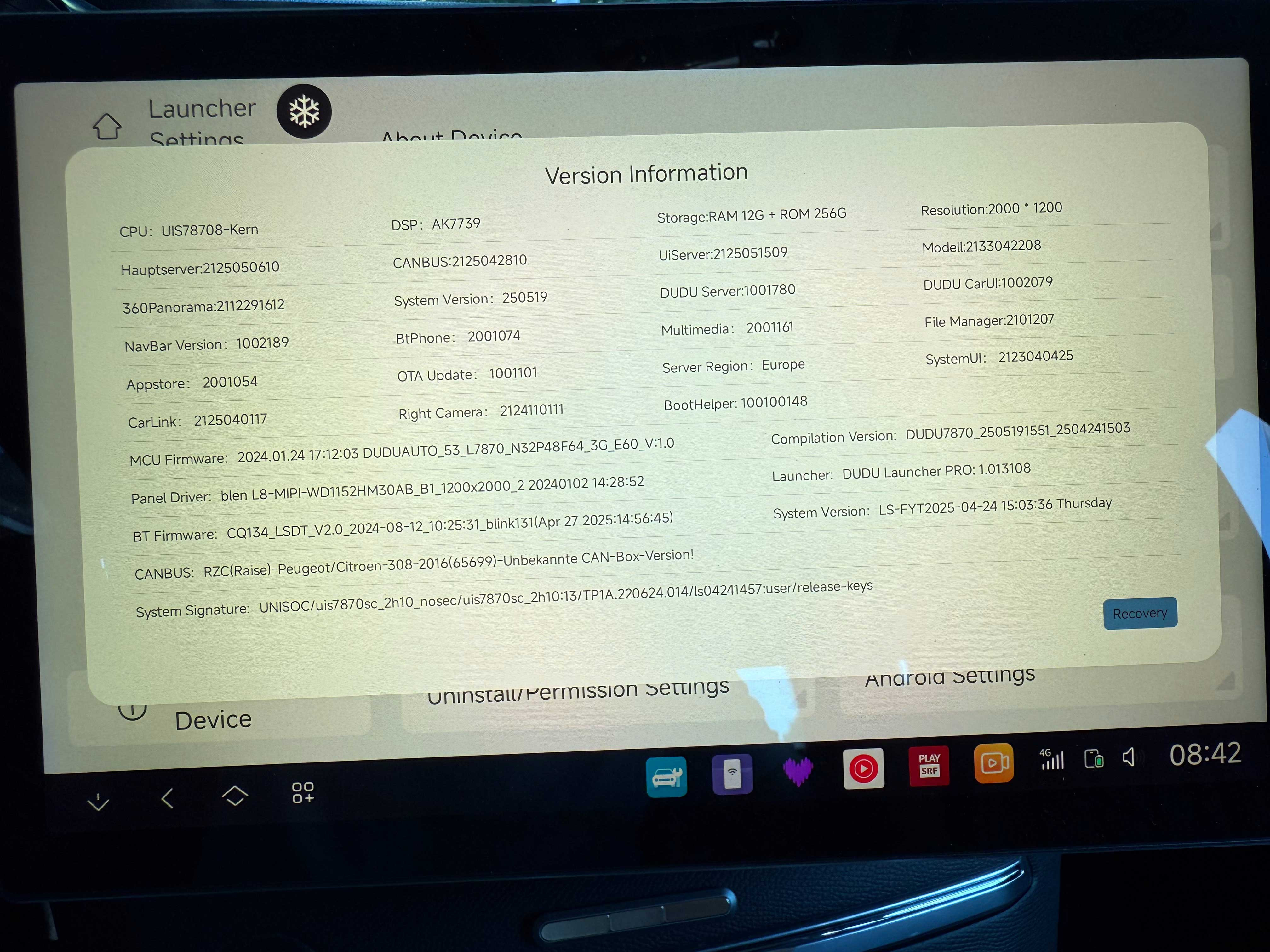

    Take a photo of the system information and upload it here.
    Settings - About - Press and hold the image in the upper left corner.

        A photo of the system information will follow soon.

          3. In the language selection, you need to add the motor first before you can add other languages. The Chinese and English you see were added in advance.

            3. How can I add the other languages? The languages ​​are already stored in the vehicle. Without Dudu, everything was in German, and now I only have English or Chinese...

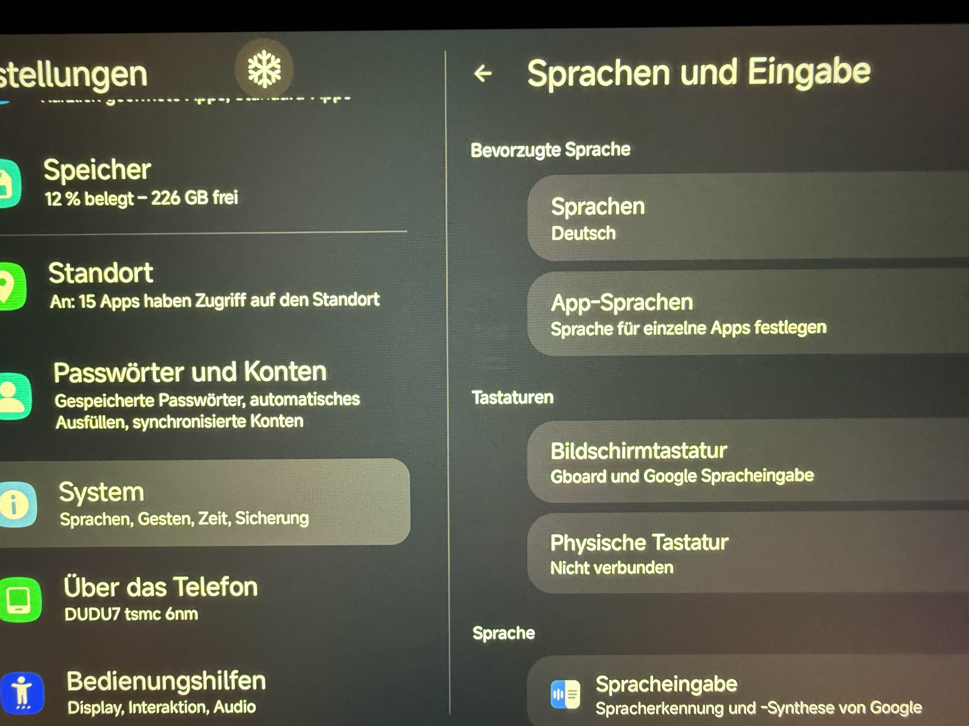

              3. Language: Settings - About - Android Settings - System Settings - Language and Input - Click +.

                3. i don't talk about the main language from the dudu os (there i have German). i am talking about the car messages in the center display of the car (in front of the stearingwheel). i can change it in the carsettings but there is only chinese and englisch that works.

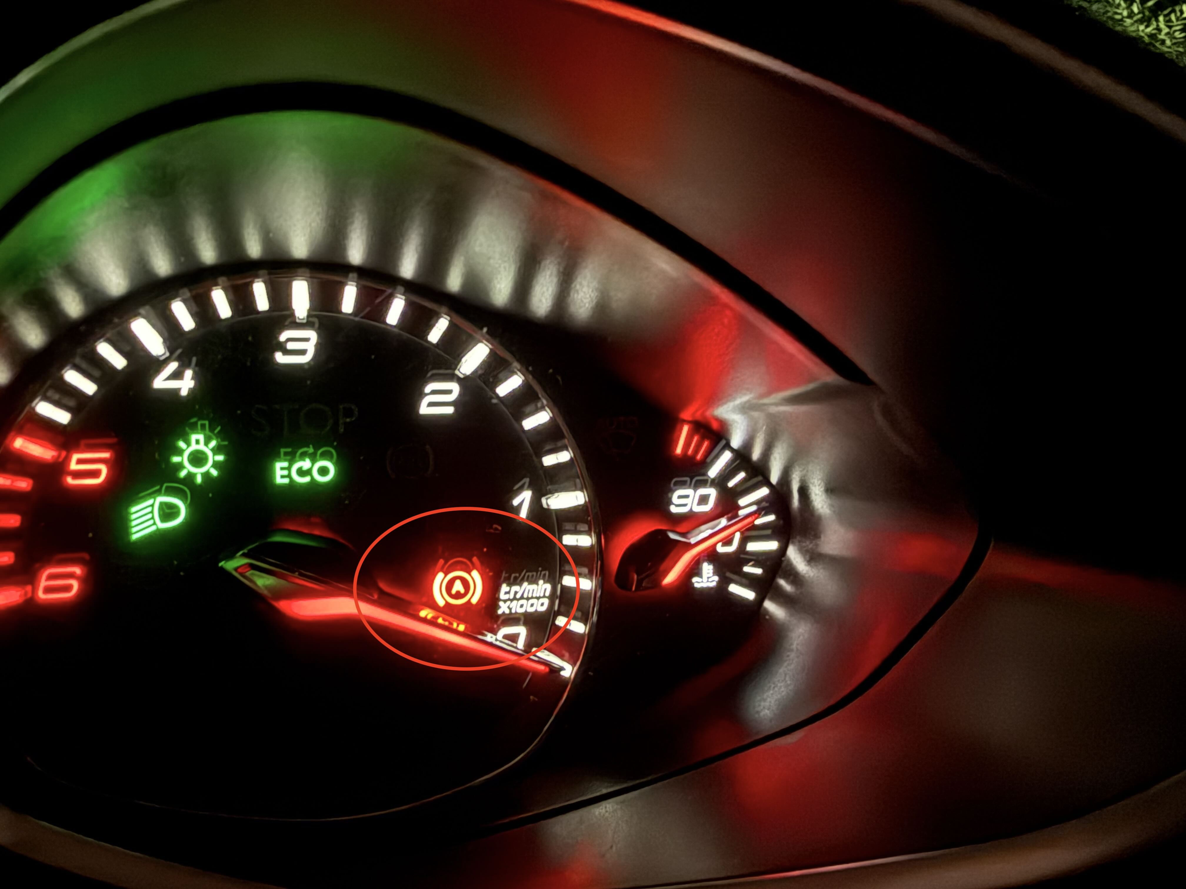

                see also the attached images.
                thank you
                  The instrument panel reminds you to press the brake pedal before starting the engine. Shouldn't that be fine?

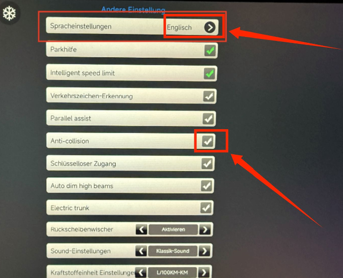

                      DUDU-Meng The message in the panel is just an example. The point is that this message should be in German. However, I can only select English or Chinese in the car settings, even though all other languages ​​are displayed. When I press German, it switches to Chinese. Only two languages ​​work; all the others don't.

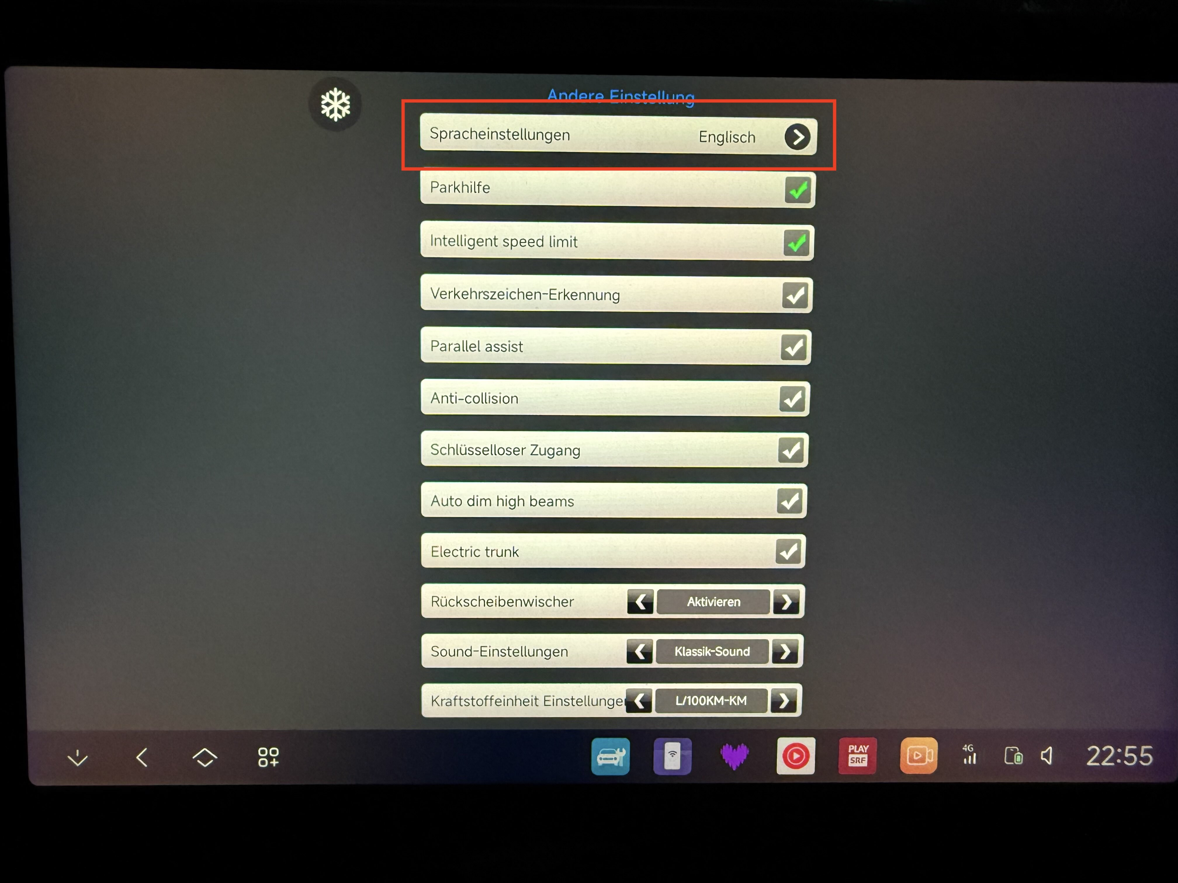

                      DUDU-Meng Here is a Video with the log on and then i press the anti-collision button.

                      Now its only 2 thinks: the anti collision function and the language of the car messages...
                      any ideas on this?
                      Please take another photo, including the language switch and collision prevention switch. You need to tap several times, and you also need to tap several times to select the language. Thank you.
