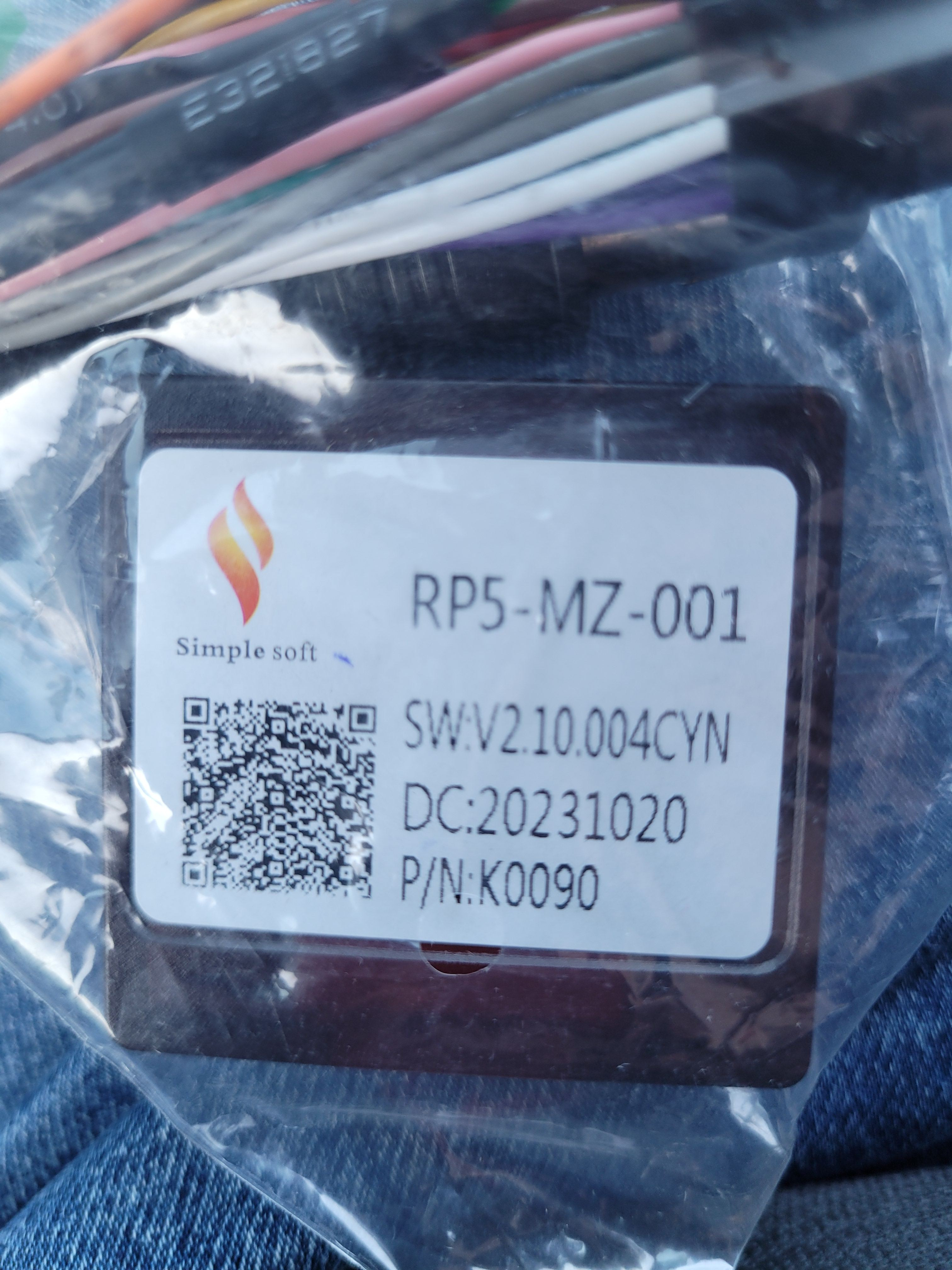

Hello i just bought canbus from simplesoft because Raise canbus doesnt support avg fuel consumption etc. display from my mazda 6 gh from 2008 year. Ive searched in canbus options on my Dudu7 but i saw limited count of options to chose. Main question is: is this canbus fully supported or will be in future? Picture

    Tekkno84 Have you and simplesoft confirmed what vehicle information can be displayed?

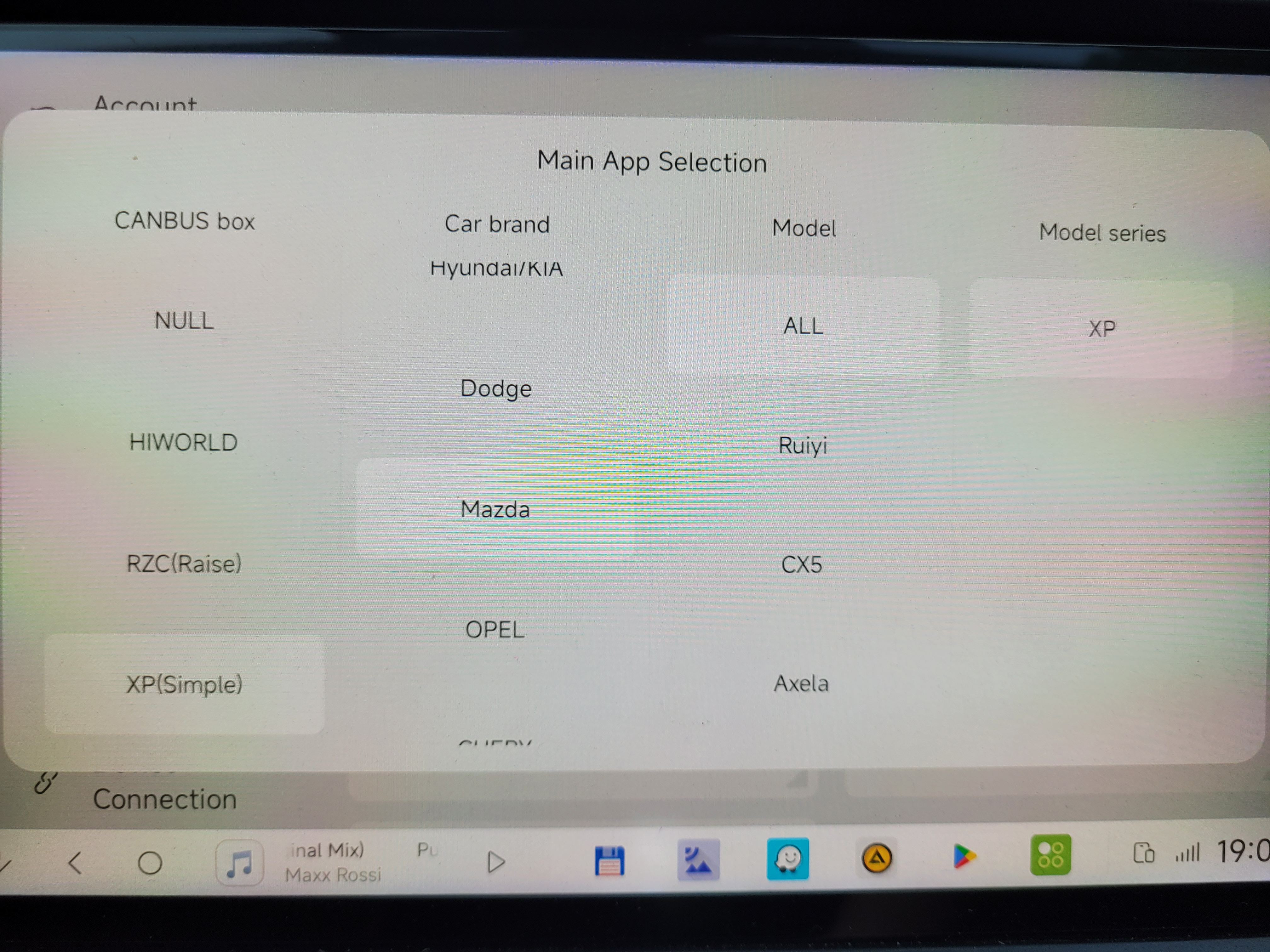

      dudu-lai i didnt switch this canbus for now because i saw in canbus menu limited options on Simplesoft i only want steering wheel control works with full onboard computer support (theres avg. fuel consumption etc. display) i send pictures later
        Tekkno84 Sending photos, as you can see theres no Mazda 6 on the list only all and i dont know if this canbus will work on 100% on manufacturer site it is writen that the onboard computer is supported

        Need to confirm with CANBUS company, DUDU only receives information sent by CANBUS box
          dudu-lai on producer site its writen that this canbus fully support onboard computer, also i have on previous head unit canbus where on steering wheel i could switch computer options

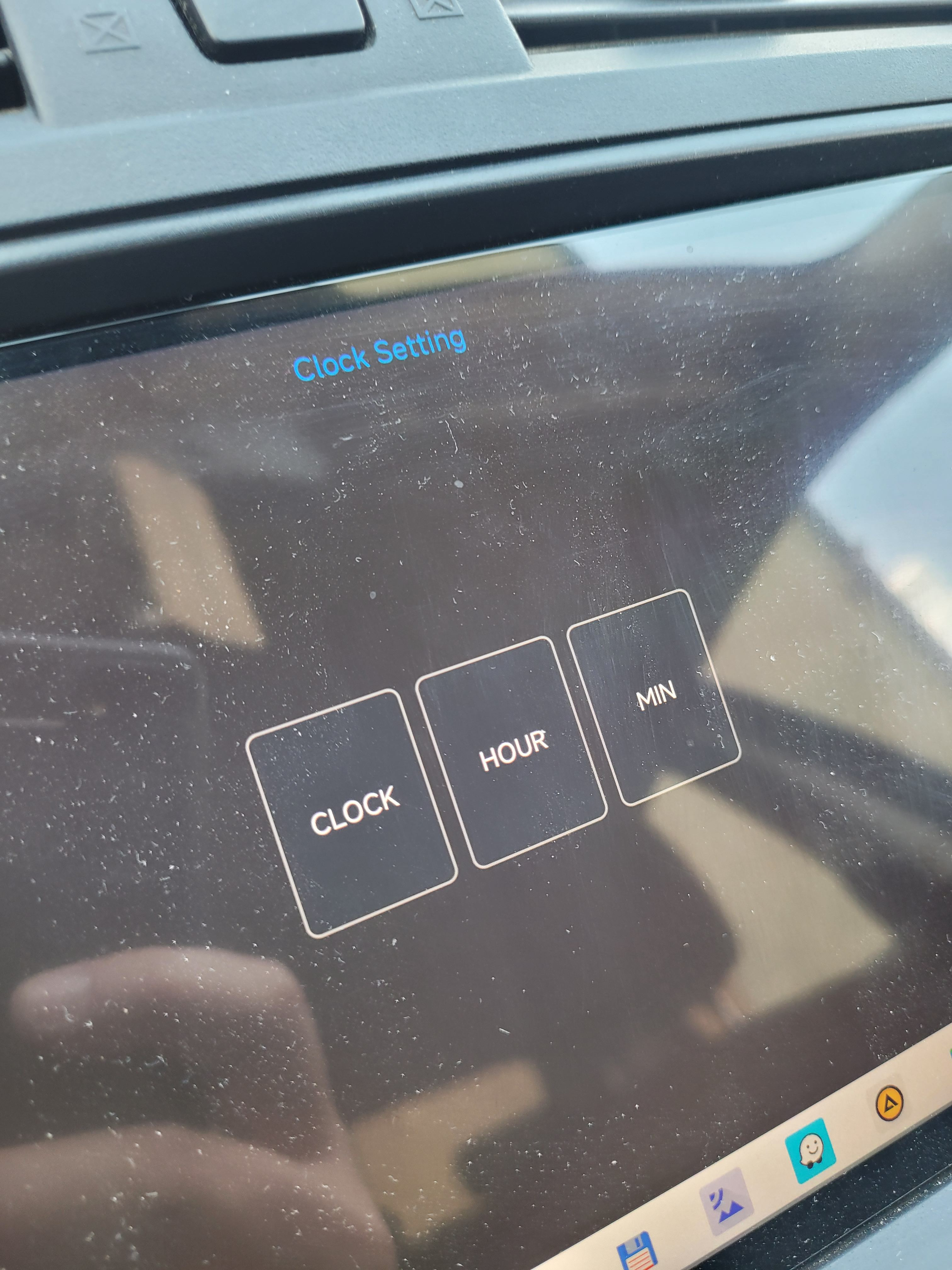

          also how to change clock values here?

          how to change clock values?

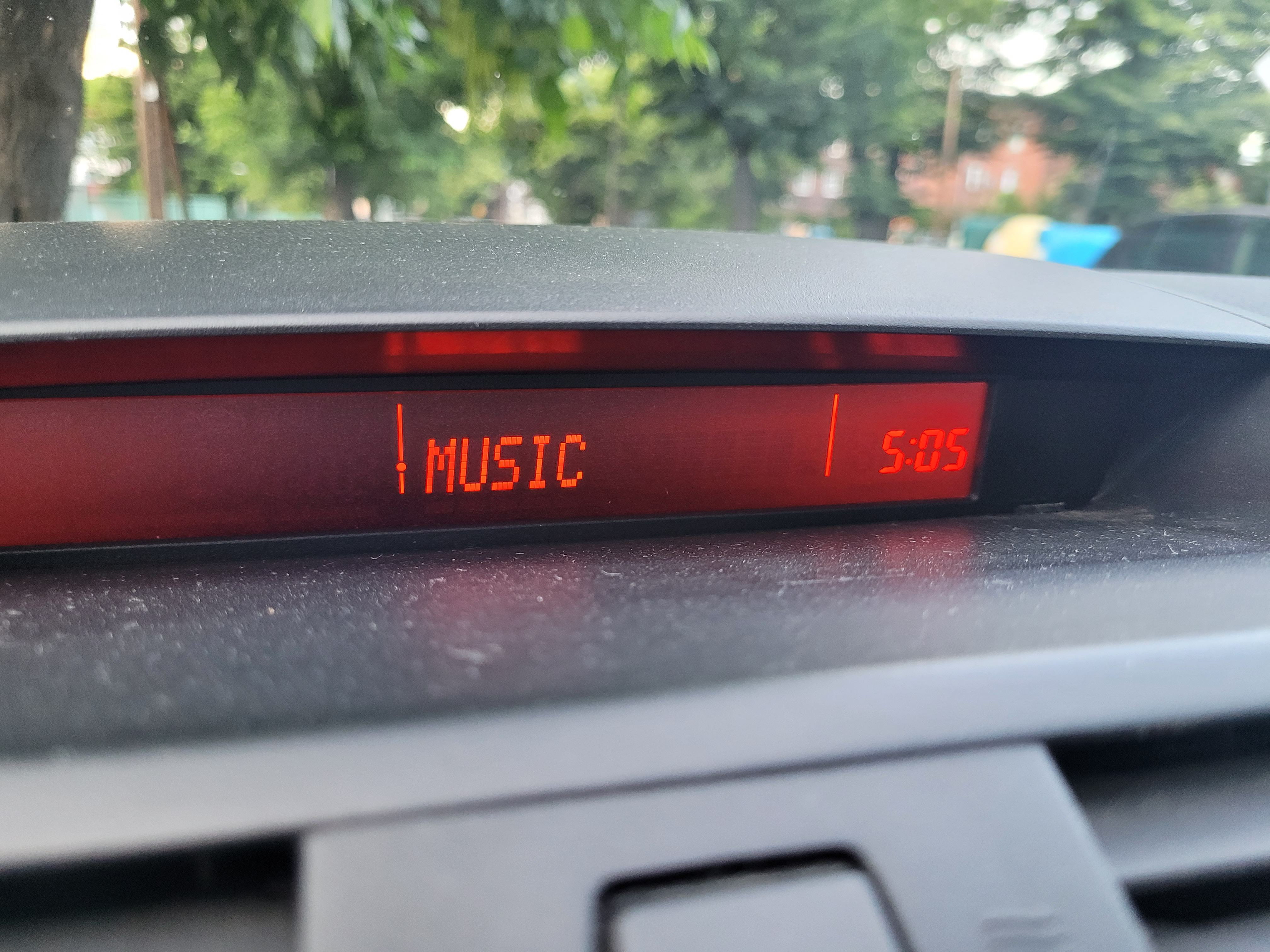

            Tekkno84 Does the OEM screen have this function?
              14 days later
              dudu-lai before duduauto i could change clock values on steering wheel
                Tekkno84 This is equivalent to the function of the original panel buttons. After replacing the Android radio, the panel buttons for adjusting the clock were removed, so the screen control is needed. Or are the original panel buttons not removed?
                  dudu-lai original buttons were not removed they just not working on raise canbus ive got on previous head unit canbus from other manufacturer and everything works well
                    Tekkno84 Use the original panel buttons to adjust the clock. Ignore the clock settings provided by CANBUS to DUDU.
