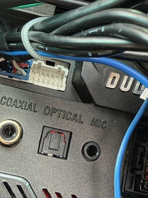

My installer assures me the wires are all connected, tight, and I’ve confirmed it’s seated well in the back of the head unit.

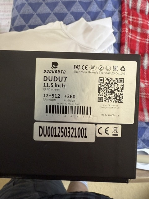

Does your DUDU device have a 360 chip?
Yes, it’s 360 bought direct from Mekede with the cameras. 12/512.

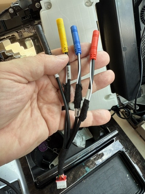

      I have disconnected all four cameras, tried them one by one, disconnected harness from head unit and inserted again, confirmed on my box that I have 360. Nothing will bring up an image on my 360 app.

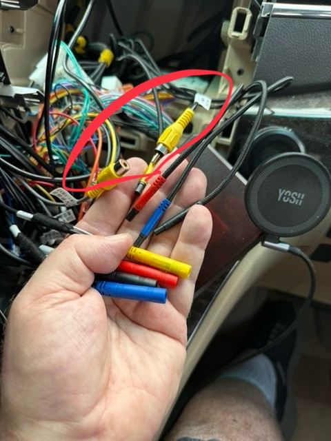

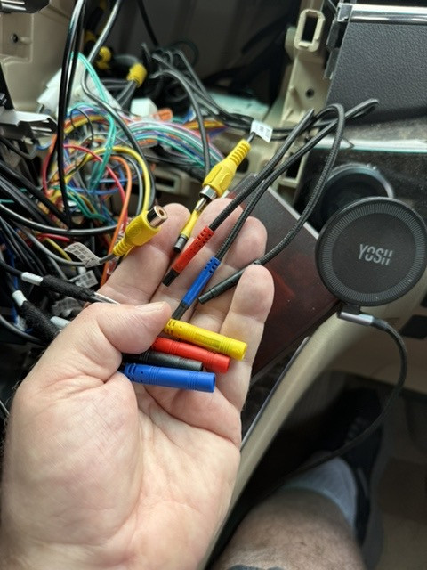

      Do these yellow RCA’s need connecting? It makes no difference if I do or don’t, but just wondered.

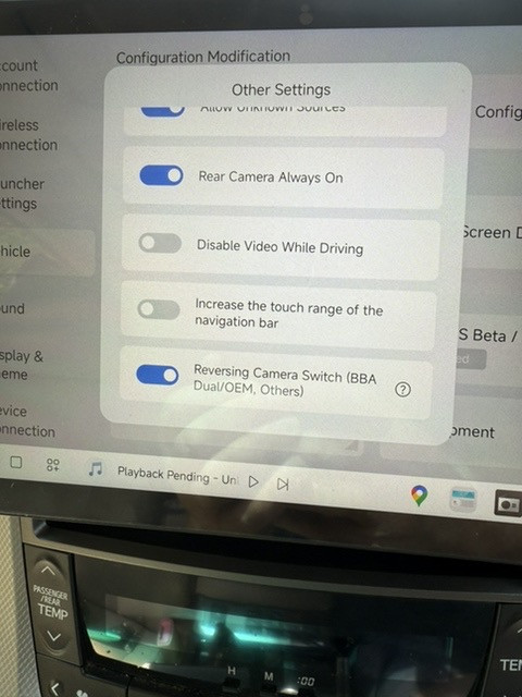

      Ok, nothing makes much sense. Nothing would make it work, then I went to factory settings and toggled reversing camera switch off:
      This gave me left and right cameras working!
      But how to get the front and rear to work now? Note, I have plugged left and right into all the connectors and confirm the connection is ok, just the cameras not working.
