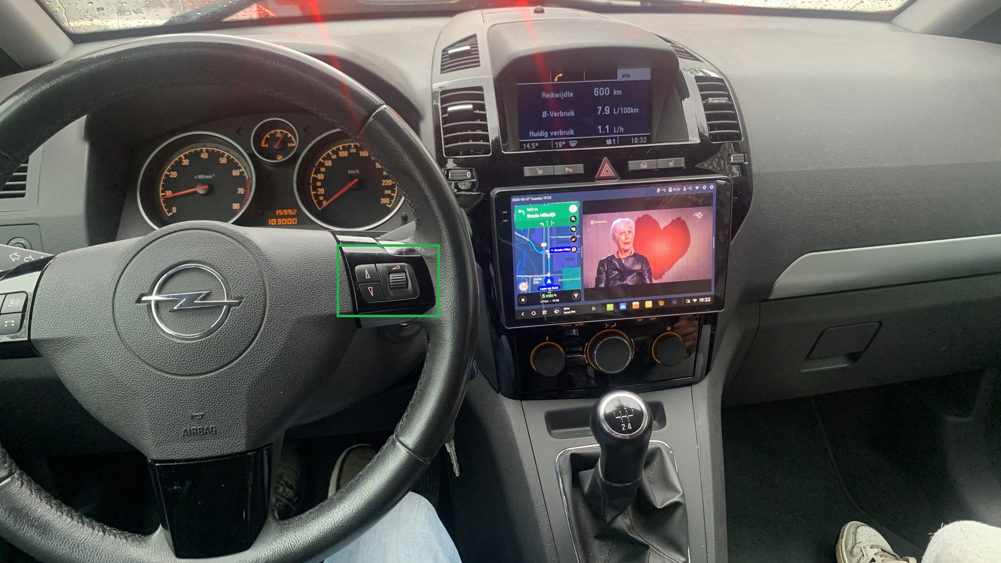

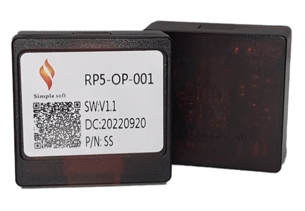

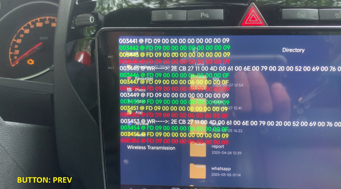

On my car (Opel Zafira B 2007) with CANBUS box (RP5-OP-001) the steering wheel buttons are not recognized. As requested, I recorded the CANBUS messages by printing them on the screen however saving these logs to text is apparently not working on my DUDU7 6+64GB unit with DUDUOS 3.6.
Buttons involved:
  • VOLUME UP
  • VOLUME DOWN
  • NEXT
  • PREVIOUS

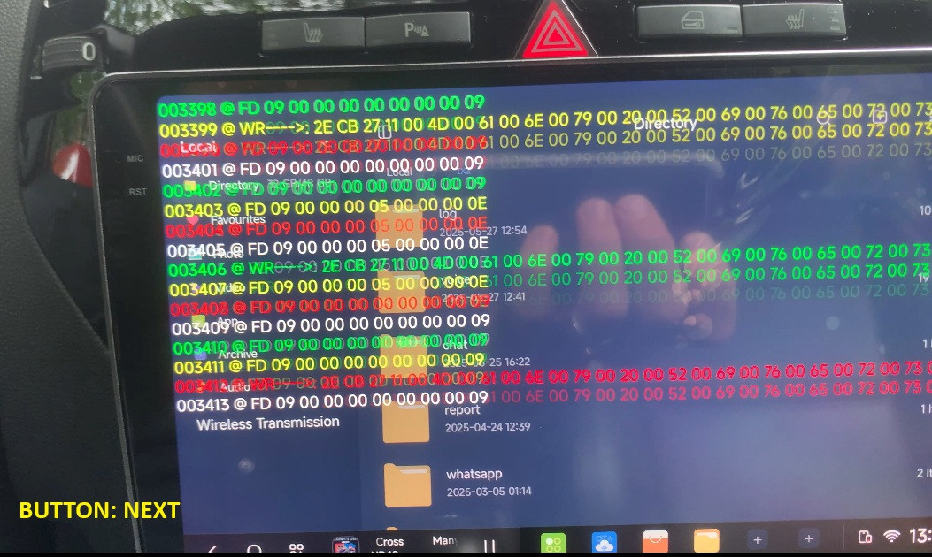

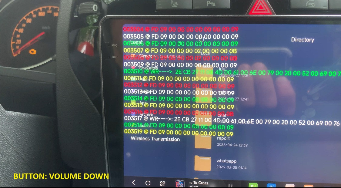

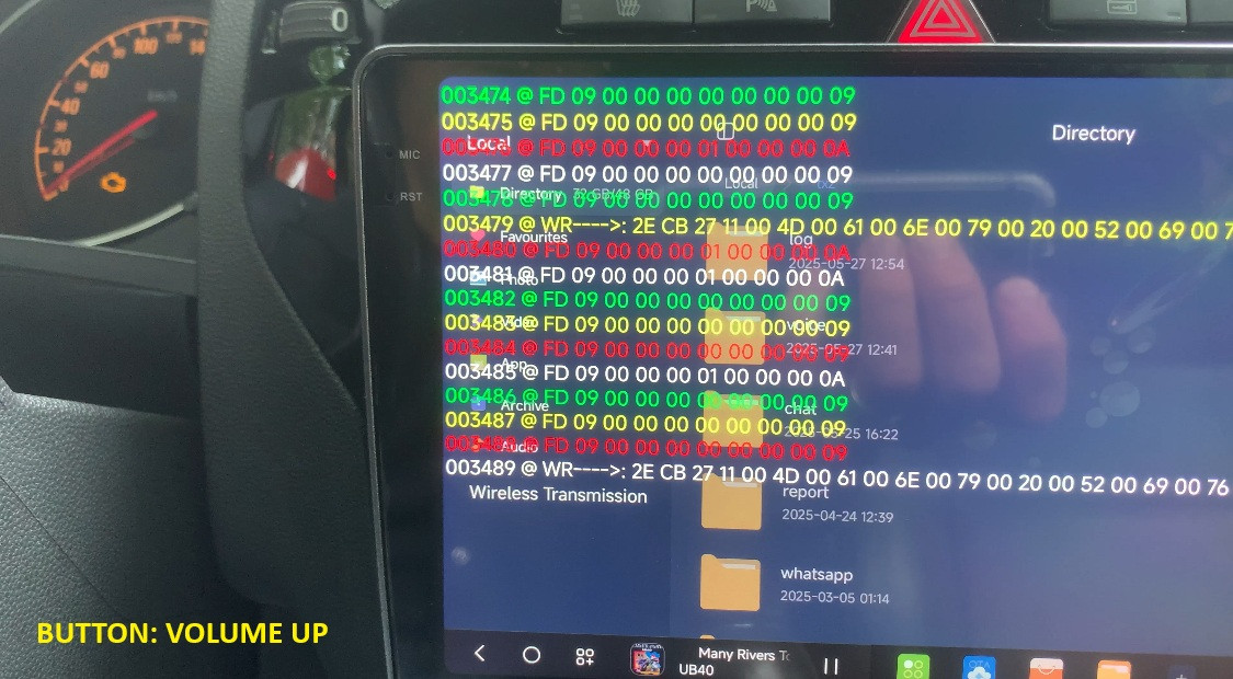

The following frames output was printed when pressing the RIGHT buttons:
NEXT SONG -> 003403 @ FD 09 00 00 00 05 00 00 00 0E
PREV SONG -> 003435 @ FD 09 00 00 00 06 00 00 00 0F
VOLUME UP -> 003445 @ FD 09 00 00 00 01 00 00 00 0A
VOLUME DOWN -> 003455 @ FD 09 00 00 00 02 00 00 00 0B

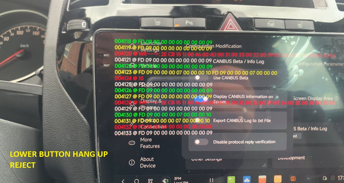

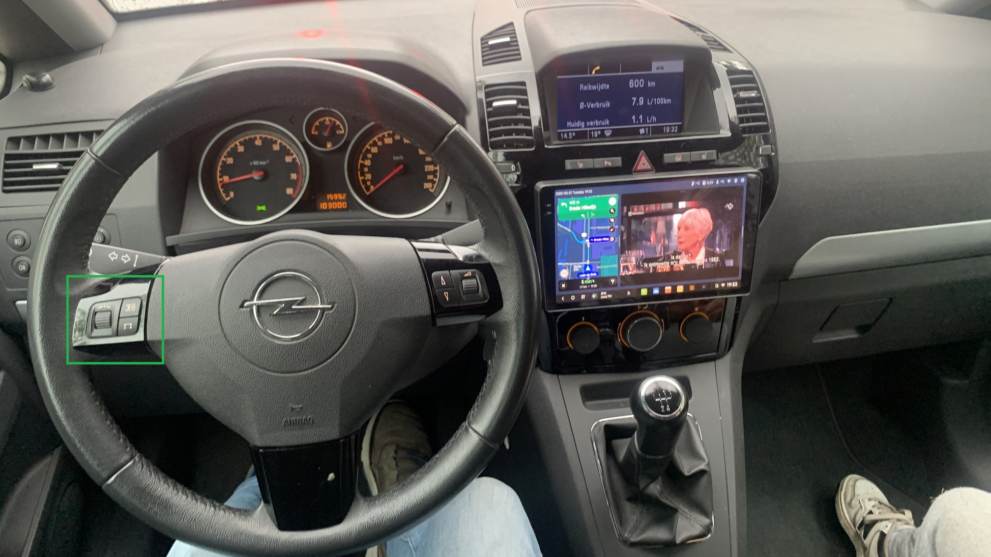

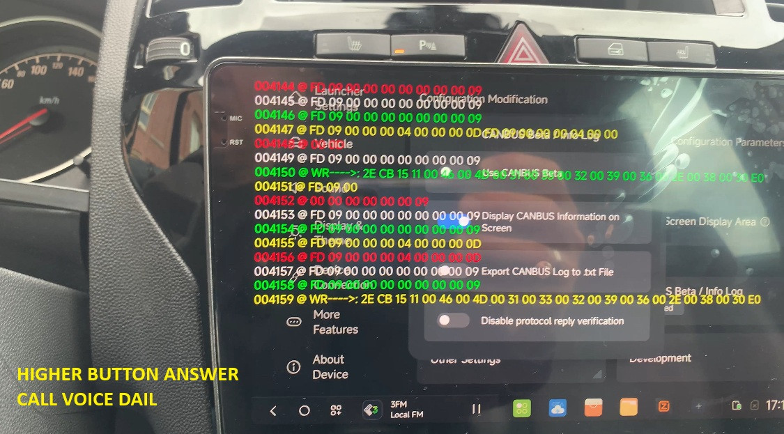

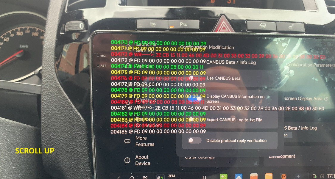

The following frames output was printed when pressing LEFT the buttons:

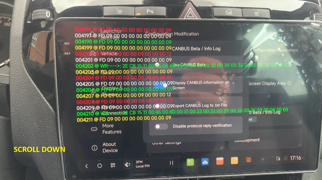

HIGHER BUTTON: ANSWER VOICE DAIL -> 004155 @ FD 09 00 00 00 04 00 00 00 0D
LOWER BUTTON: HANG UP REJECT -> 004130 @ FD 09 00 00 00 07 00 00 00 10
SCROLL UP -> 004174 @ FD 09 00 00 00 08 00 00 00 11
SCROLL DOWN -> 004207 @ FD 09 00 00 00 09 00 00 00 12

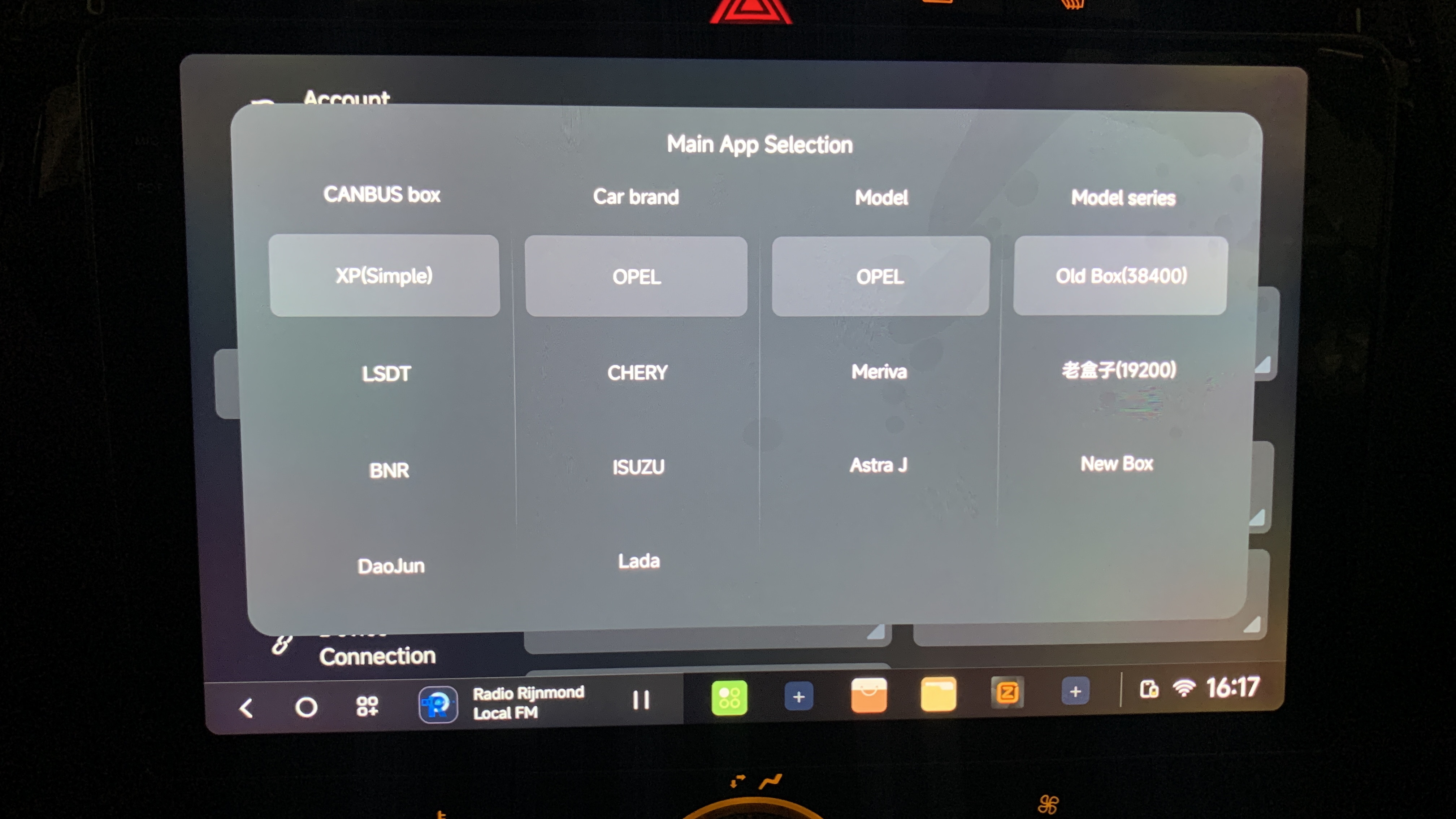

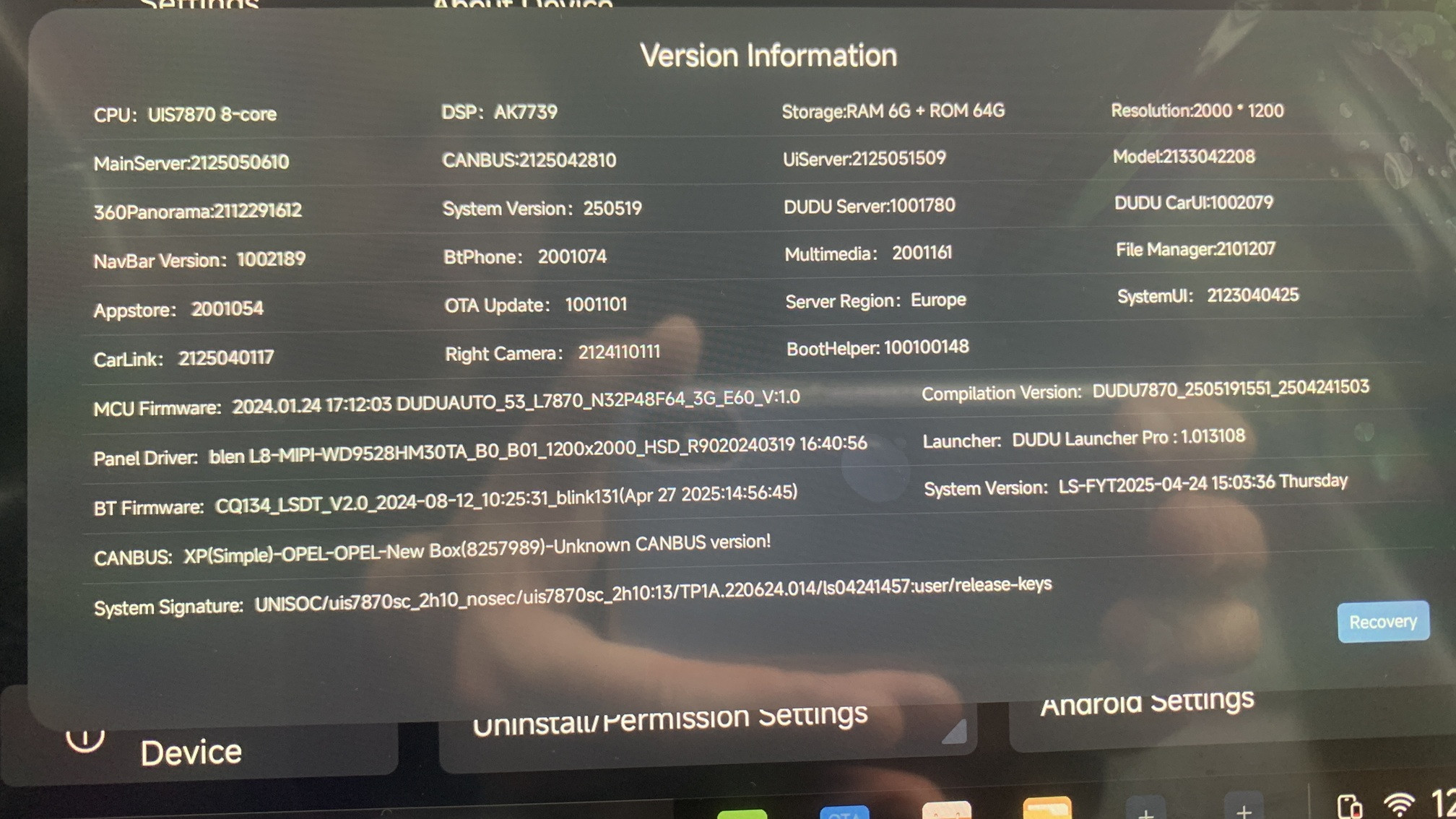

I see "unknown CANBUS version!" in the version information section, I tried all the available options under XP(Simpel)->OPEL-> ...., none of them seem to get the SWC buttons to work.

    robbie_j Do you only have screenshots? Is there a full video?

    OK, good news, I figured since I got the signals it was weird that it was not working so I tried again and with below CANBUS settings I managed to get all the steering wheel buttons working!
