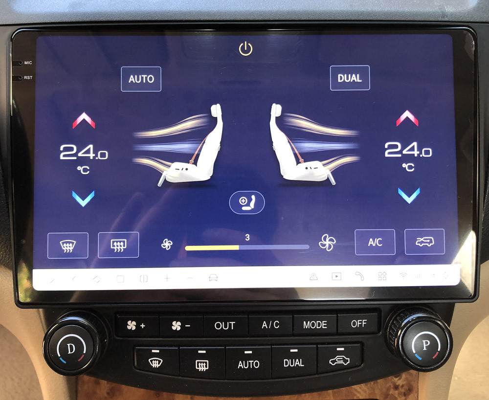

When I go to Vehicle Setting and start the display panel from there I got this screen:
Unlike the previpous one, this one is even touch-aware and looks a lot better.

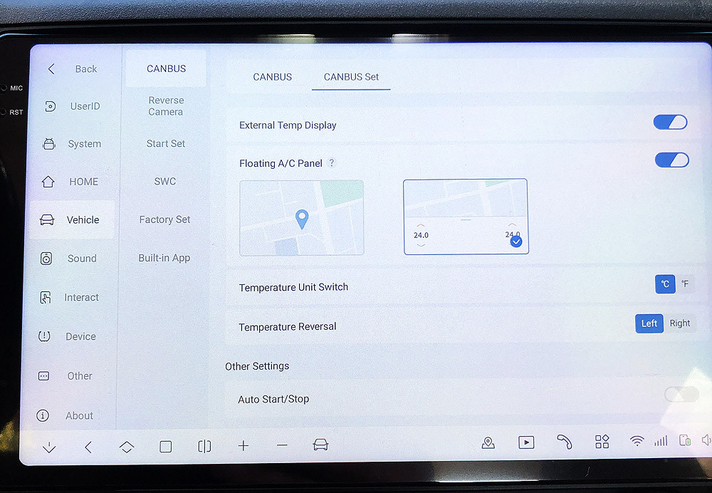

When in DUDU settings I select the first option to try bringing up this nice looking staff when I push a button,
nothing happens, this screen just does not show up.
Here comes my inquiry: Is there a way to change that rather ugly looking stock FYT AC dispaly panel
to the likeable looking DUDU one like this?

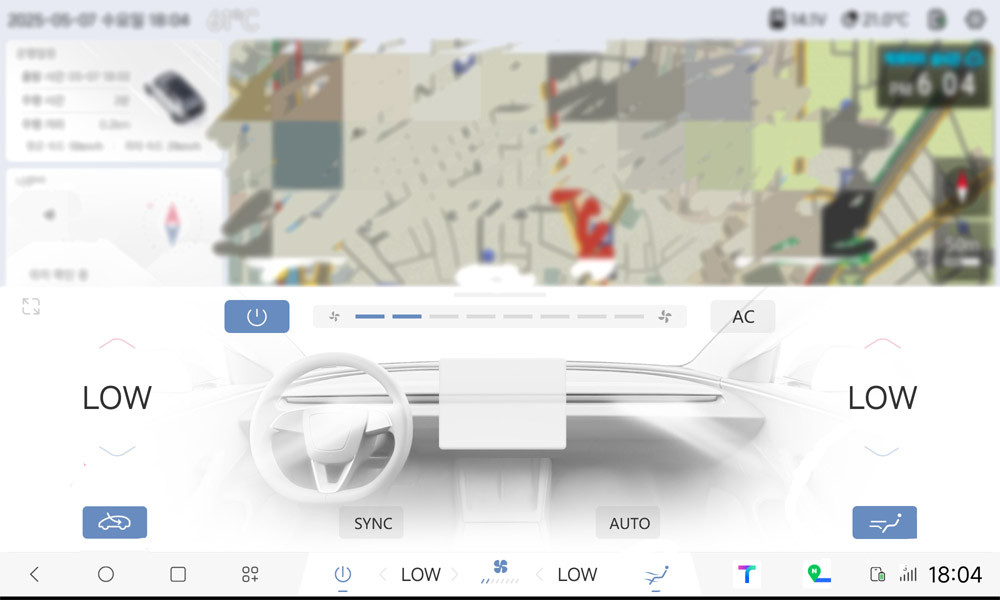

Please upgrade your DUDU7 to the latest system version 250519, you should be able to use the new version of the A/C interface.

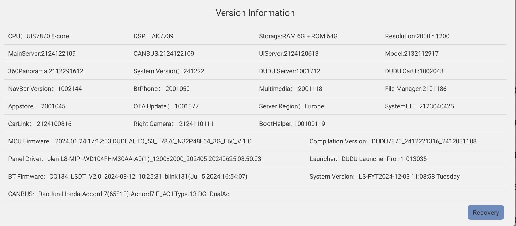

    Please take a picture of the system information screen and upload it here.
    Settings-About-Hold down the top-left corner of the picture.
      DUDU-Meng
      I hope that is what you asked for.
      I did not update yet, but I sure will if you say so after examining the information just provided.
      Waiting for your kind response and thanks again!
        Taker666
        I just saw that you are using daojun canbox.
        The new AC interface is not yet adapted to this canbox.

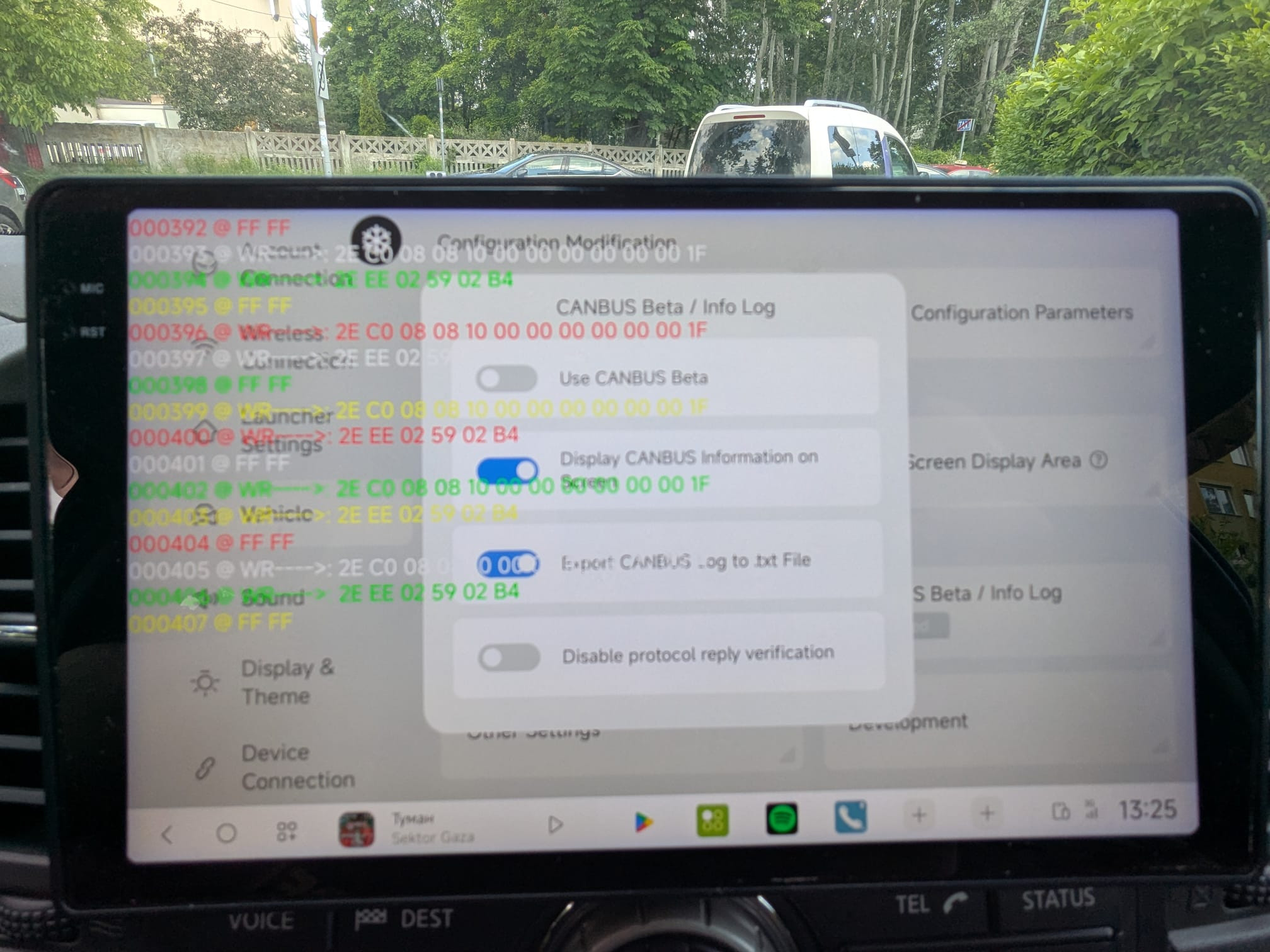

                  Do you have knowledge if canbus messages not recognized/processed by canbox are also sent to headunit? Are they shown in canbus log file?
                    kryzys
                    That's something only the canbox manufacturers know, and each canbox brand handles it differently.
                    If the canbox can not handle we do not know, we can only support to see the command logs sent to the host by the canbox, the factory set to open the protocol log print can see the command sent by the canbox.
                    I've already written in different post that there is something wrong with logging canbus messages. Despite enabling the "Export CANBUS..." option, I cannot find log file. Should it be in canBusALog direcotory or somewhere else?
