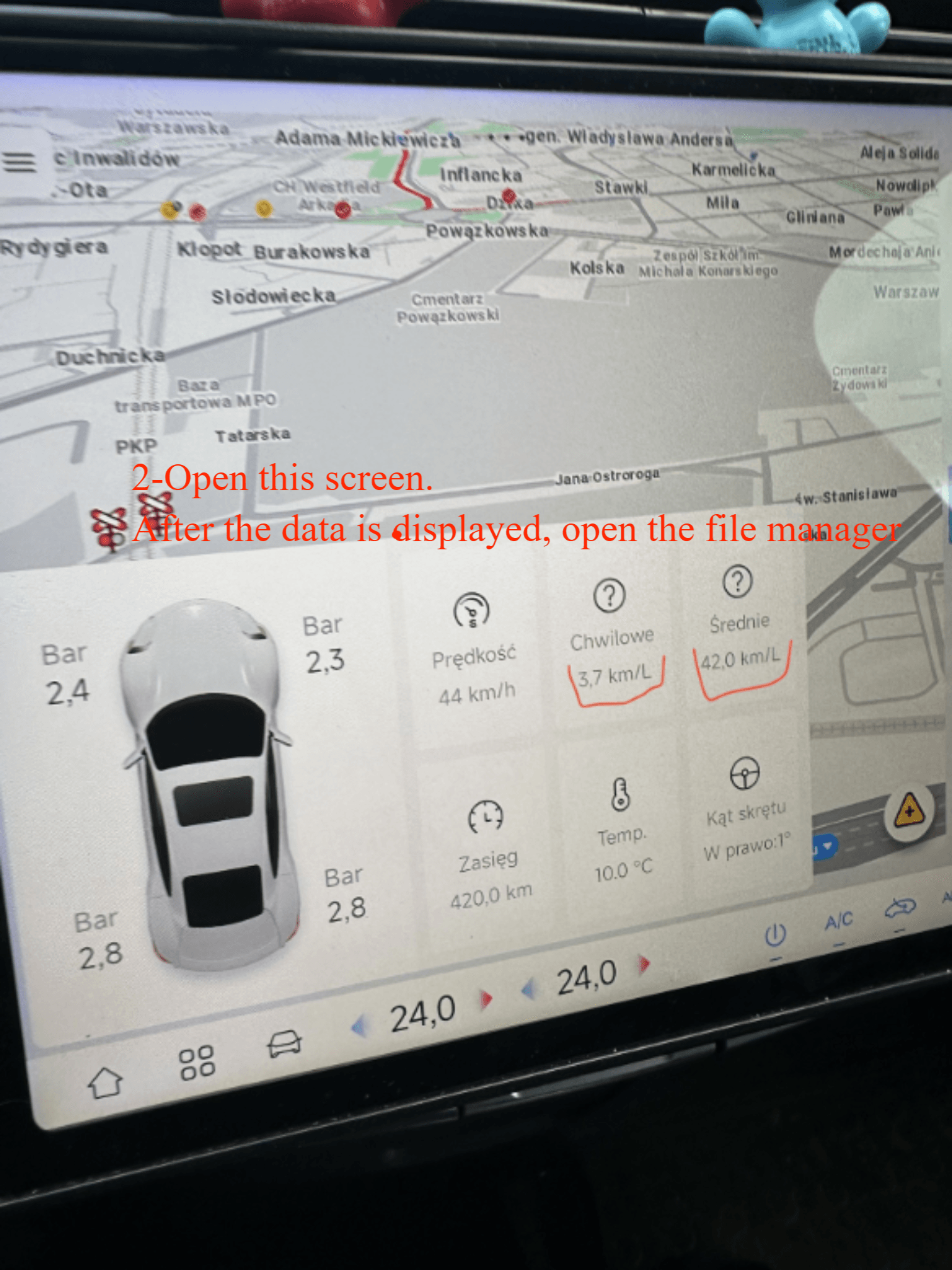

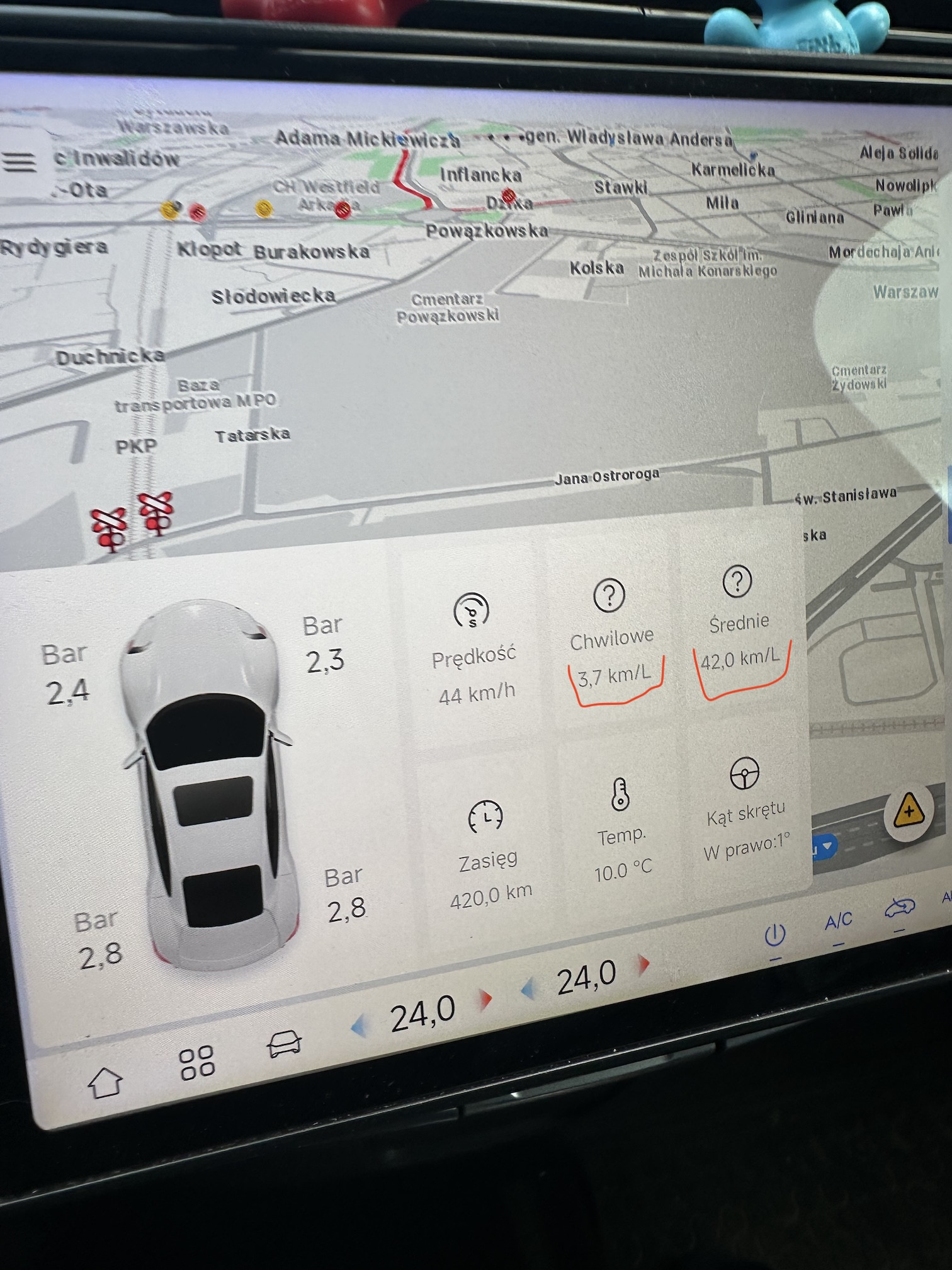

In the “vehicle information” section, the fuel consumption units have changed to km/l, and there is no option to switch to other units.
The correct units, l/100 km, were present in version 3.6 Beta 4. Since Beta 5, only km/l is available.

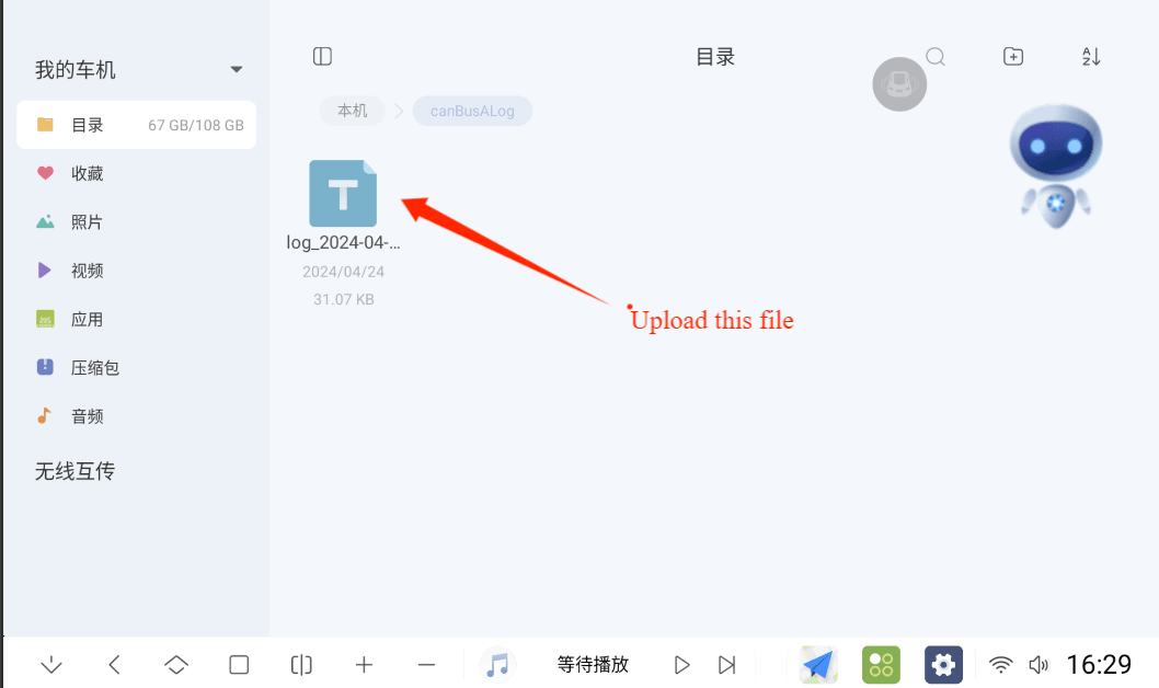

    DUDU-Meng logs attached
    log-2025-05-21-0.zip

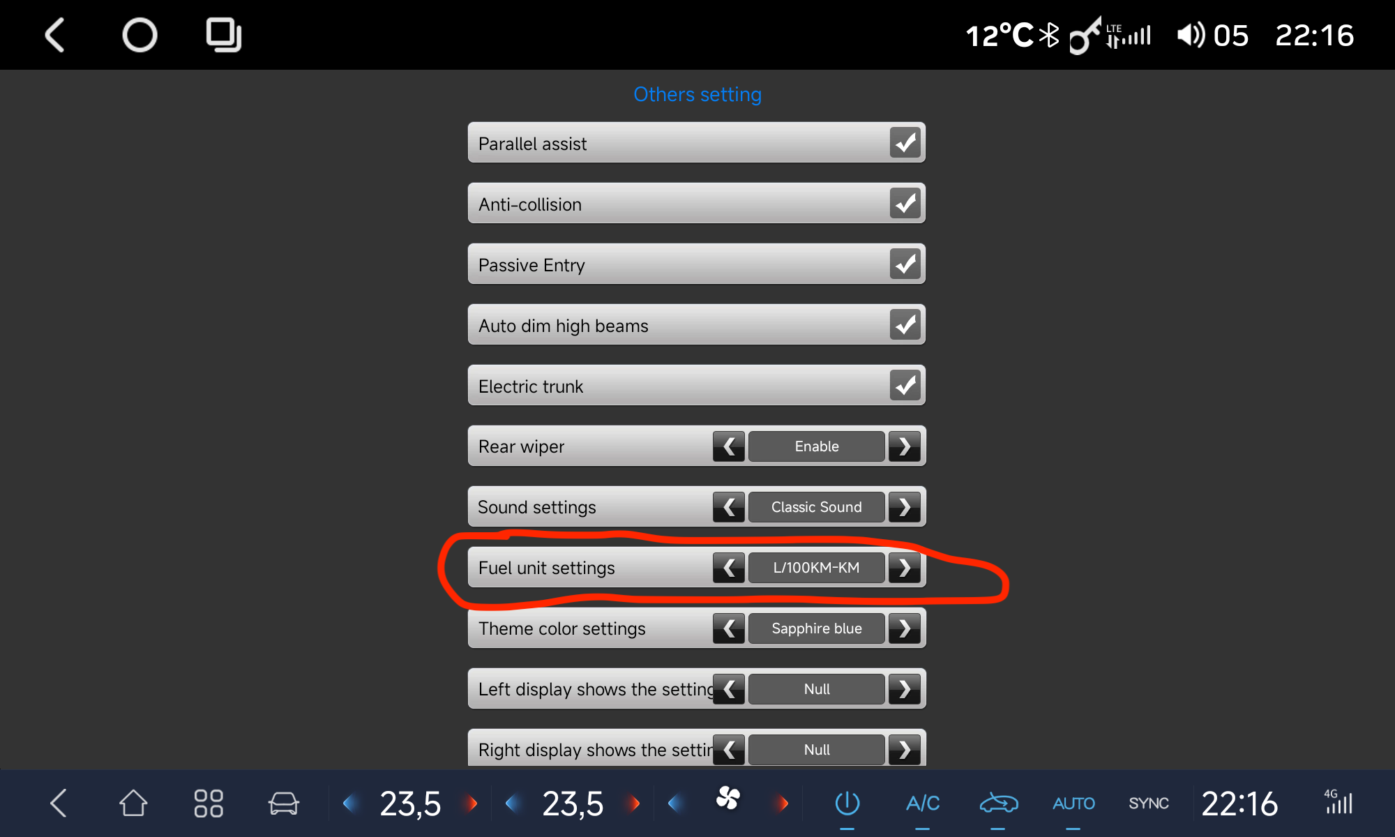

    DUDU-Meng I installed it, but nothing changed , though I think I found the cause and a temporary fix. If “Vehicle Info” is set to “L/100KM-KM”, DUDU shows values in km/l. But if I switch it to “KM/L-KM”, then DUDU correctly shows l/100km.
    Also, when the car is stationary, it shows weird values for instant fuel consumption, like 6557.5 l/h, and the “average consumption” is also strange it’s always around 50 l/100km.

      Please reprint the log, open it up and print it and go run it down the road for a while. Let the data change.
