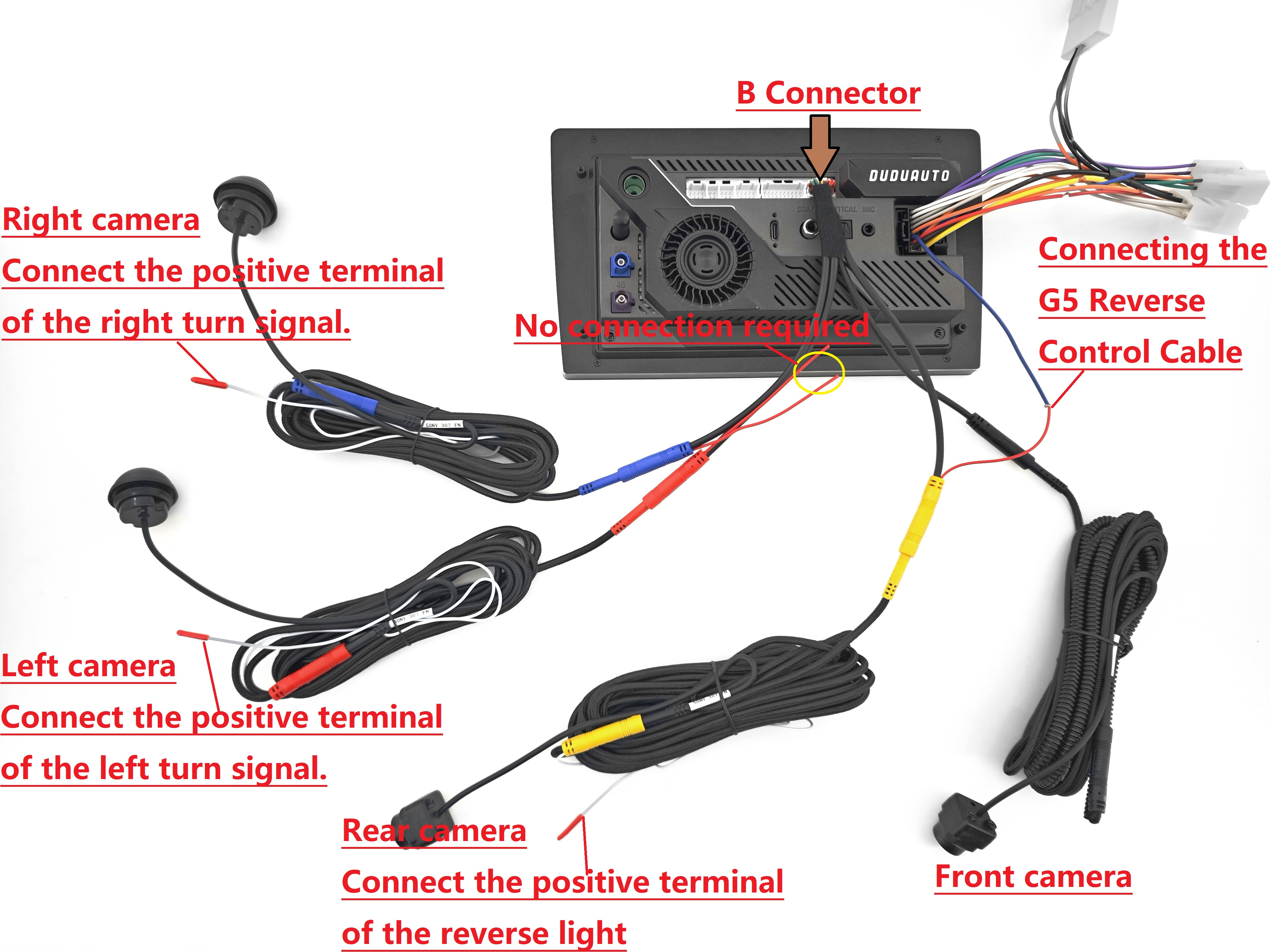

So I've just installed the left side camera on my mirror every thing is connected also the turn signal cable and I changed in the setting to the 360 mode
And the issue is when I turn left the screen show me that he got the signal to left side but it's black screen is it because I connected only one and need all to be connected or some thing I the hardware is not good ?
    BenAriel All four cameras need to be connected
      dudu-lai Hey thanks for the replay one more question I pluged the cable from the camera to the turn signal but do i also need to plug the white cable that coming with the cable that is connected to the screen if yes what I need to connect it to ?
        BenAriel Look at this chart.

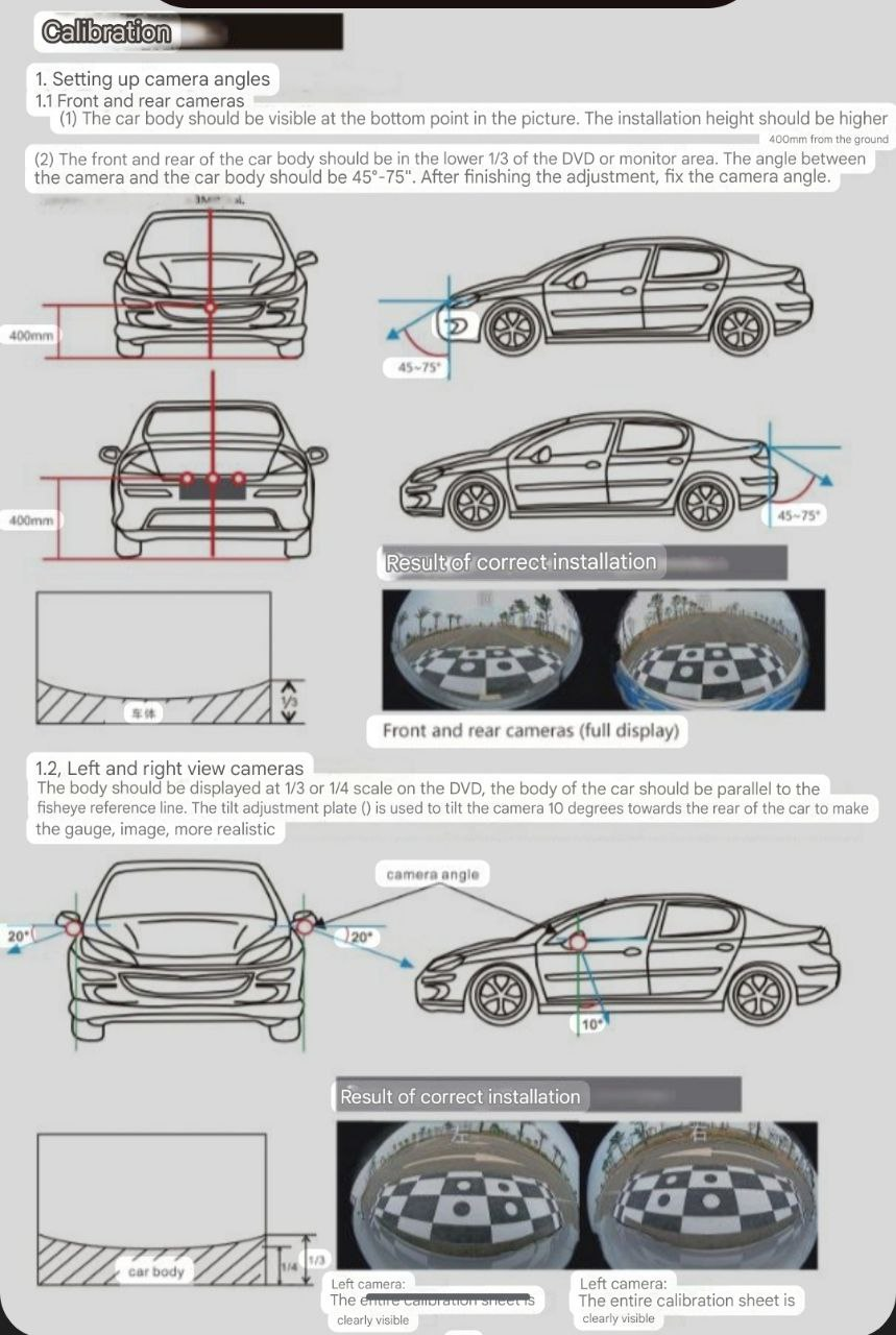

              dudu-lai hey I am now calibrating the cameras and wanted to ask where the cameras on mirror should point should I turn them to the side or the back ?
              please refer to
