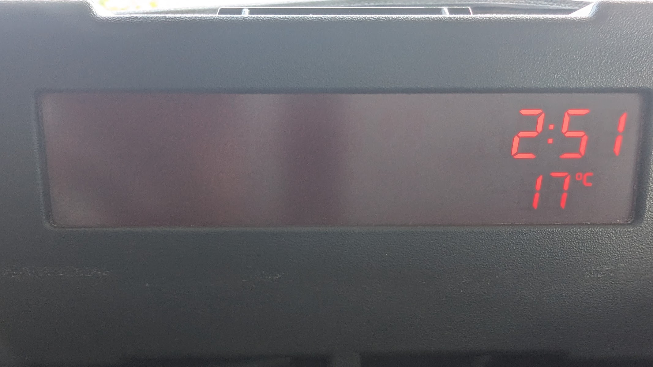

    Hi, here is the OEM screen (which must stay connected for SWC to work)
    Temperature is indeed visible on the OEM, but not on the DUDU
    Doors and speed are displayed on the dashboard, might these data are available in the CAN bus 🤔

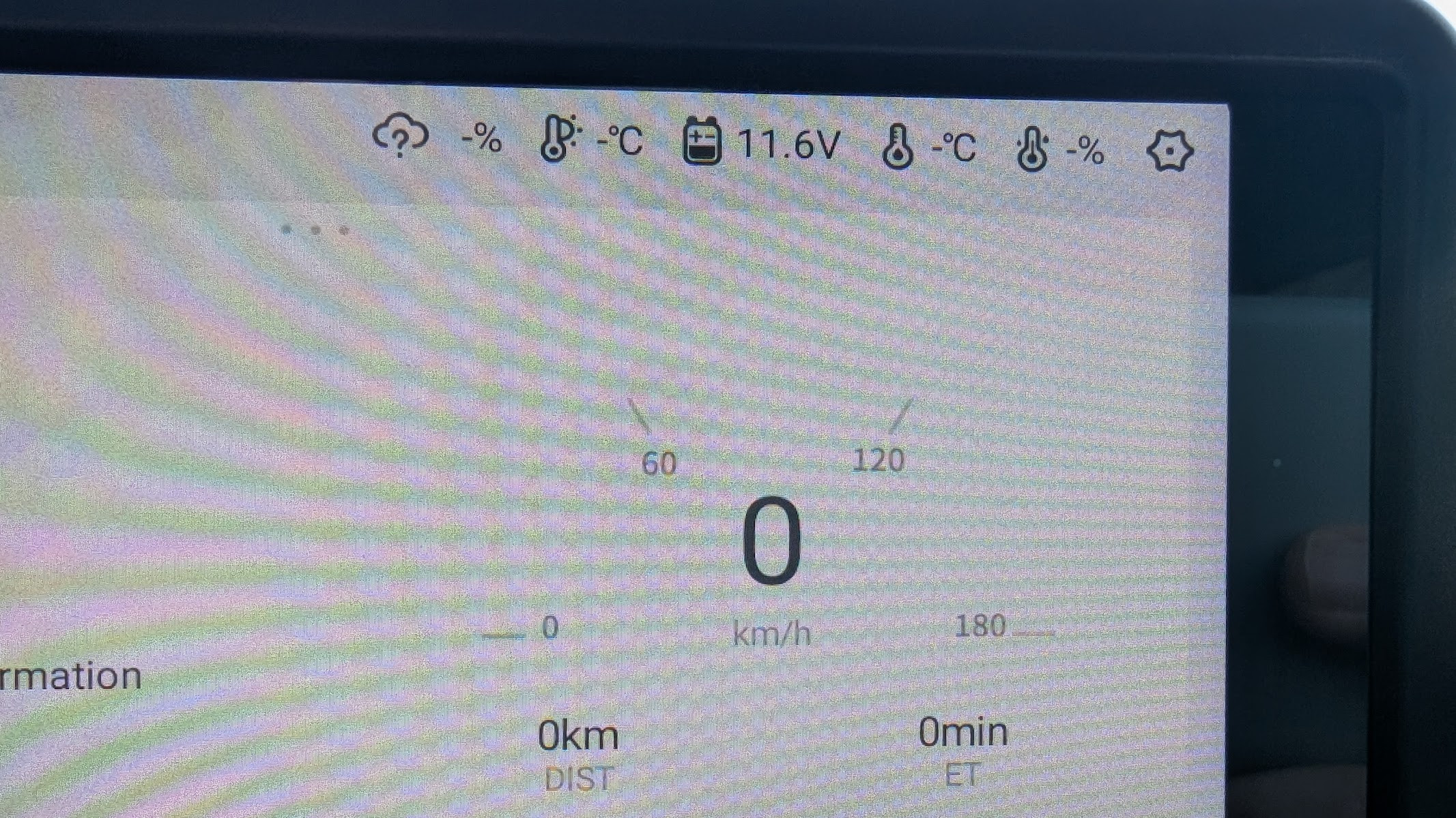

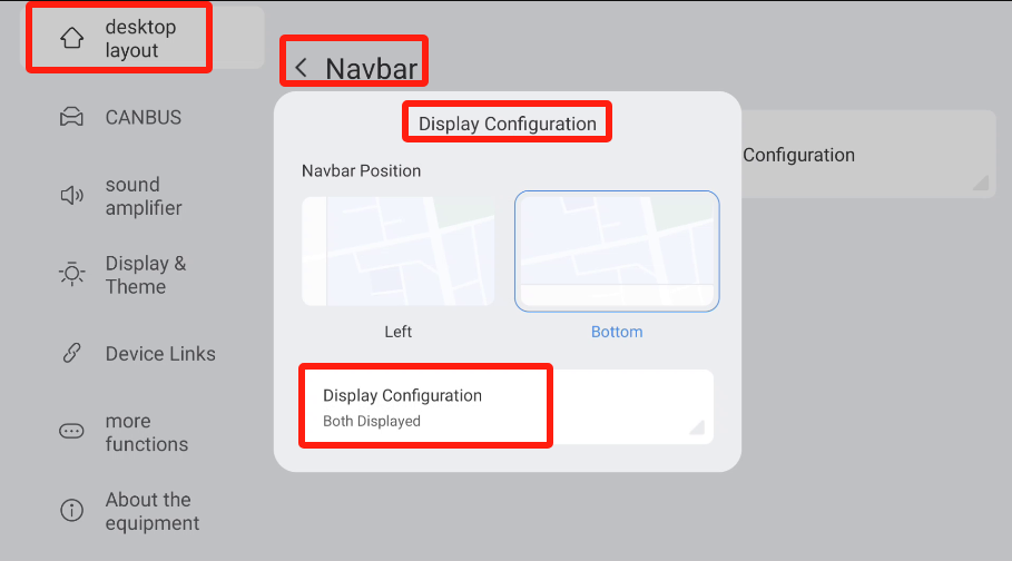

      Matthieu614 Not this status bar, I mean the Android status bar showing the external temperature. Do you have the android status bar turned on?
      Hi,
      As you can see temp is not displayed either on the Android navbar

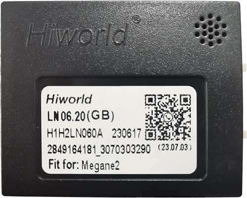

        Matthieu614 With the OEM screen retained, the CANBUS box does not acquire the external temperature, which is viewed in the OEM screen
        Ok, but when I disconnect the OEM screen SWC won't work anymore and still no temp displayed.
        Also, for my understanding, does the CAN bus box allow Dudu to read whatever he want or it only exposes a certain list of data to the host and can't be extended ?
          Matthieu614 The OEM screen is retained and the CANBUS Box does not obtain external temperature data over the CAN bus.
          The DUDU can only access the data built into the CANBUS Box, not whatever the DUDU wants, the CANBUS Box will provide.
          Ok thanks for the clarification ! Do you know then what exactly for this specific canbus box what is provided to the host ? Also, can the missing data be obtained from an OBD dongle ?
            Matthieu614 The CANBUS bus box does not disclose its information.
