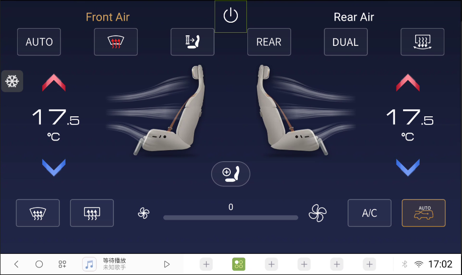

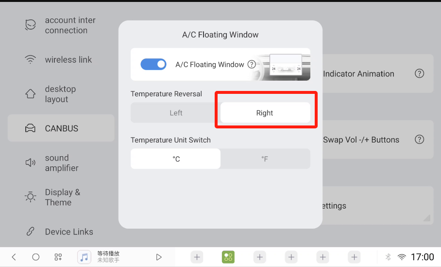

    In App Market - Download Touch Screen Assistant to control air conditioner and set “Temperature Left/Right Switching” to “Right” in Settings, does it take effect?

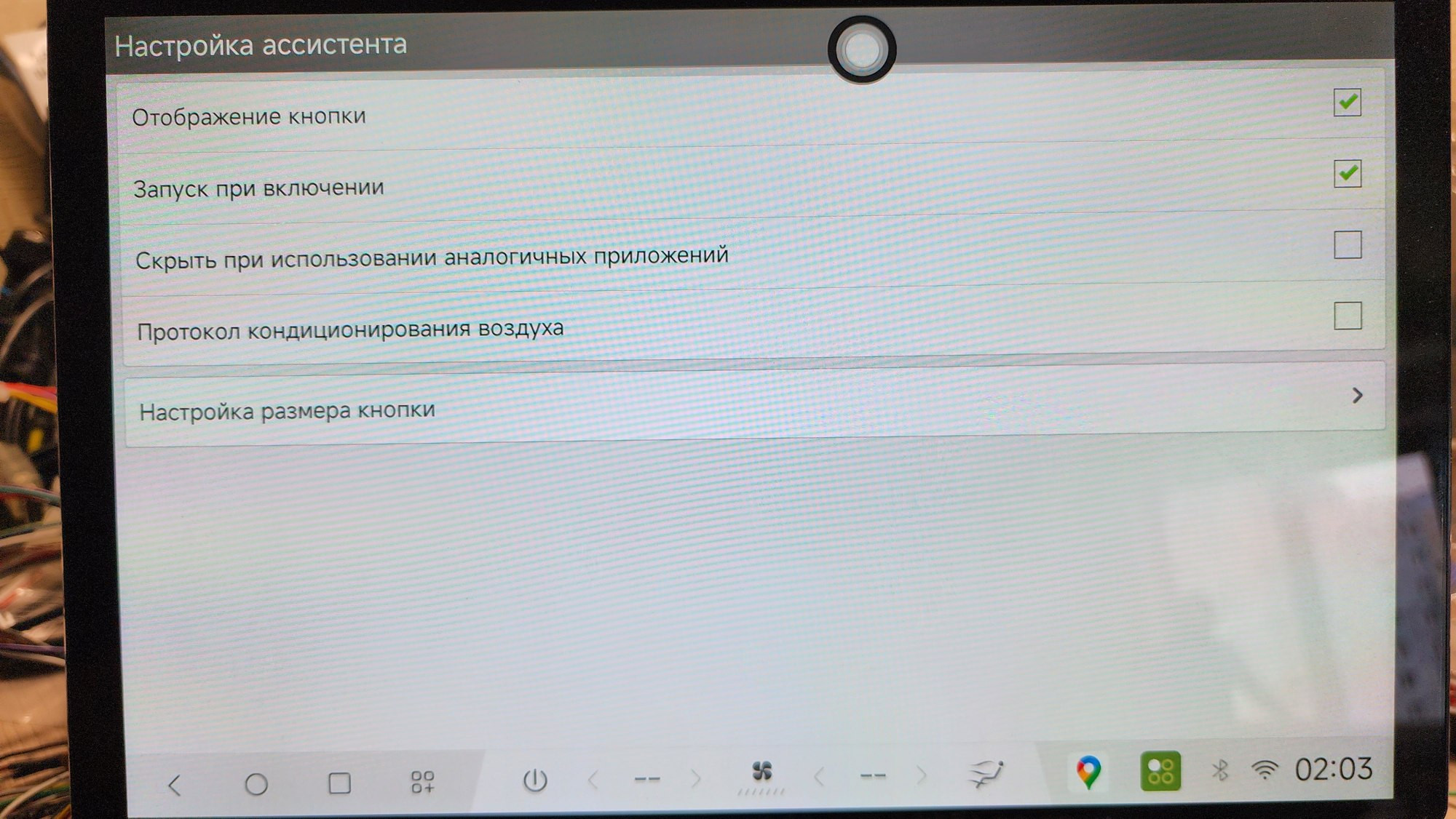

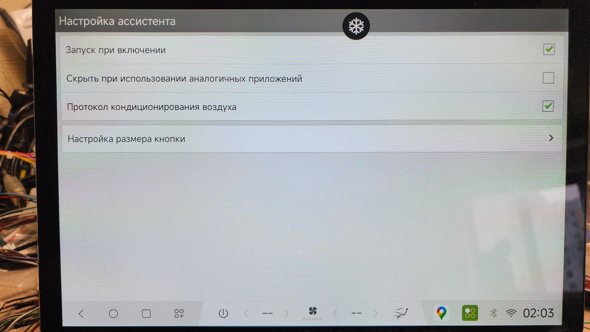

      dudu-lai If you're referring to this Touch Assistant, it doesn't have that setting.
        KravtLab I would like to confirm that in the original AC UI (Touchscreen Assistant), the temperature inversion function works when selected to the right!
          dudu-lai DUDU os 3.6 Beta 5.

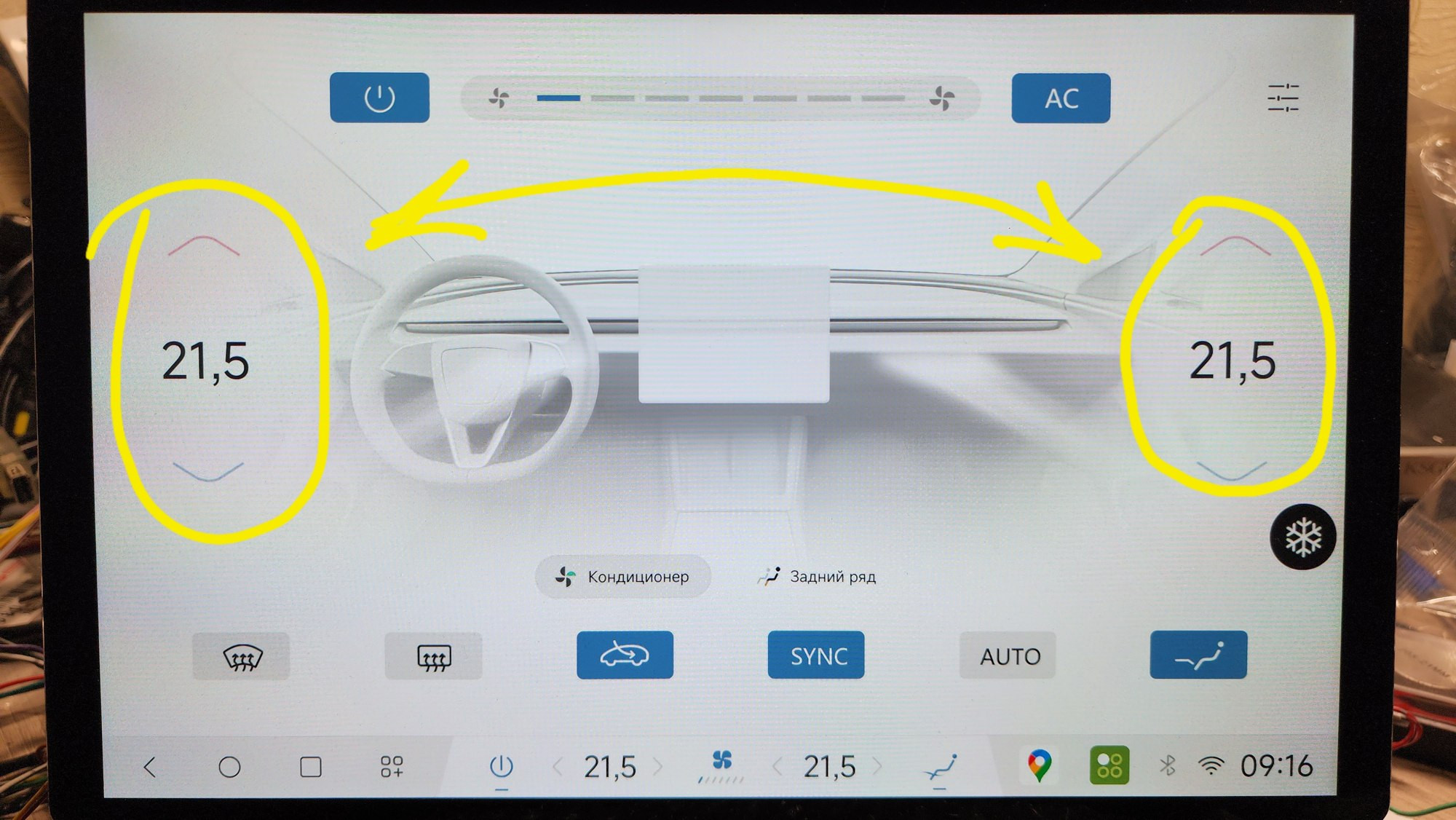

          This temperature change setting is available on CANBUS profiles other than DUDU and RAISE. And this change only works on the original Climate control. On the DUDU and navbar climate controls, the temperatures and buttons do not change.

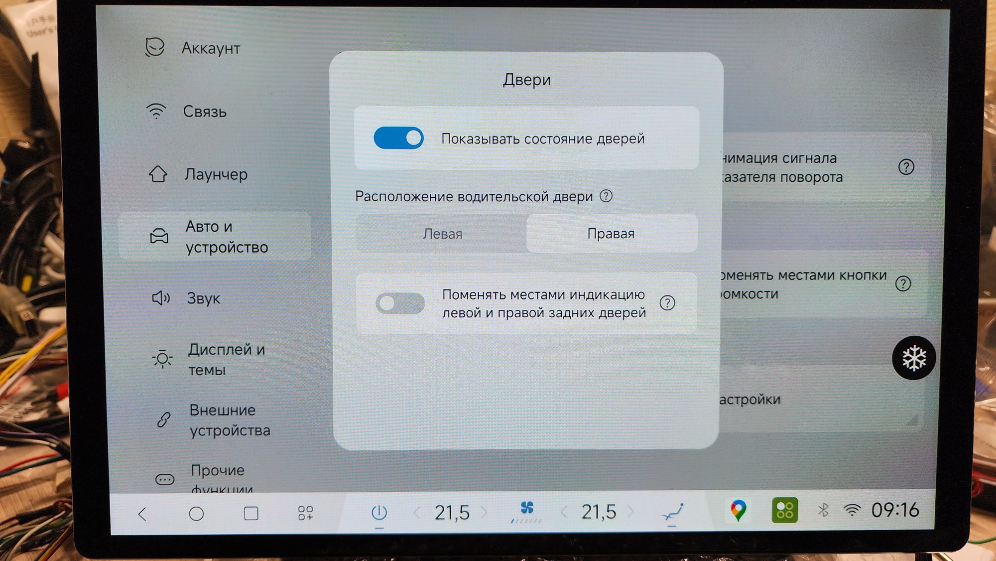

          There is such a setting of the steering wheel (Левая or Правая). But it doesn't change anything.
