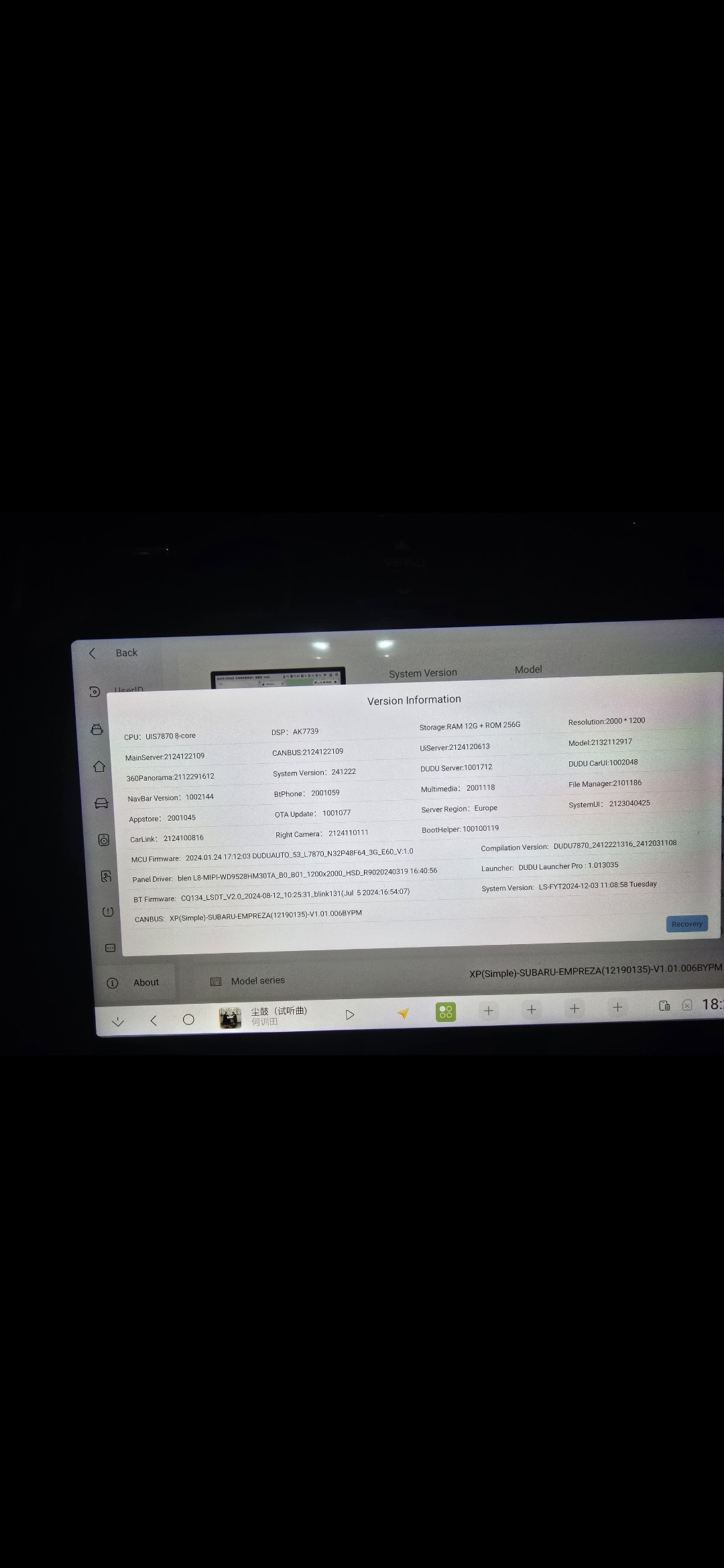

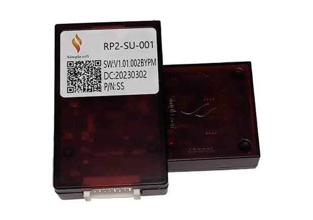

Hi all, recently purchased the dudu7 256gb 12gb RAM model for my 2018 Subaru Levorg. When I purchased rhe headunit, Mekede sent me a simplesoft CANBUS along with the relevant cables.
After setting everything up and installing, I ran into issues with the steering wheel controls. They are all mixed up and after speaking with Mekede, they advised to try different models and restarting after each model selection without any luck.
Is anyone else having issues with the CANBUS for Subaru's? Would appreciate any help or suggestions. I've attached images of the headunit about page and the canbus selection screen.

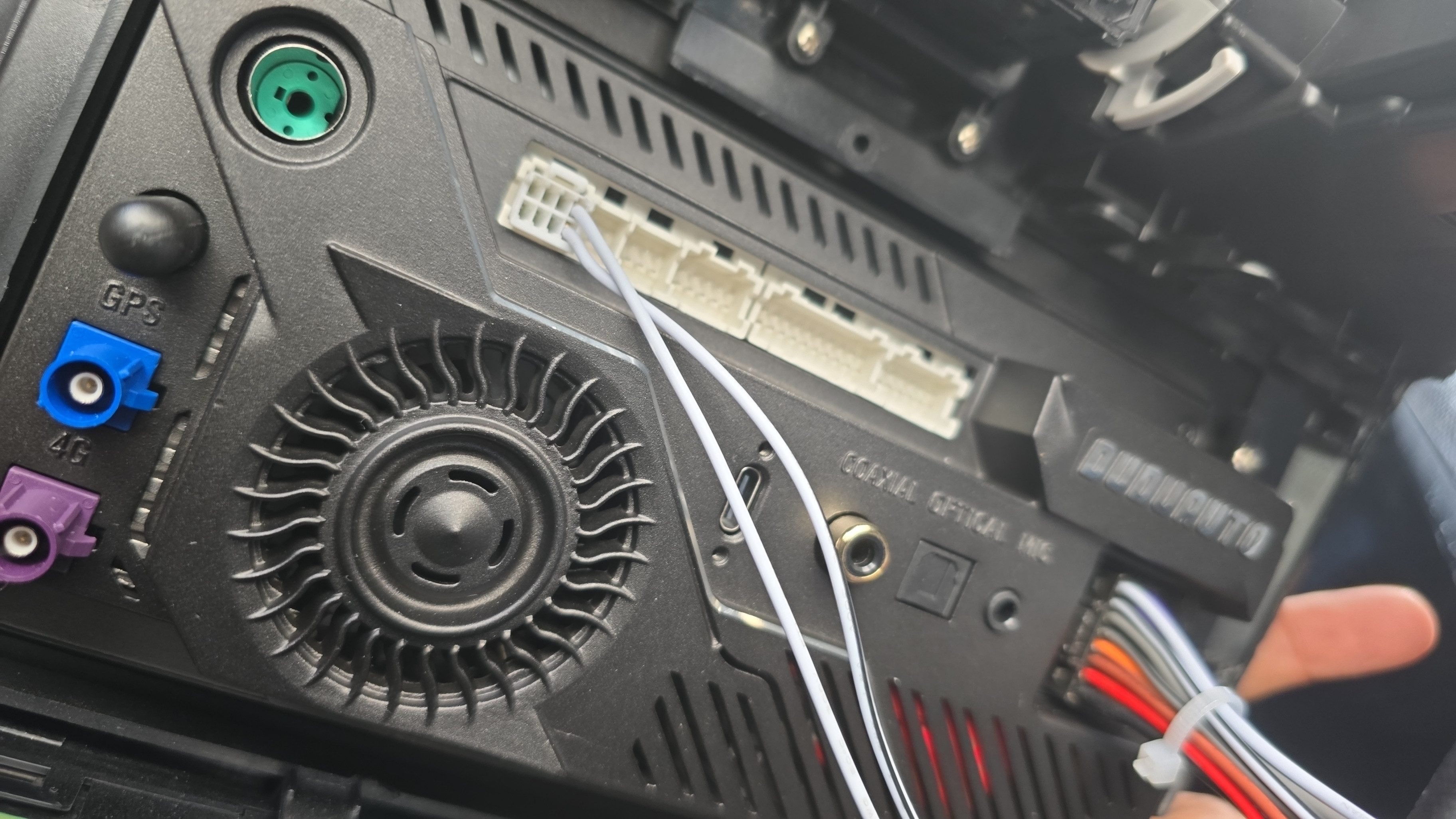

      isameking12 How are the cables connected? Is there a photo of it?
        dudu-lai
        All cables connected correctly, please see the photos. Mekedes sent the latest firmware for the canbus and after updating it still is not working.

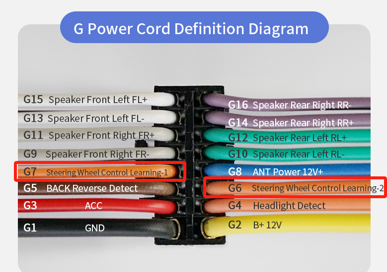

          isameking12
          Does the factory have a 20P connector? If so, then these three pins in my picture relate to the SWC
            dudu-lai
            Do you mean the factory cable from my car or the cable that came with the headunit and canbus?
              isameking12 OEM Host Cable
