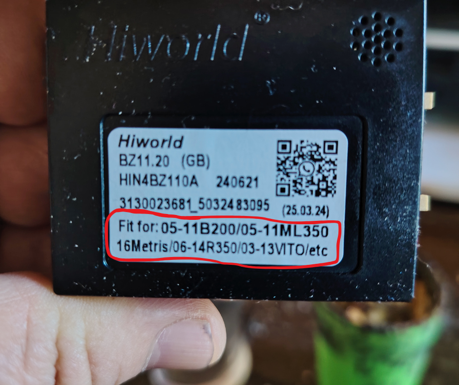

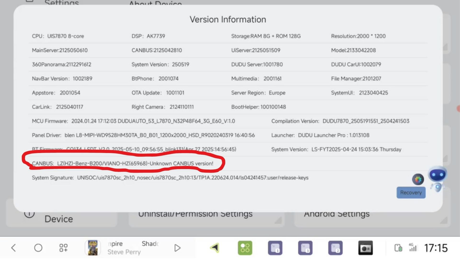

Anyway I have done some testing today using the Hiworld one. So coming from it set at Hiworld>Benz>old>compatible where I had steering controls plus door opening graphics, but occasiononal incedences of ignition not accepting fob first time.
Test 1....set to Hiworld>Benz>B200>Hiword(only available option)....did 6 stops and on all 6 cental locking intermittent not working....fob in ignition took multiple attempts to accept on all 6 stop/starts...steering control working, no door open notification.
Test 2 set to NULL>No Protocol....6 stops, central locking ok on all 6, only 1 out of 6 times the key fob was not accepted first time but was on second attempt....but obviously no steering control, no door open notification.
I will attempt to find the old Canbus box from my old TS18(Eonon) unit, it worked perfectly on the Eonon for 2.5 years but the box and harness were from an even older Brogotek (Xonrich) MK8667 unit. It must have fallen under a seat as its a big job stripping the entire centre console to remove head units, so it could be anywhere. I am pretty sure it was this type of box I have no idea what make
