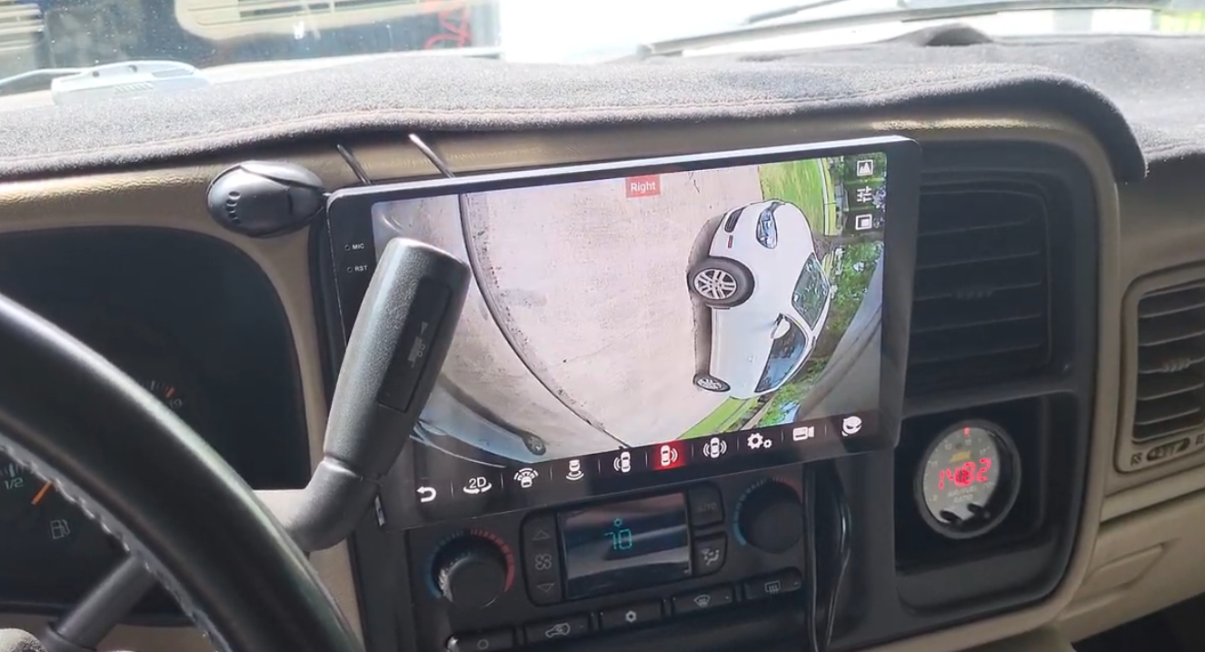

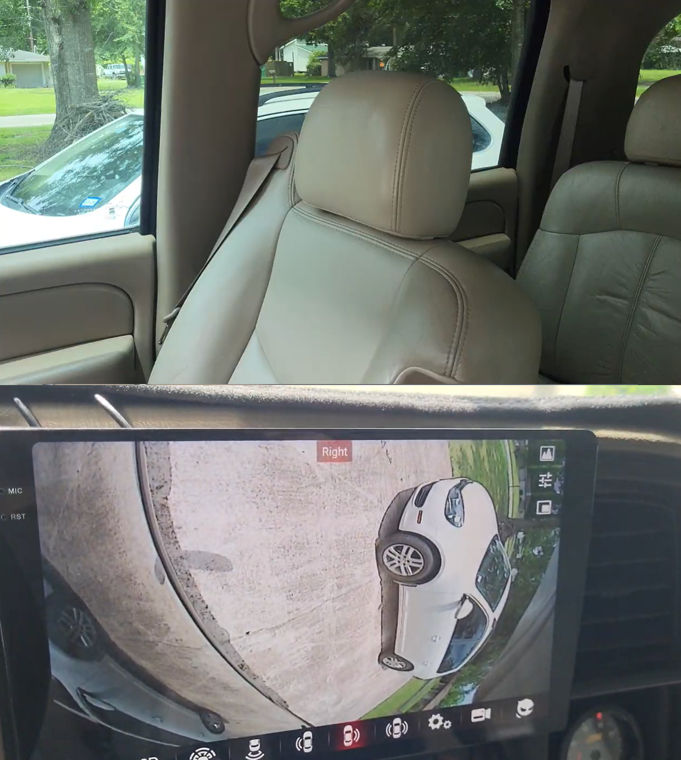

I've fully installed my 12G-256 Dudu7 and 360 system. It's all wired up and all cameras are functional. I managed to turn the default left and right camera capture direction towards my rear blind spots. Is there a way to rotate the image so it's upright? It's quite disorienting to use. The left side also has the same issue, just mirrored.
    MultiVAC When you turn on the turn signal and switch to the 360 ​​interface, the left/right default setting is to look at the front of the car. DUDU does not have the function of looking at the rear of the car.
      dudu-lai Yeah it started facing the front and I was able to use the Move X/Y in '2D orig' to get them to point to the rear blind spots. I guess maybe that would be a feature request, where if there was an image rotation option in that mode, that would get me the rest of the way there.
