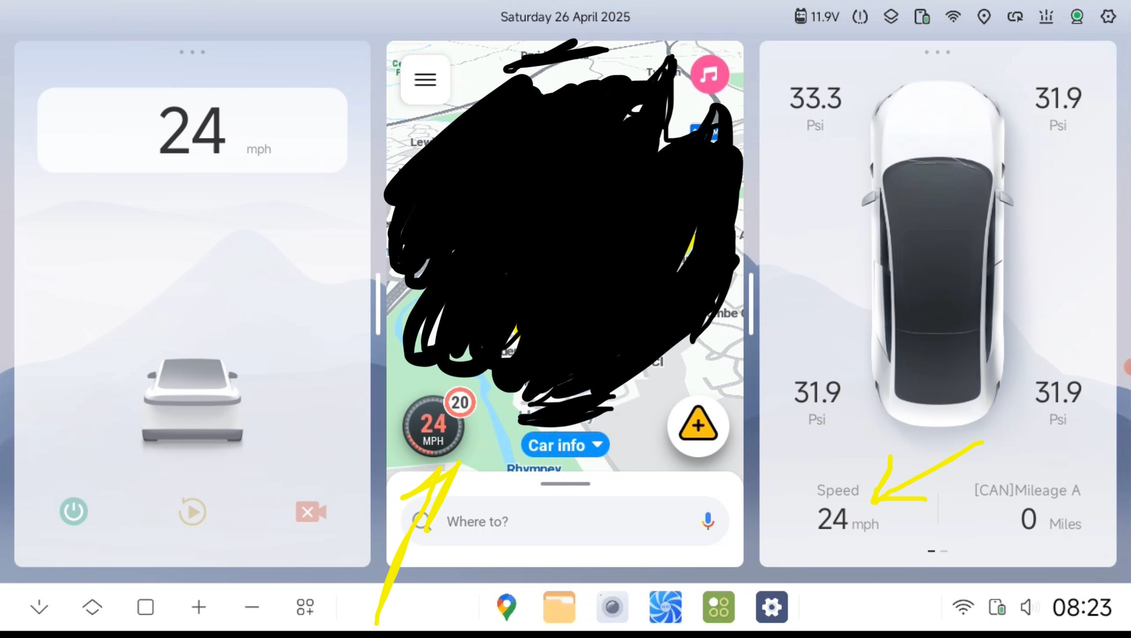

    UK here also, this was known to the devs and fixed, it is working fine for me across all DUDUOS speed widgets in MPH, showing the speed which is as close to as possible to the vehicles speedo.

        Which areas are you referring too, all the following areas are syncing correctly for me also The normal mode equivalent mini widgets etc.

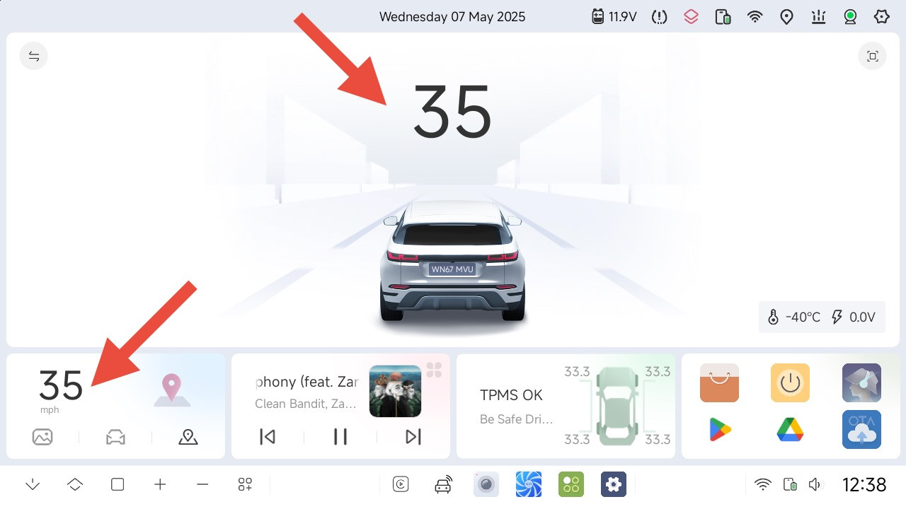

            Are you able to check if minimalist mode works for you correctly?

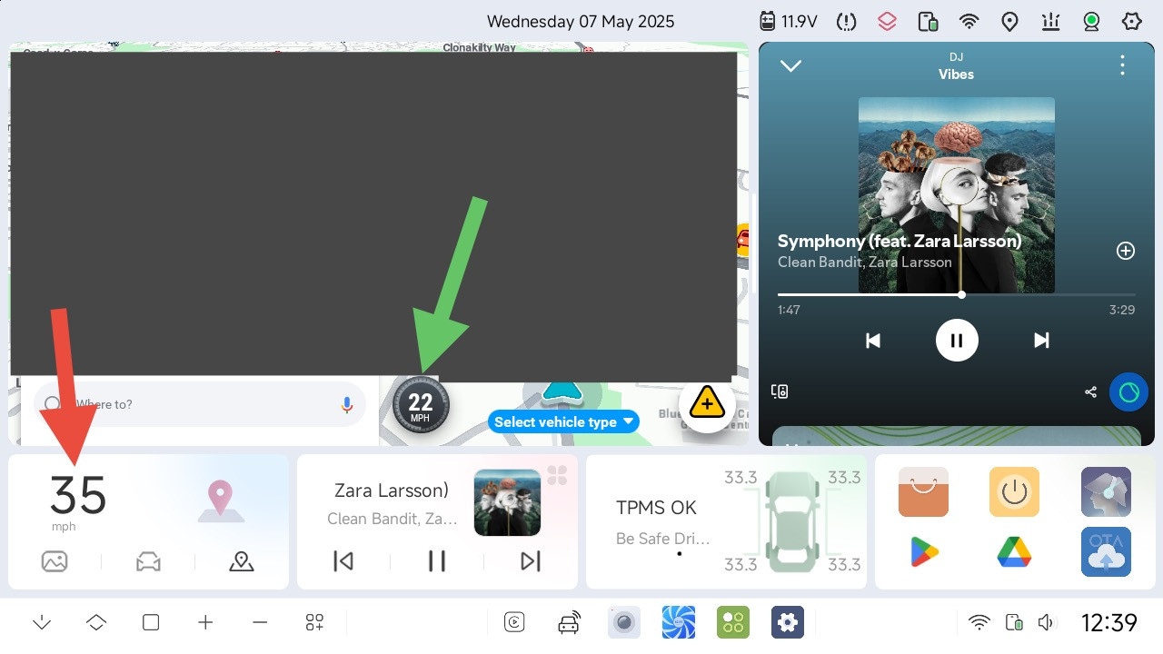

            @DUDU-Meng i have checked this out and it appears that the global speed unit fixes completed for minimalist mode has broken the normal mode speed values for MPH.
            The red arrows are incorrect, the navigation speed is correct.
