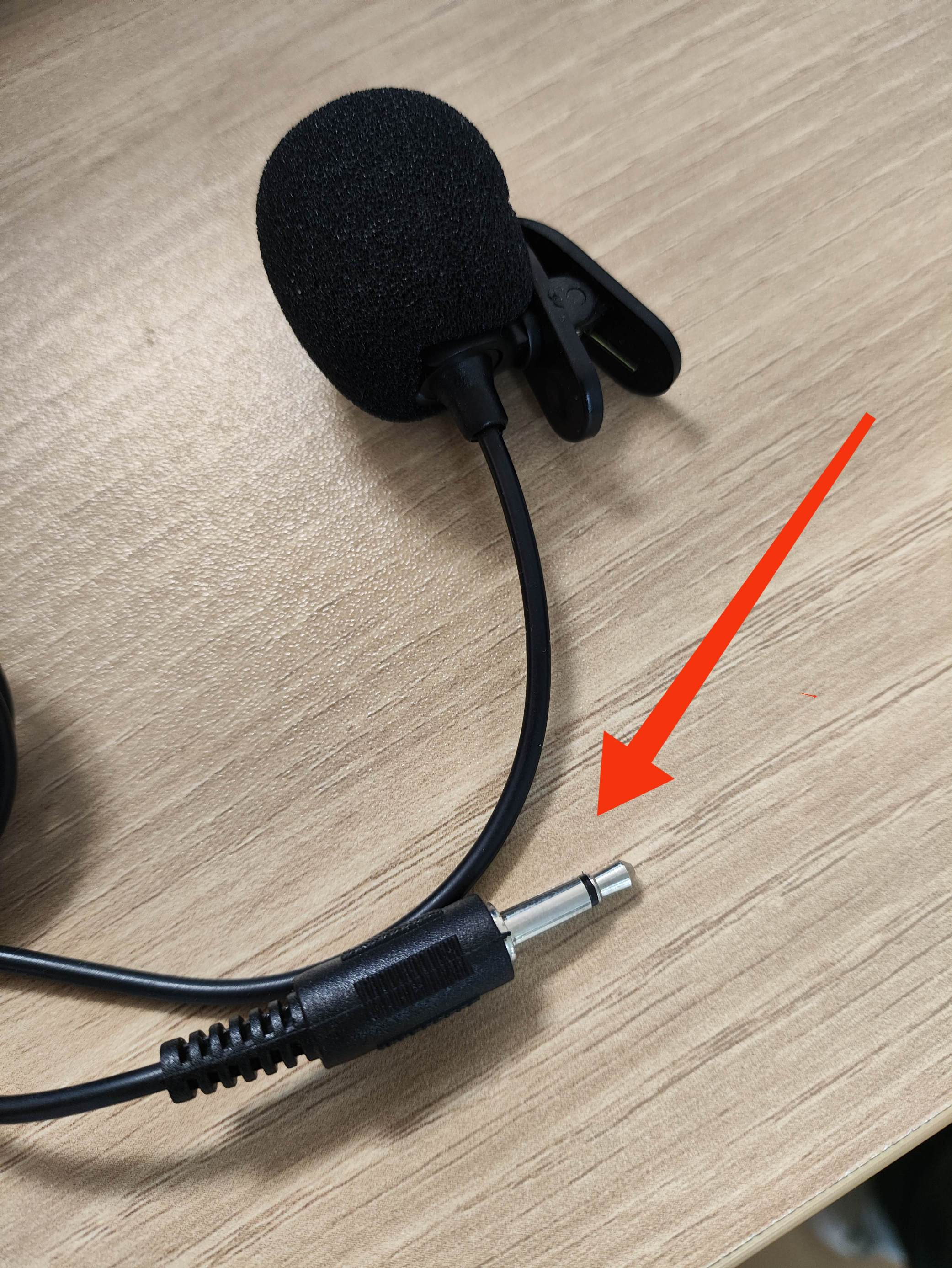

What size is the input for the microphone? 2.5 or 3.5?
Did you try the internal Microphone? It is really good. Never had problems with it.
It's this kind of joint. 3.5
