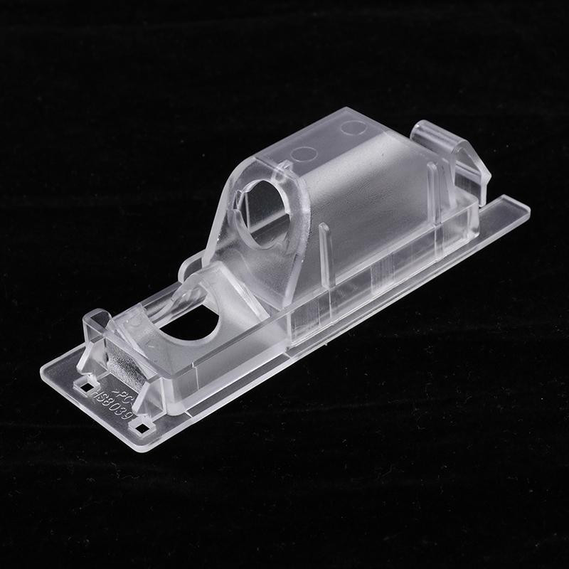

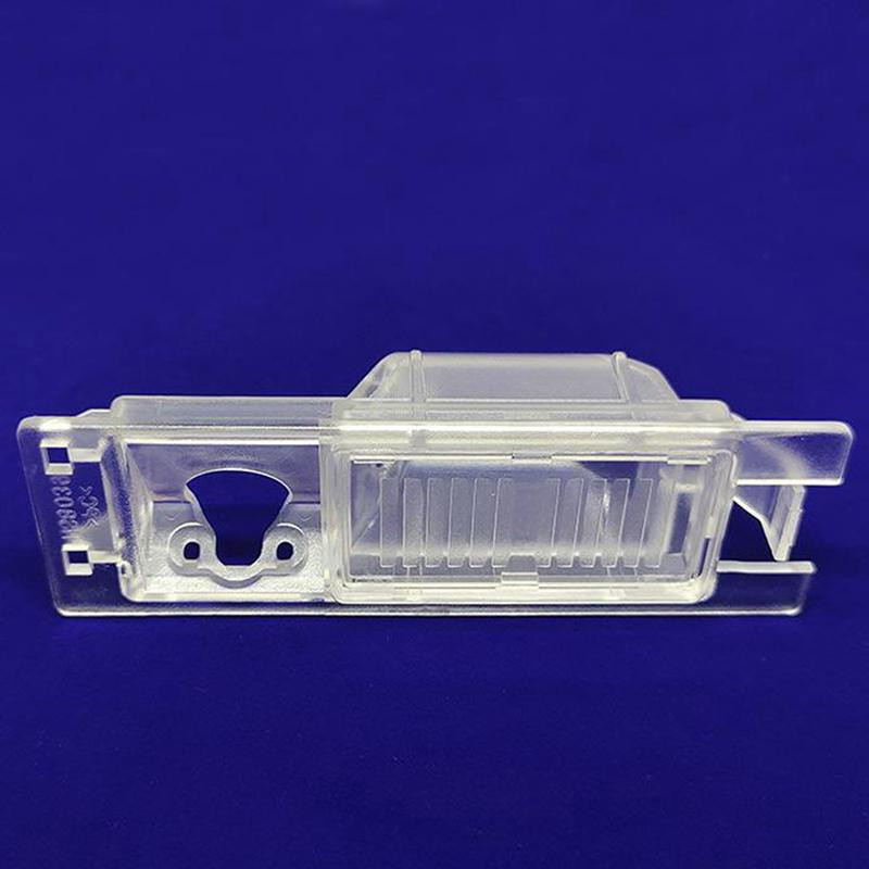

I found a very nice assembly unit that might just be what I need to fit the original camera in 🙂

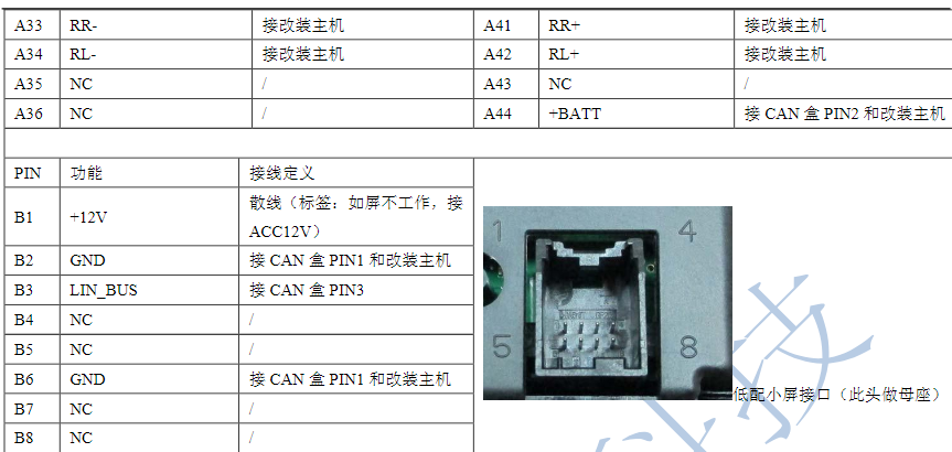

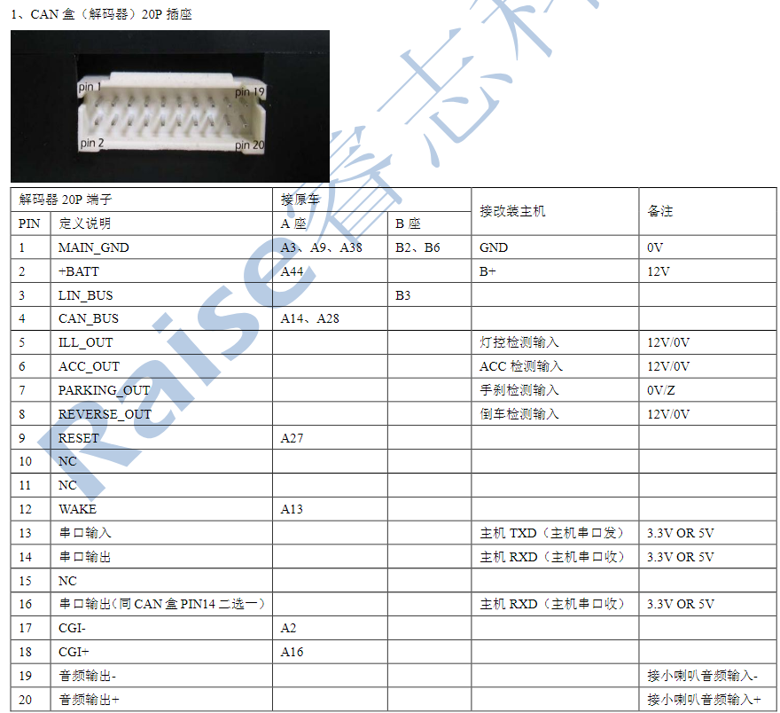

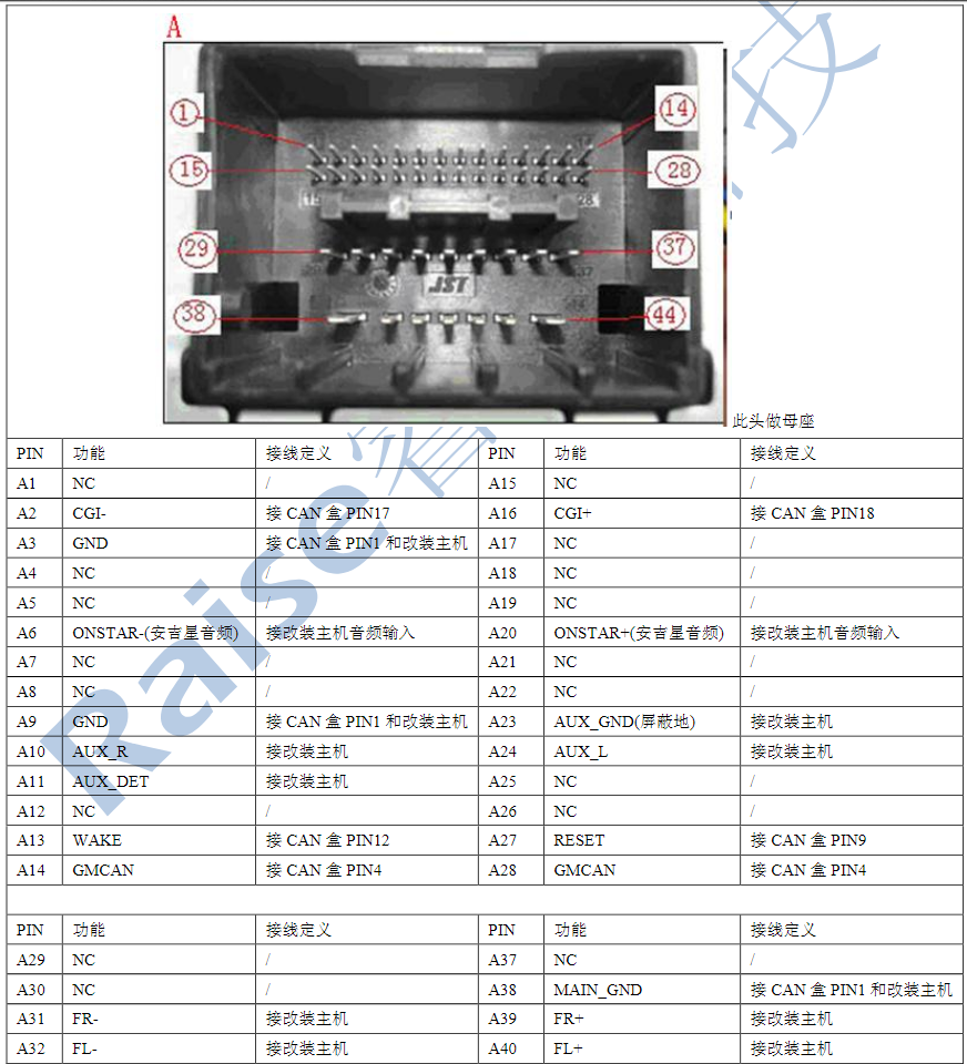

        robbie_j GM-RZ-11 Pin
          Thnx so much dudu-lai , you are much faster then raise support 🙂
          I soldered the correct lines to the corresponding pins, at least I think I have but no luck yet, the HU is not booting.
          I used the below:
          1 GND
          2 +12V
          4 CAN-L (single thread GMLAN)
          5 ILL
          6 ACC
          7 PARK
          8 REV
          13 RX
          14 TX
          I might have fried the PCB last Tuesday already trying 2 - 3 times with different pin outs before you gave me these. 🙁
          Wish I waited now. The HU is working fine on the RP5-OP-001 though, I got the SWC working now. So I am figuring to maybe buy a new GM-RZ-11 to try again.
          Do you think the pins I just tried are the correct ones and the HU should have booted?
            robbie_j properly
            ordered a new one, I am curious now if this works.
            15 days later
            Tried with a fresh GM-RZ-11 unit but unfortunately the dudu7 doesn't turn on. So I decided to leave it with the RP5-OP-001.
              robbie_j Are you using the wiring harness that comes with the RZ-GM-11?
              The pin definitions may be different from the simple definitions
