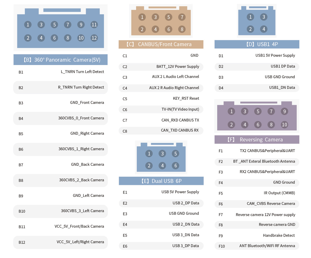

On my dudu7 there are 2 wires that are labled aux 2 Laudio and aux 2 Raudio. Can these be used to connect an extra audio source and if yes which app can be used to play this channel?

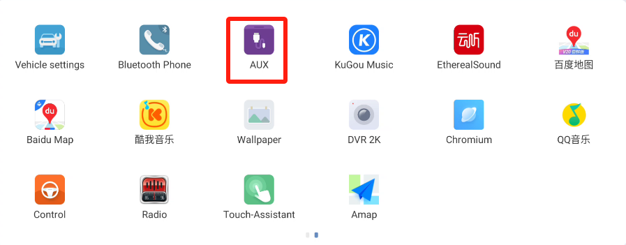

    ismove The external audio interfaces are AUX L IN and AUX R IN. playback using the AUX application.

      ismove AUX2? In which connector?
      The CANbus/frontcamera

      C3 and C4 on the CAN bus connector

        190000000-comsyutv-signapk.jar
        2MB
        Use this application
        4 days later
        When opening the app (it is a tv app?) it shows the input on AUX 1 and I dont see how to change that to AUX 2
