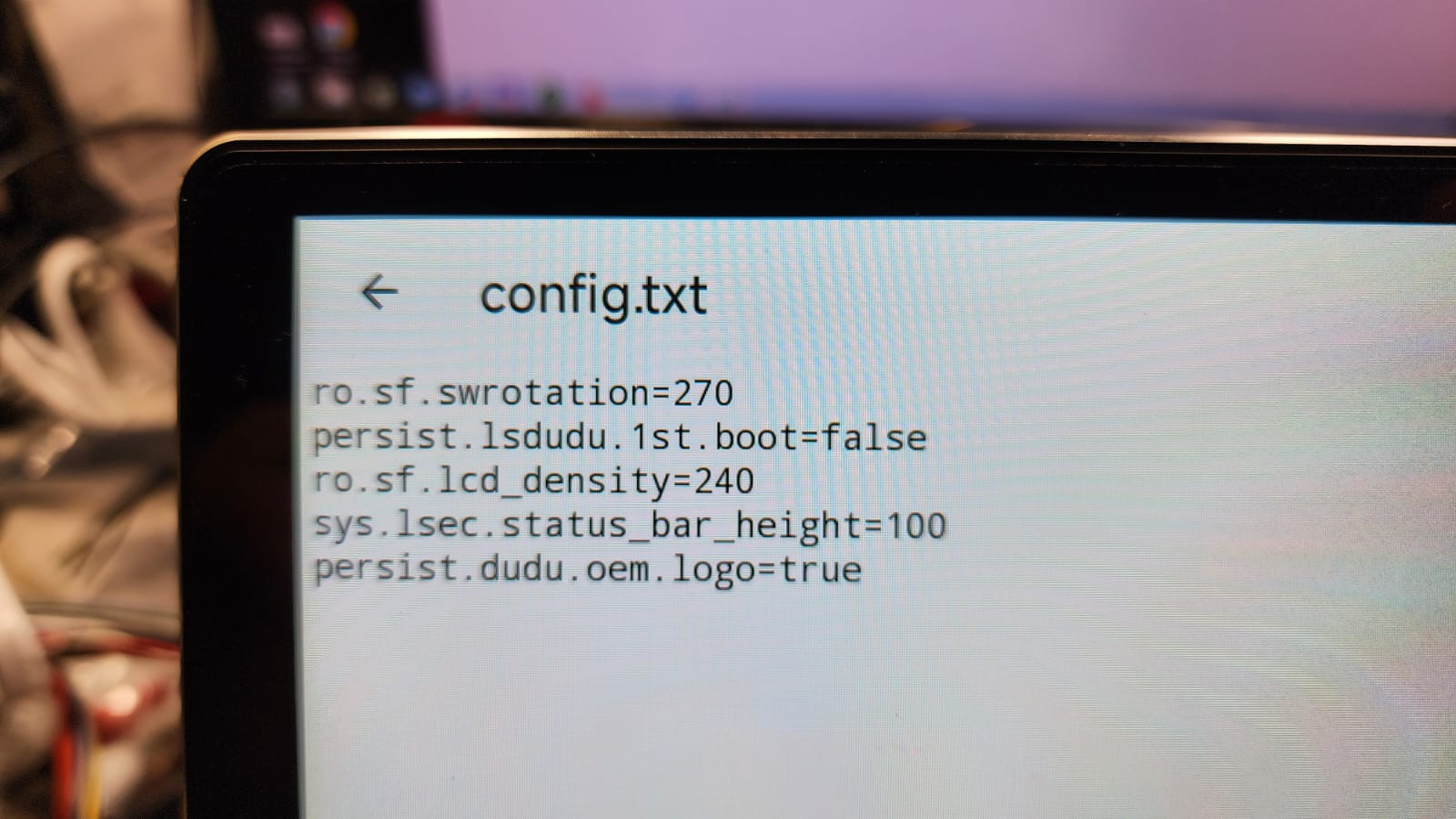

I set the CFG to rotate 270 degrees, but the image didn't flip over. DUDU7 DUDUOS 3.6 is the latest update. Can you tell me for what reason?
DUDU7 does not support software rotation of the screen, only by upgrading the screen driver for different angles.
    DUDU-Meng Is there a driver, is there any way to fix it?
      KravtLab See how your screen angle isn't normal?
      If it's normal, then there's no version of the angle you want to DIY, you need to customize the screen parameters according to the model of your screen to do so

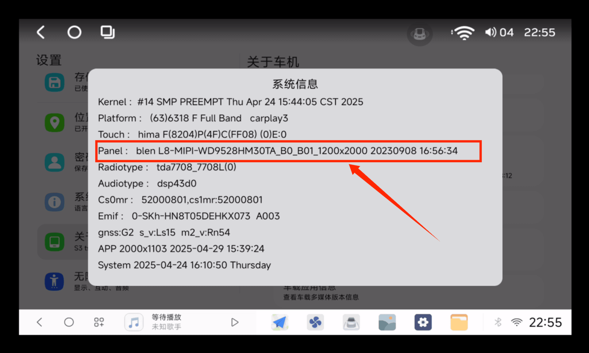

        The screen you're using now, take a picture of this for me.
        I'll see if I can find the parameters for a 270 degree screen

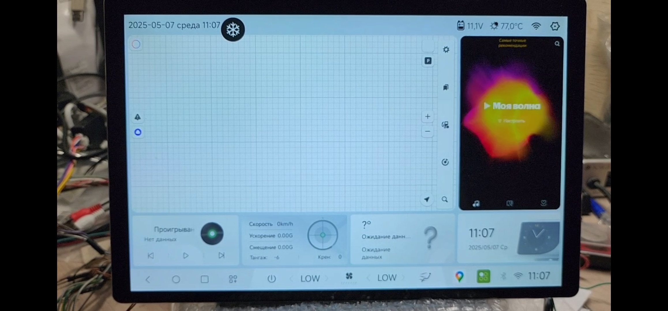

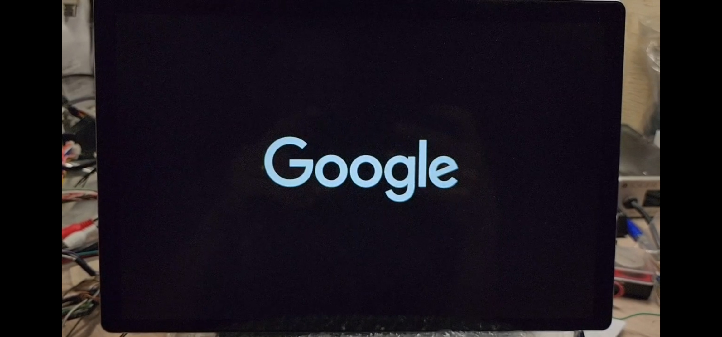

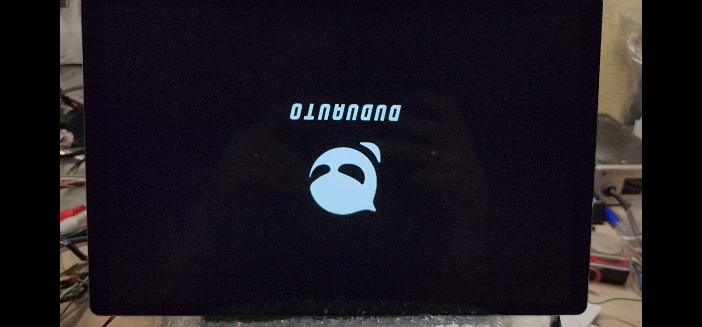

              DUDU-Meng Thanks, the screen turned 180 degrees. The only thing left is the DUDUAUTO screensaver, which is not turned over.
                KravtLab
                You can take care of the screensaver yourself. You rotate the image and then just upgrade it with a boot file. Or don't change it. Just use it like this.
