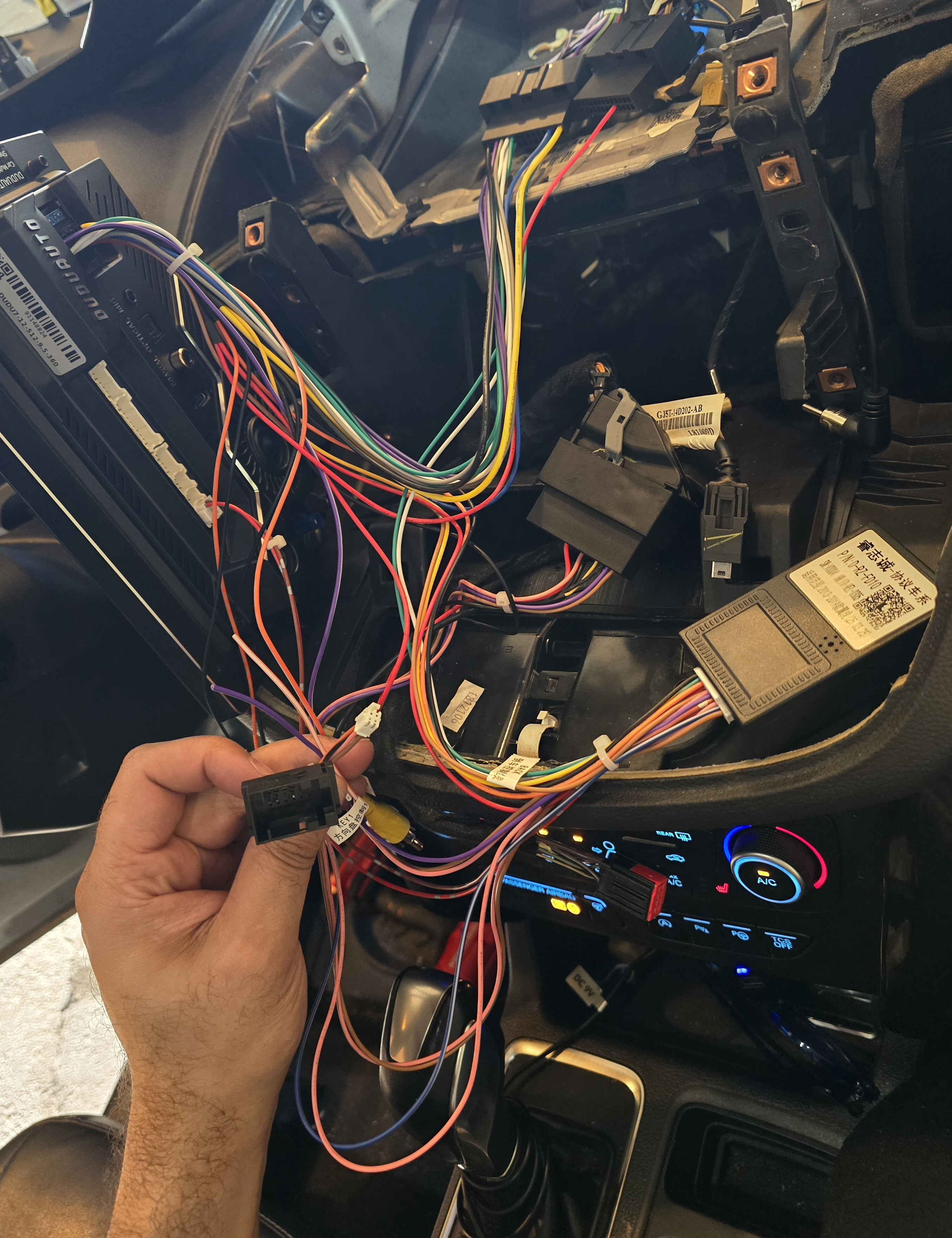

I have a 2019 Ford Escape Titanium. I've installed the DUDU7 but it will not power on. I have the CANBUS box installed and everything else seems to be correct. Please help. Thank you! adding a pic.
Does this help ?

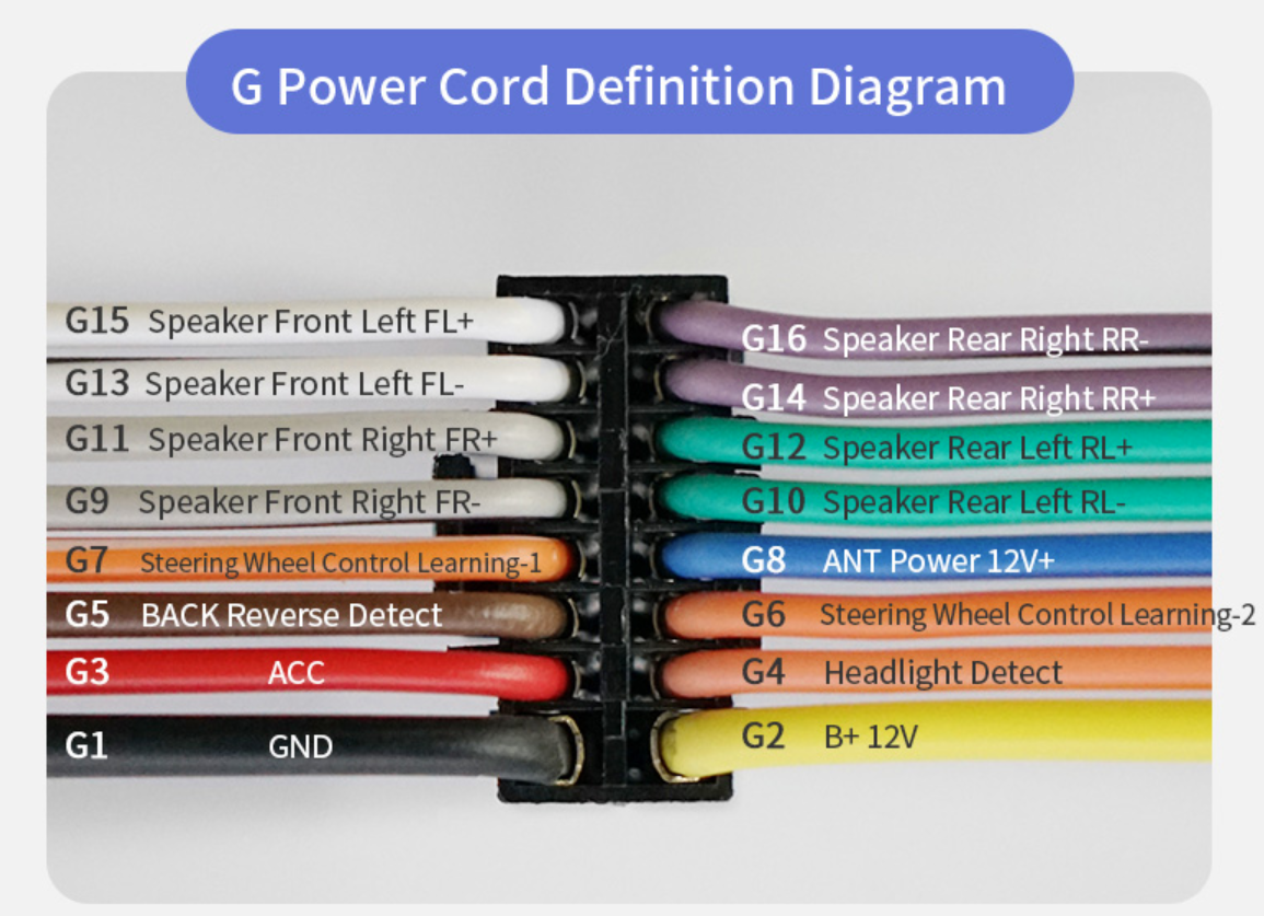

Hello, you need to measure whether G2 and G3 have 12V or higher voltage.
If G2 has no voltage, it means the car fuse is blown!

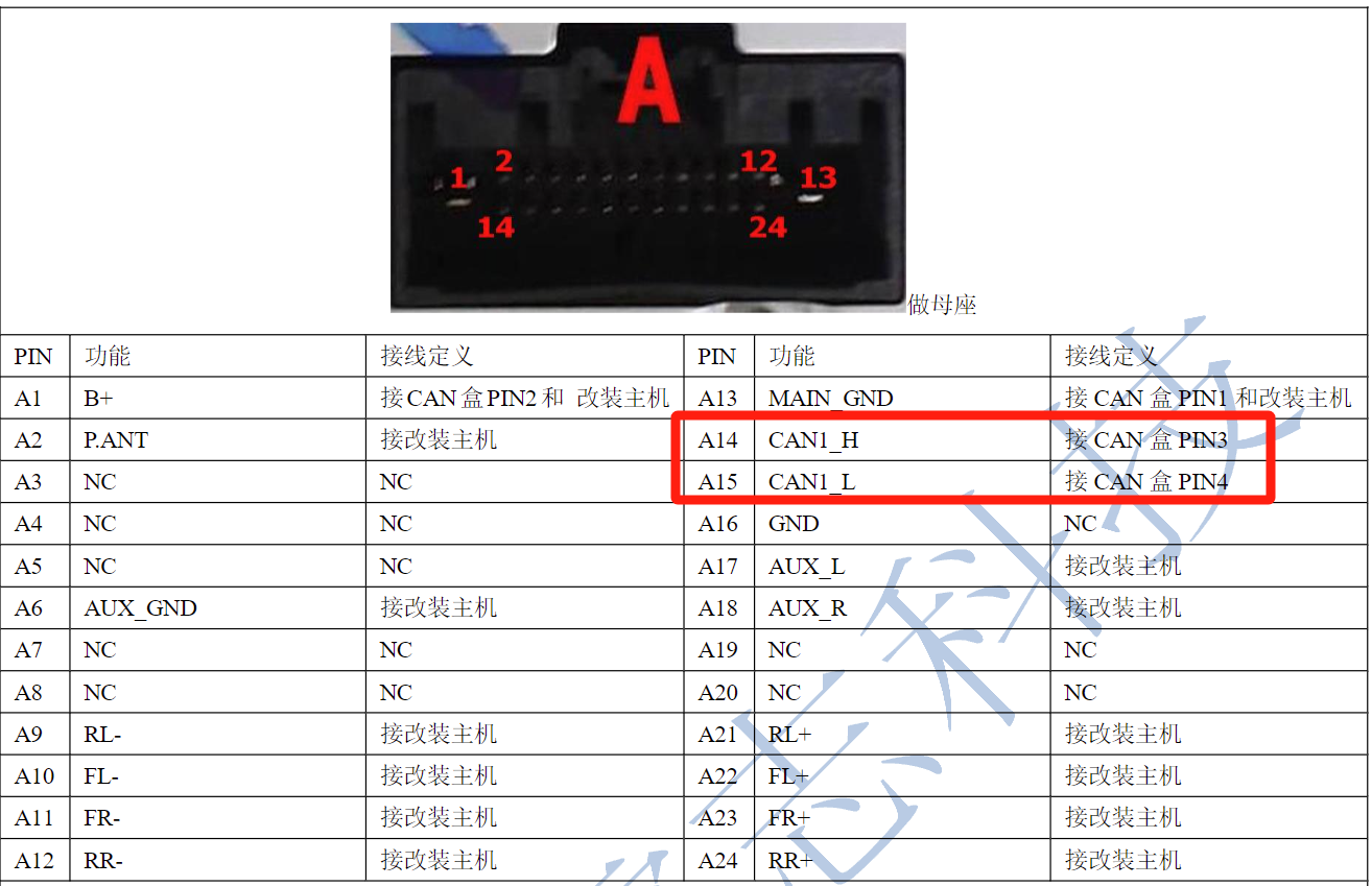

If G3 has no voltage, the CANBUS box is not working, you need to check the A14 and A15 pins (CAN cable).
