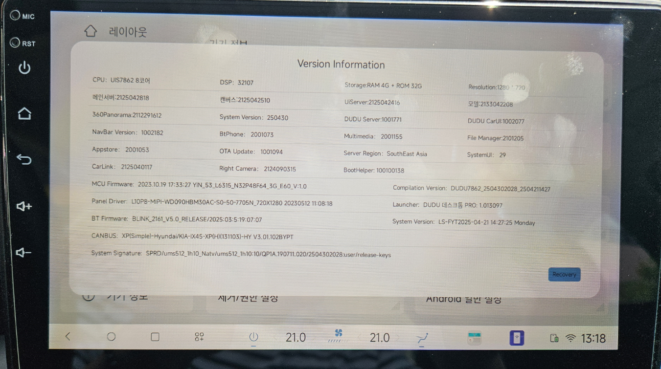

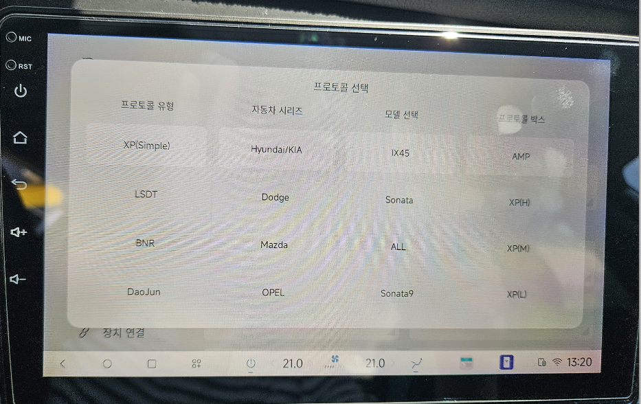

I am currently driving a 2013 KIA K5 in Korea, and the vehicle is equipped with an AMP. I'm using an Android all-in-one head unit based on the 7862 platform and utilizing the SIMPLESOFT CANBUS. Up to DUDUOS version 3.6 Beta 2, the CANBUS setting worked correctly when set to "IX45 - AMP," and the AMP values were functioning properly. However, starting from Beta 3, the "IX45 - AMP" setting no longer works, and it only operates under the "IX45 - HIGH" configuration.

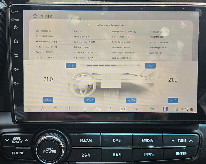

Additionally, I have noticed that the call volume is somewhat distorted or degraded. When using the air conditioner, the display temperature for the dual-zone (passenger side) no longer updates properly.
I suspect that the CANBUS configuration was altered during the transition from Beta 2 to Beta 3, which caused these issues. Could you please confirm if this is the case? Aside from these problems, everything else appears to be functioning normally.

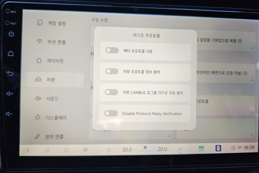

Factory Setup/Test Protocol/Off Protocol Recovery Check ON.
Does testing fix the protocol?
    DUDU-Meng Let me give it a try.
      K5TGDI Waiting for your test results.
        DUDU-Meng The item you mentioned was not found. TEST PROTOCOL WAS OFF OR ON , the result is same.
        ix45 - There is no major problem in using it with xp(H), but when selecting the AMP item, the sound becomes very small even though it is an AMP vehicle. This wasn't an issue in 3.6 beta2, but it's something that's been happening since beta3,4,5.
        There are no major issues with current use, but I hope it gets resolved.
        Turn this switch on and test it.
          DUDU-Meng the result is same. There is sound and no immediate inconvenience, but I hope it will be improved. I always appreciate good software improvements.
