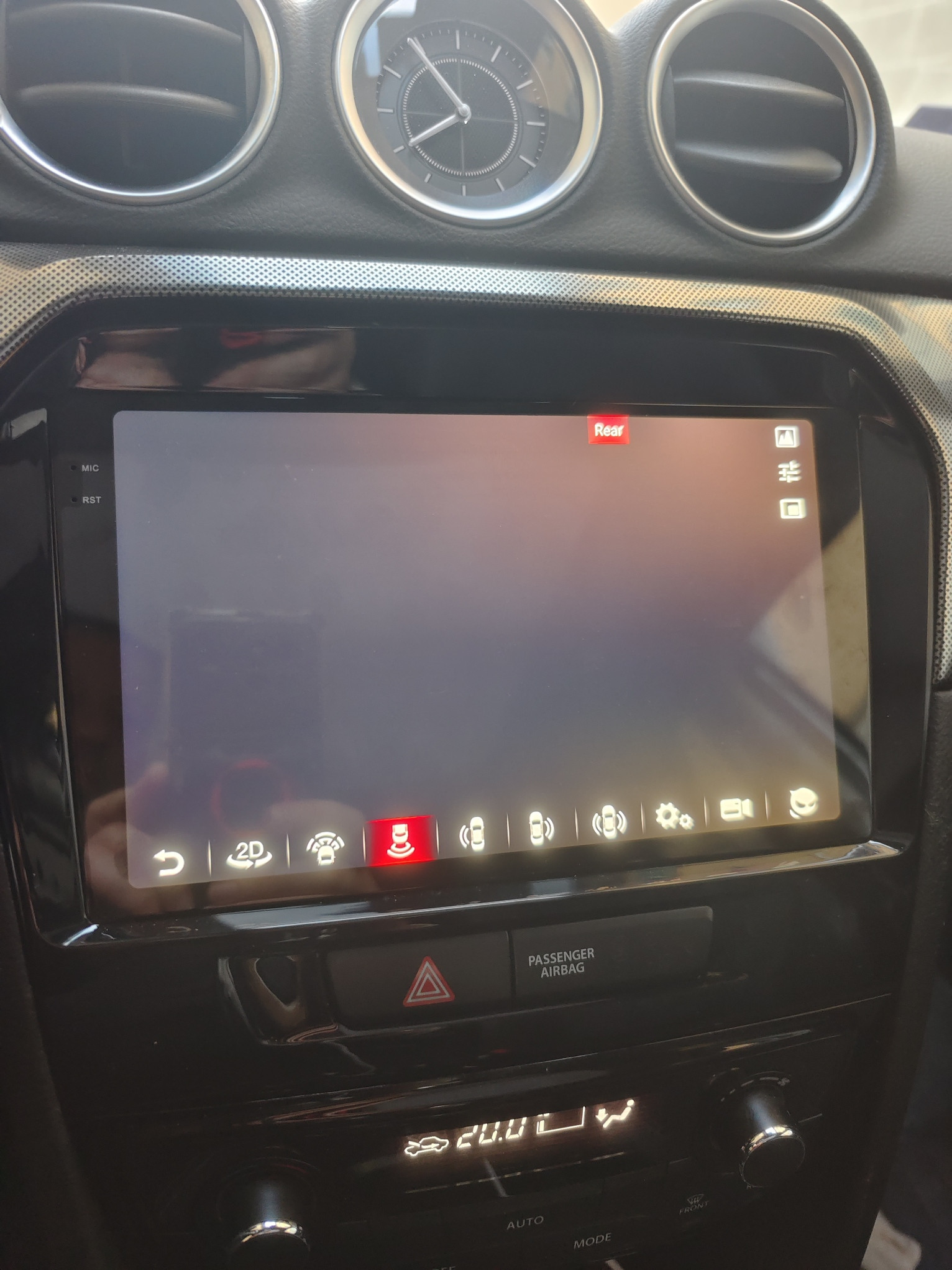

    Hello everyone,
    I am connecting to this post because I have the same problem as Jhonclark237: I have a 2021 Suzuki Vitara and when I put it in reverse the screen changes mode but I have a black screen. The rear camera is OEM (6v) but with an adapter and with a k4811 it worked very well by setting CVBS-NTSC. With DUDU7 however I tried more settings but without success. I ask for your valuable advice

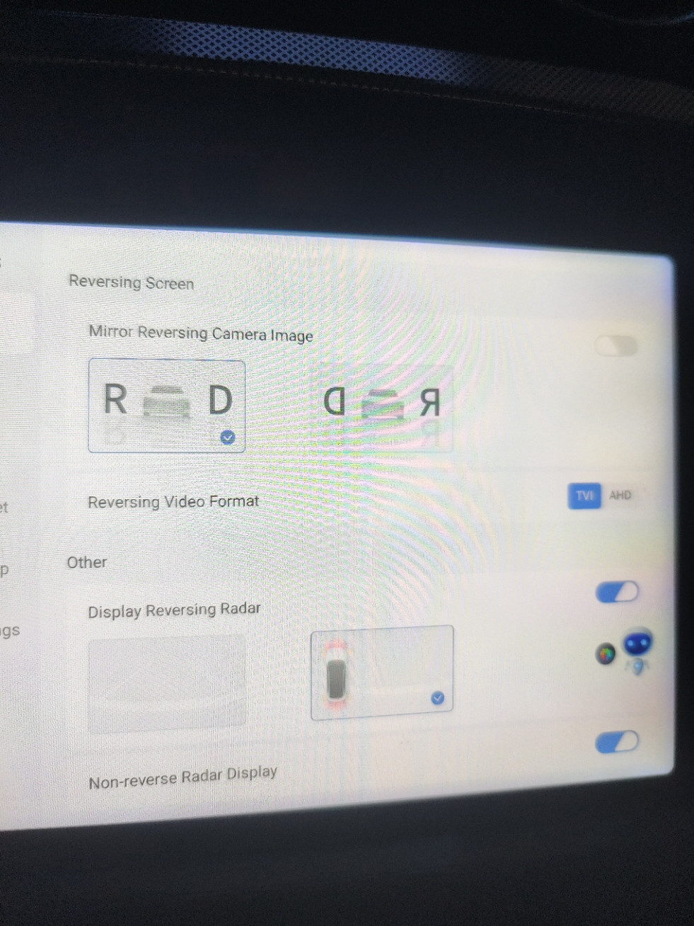

      in the settings I find TVI and AHD, but what does TVI mean?
        MBO TVI is another standard, depending on which camera you are using
        Hi, thanks for your reply. I am using a CVBS-NTSC rear camera.
        So if I understand correctly it is correct to say that DUDU7 does not support CVBS cameras?
        Thanks
        CVBS is not supported
        ok then i need to buy an AHD. Thanks again for the support

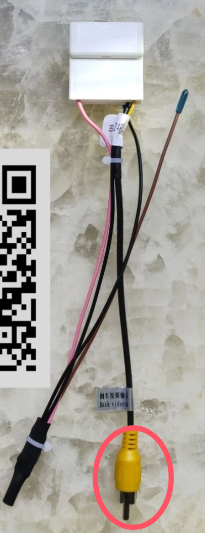

        There is a Tulip Lotus connector on the adapter harness, did you connect it to the F zone connector on the DUDU unit?

          dudu-lai also to be sure can you show me a picture of the “tulip”
          dudu-lai Tulip Lotus connector
          Can you show me what this is to be sure? Everything triggers but just to a black screen. Feels like something is missing
            Johnclark237 RCA

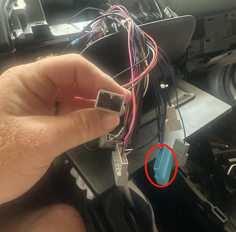

            Pretty sure i narrowed it down to the wiring harness being wrong for my car
            This female connector runs to the rca yellow connector for back up camera. I do not have a corresponding make connector in my car. I do however have this blue make connector from the car which I’m pretty sure is the connection i need for the backup camera. Anyone know where i can get the correct wiring harness?

              Isn't this blue connector? Why is the OEM connector not connected?
              This is the second harness i bought through someone else. This is the harness i was sent with the Dudu screen.
              And that harness didn’t work either for the backup camera. I think the pins were either in wrong spot or bent so i lost hope and i just added my own third party camera to car. The usb connector wasn’t correct either. My Honda has a double usb not a single. So i had to go buy
                Johnclark237 The wiring harness is incorrect and you have received a low configuration harness
