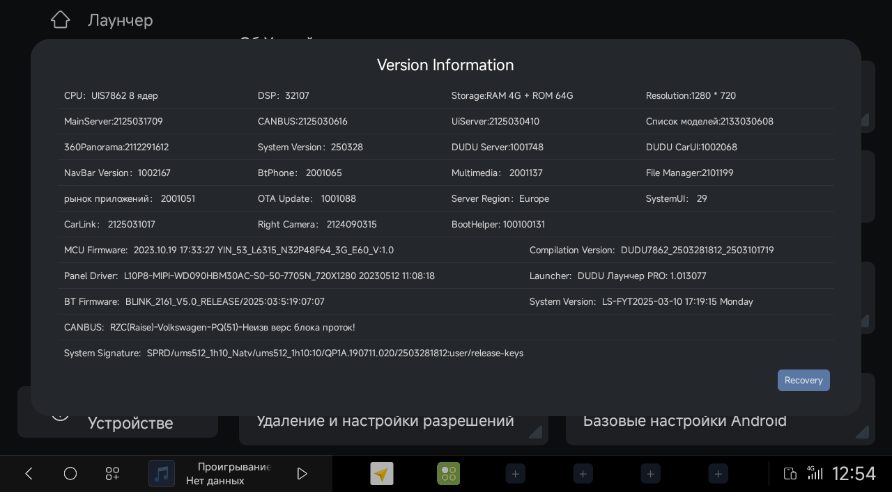

After that, the radar window no longer appears. I went into the settings, turned off and turned on the radar display function without turning on the reverse gear. Switched to version 3.6 beta 3. Reset the canvas settings. I reset the radio to factory settings. Nothing helped.

        Gsibaja в обновлении 3.6 бета 3 ошибку исправили. Сейчас у меня стоит 3.6 релиз. Все работает исправно
        Yes, the new version has fixed the low speed radar not popping up.
