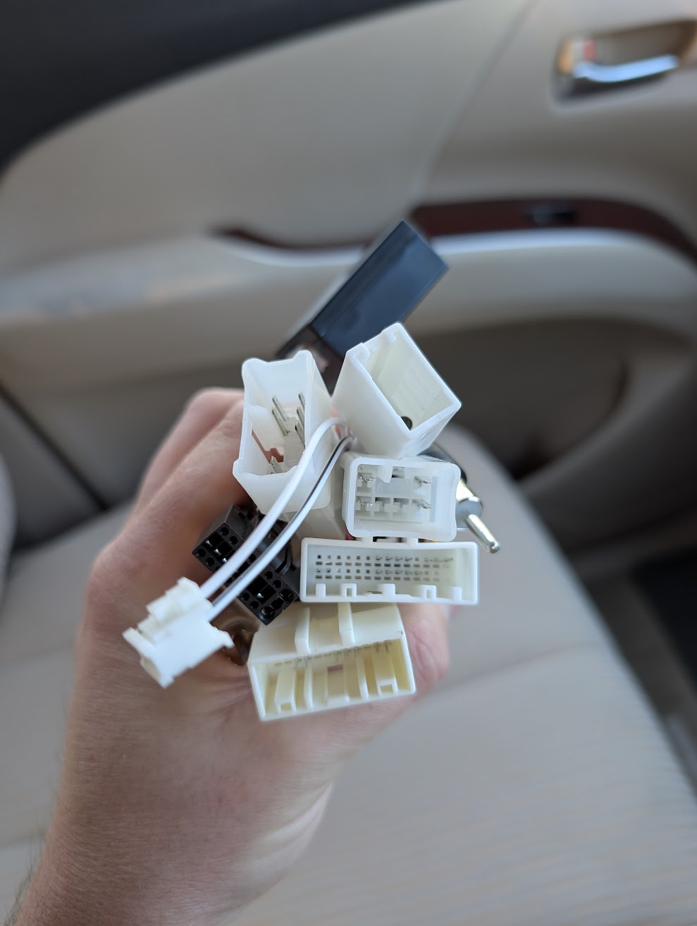

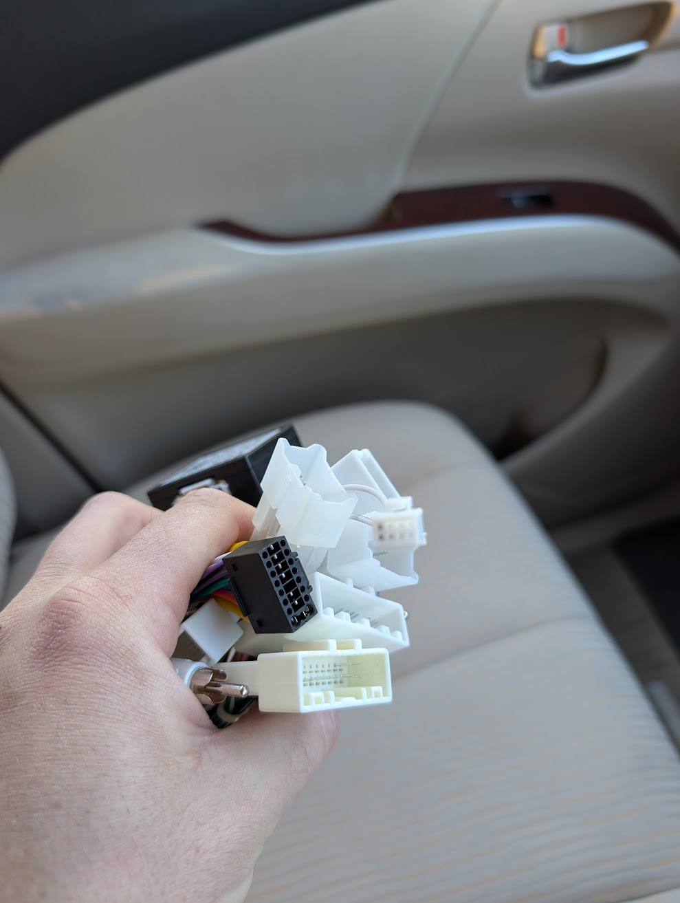

Hello, I've just installed my dudu7 on a Toyota Estima 2013.
It seems to be working but the canbus is not. I got no vehicle info and the steering wheel buttons are not working.
All of the cables in the images are left unplugged as I could not find where to plug them in the dudu7 harness.
Have I missed anything?
Thanks!
    Isilva1 Hello, I don't see a CANBUS connector for the car in your picture, this car has no CANBUS for the center stock connector.

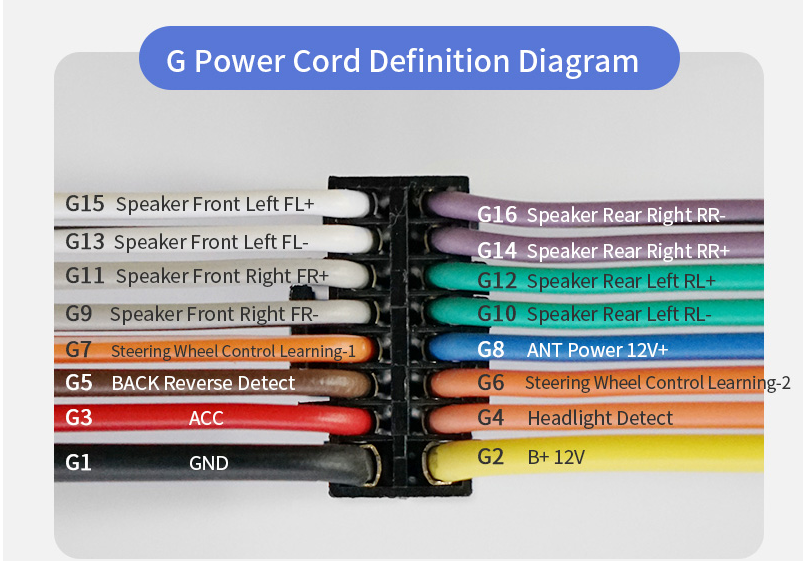

    SWC issue: the 20P connector in the picture contains the SWC cable, you need to connect SWC1/SWC2 to G6/G7 on the G connector of the DUDU device as shown in the picture, GND is connected to the negative side of the power supply. Then in Settings - Automotive - SWC - learn the appropriate buttons

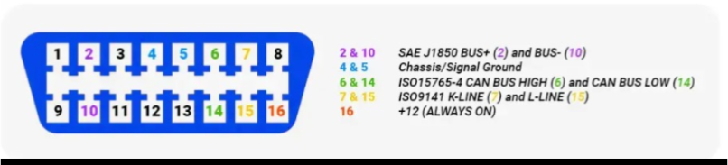

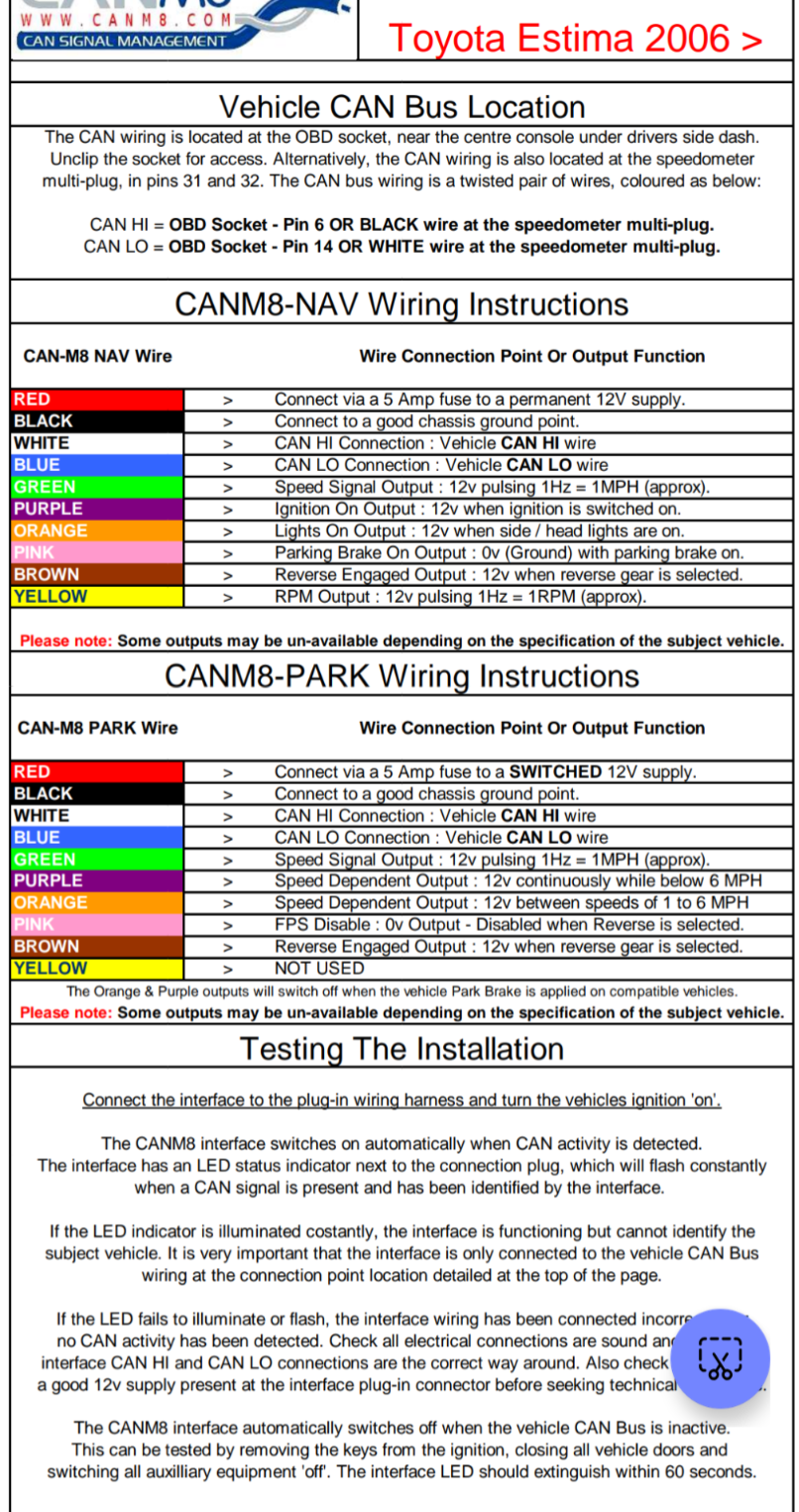

    Hello, my Toyota Estima 2013 has canbus.
    Here is a diagram. It's located in the OBD connector.
    Can you let me know what cable or how I can connect the can high and can low to the CANBUS and stereo?
      Isilva1 Requires purchase of RAISE CANBUS box
      Isilva1 Had a very brief look on AliExpress... Basically you'll need something like the following link (if I'm allowed links!?) BUT, the link is Estima up to 2012... For your 2013 model, you'll need to search for the correct adapters

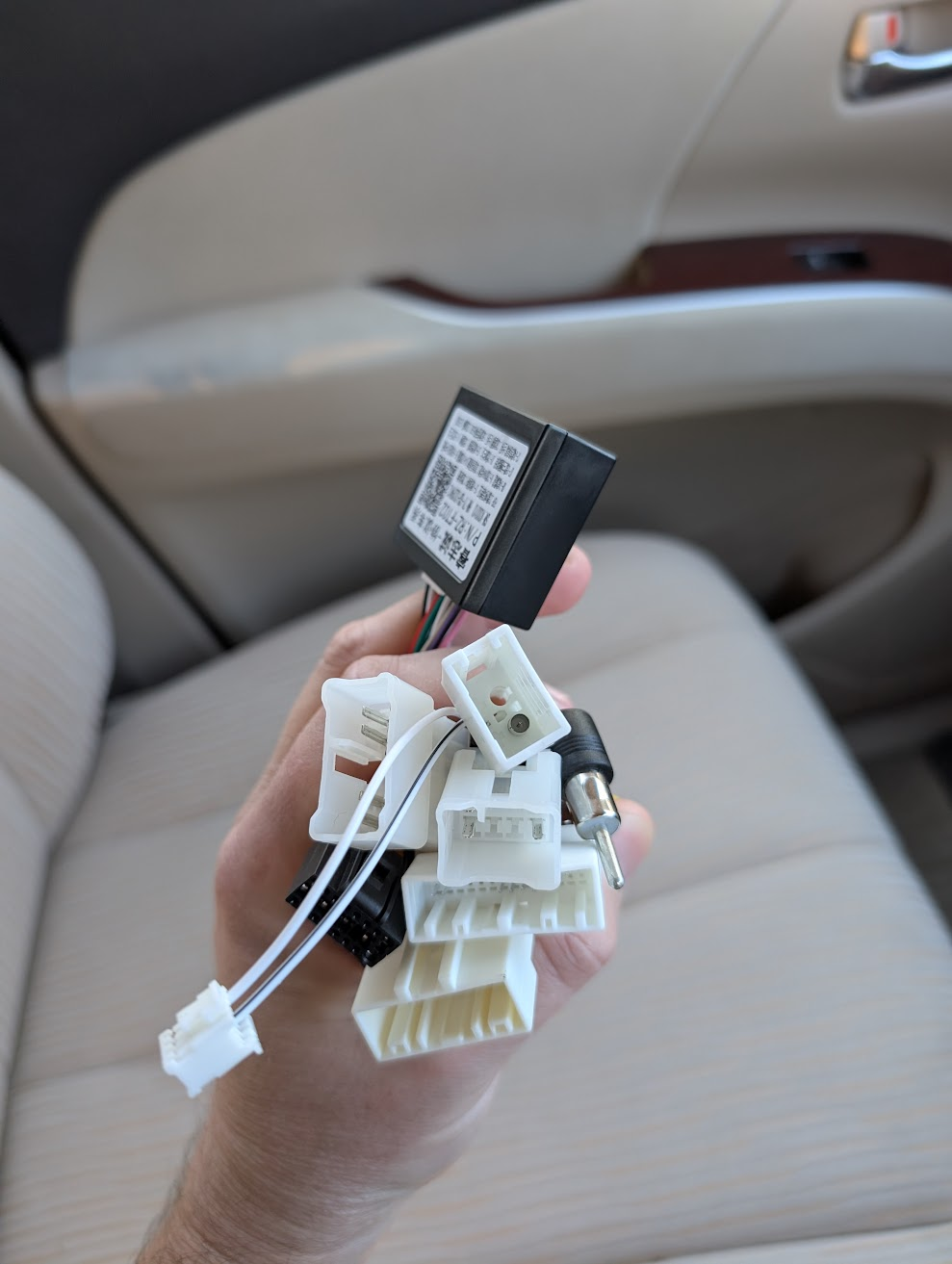

      I already have a RAISE CANBUS decoder and harness. The problem is that my Estima CAN HIGH and CAN LOW are not behind the stereo, they need to come from the 2 pins in the ODB socket (please see below):
      So I know how to pull 2 cables from the ODB socket, but where do I plug into my Decoder harness?
      Here is the decoder harness I have:
      Thanks!!

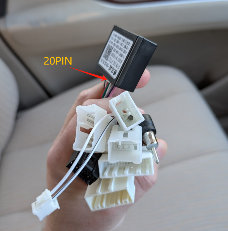

        Isilva1
          dudu-lai thanks, but please see my canbus decoder cables above.
          There is no 20pin connector
            Isilva1
            Isn't it?
            Ah yes, my bad.
            Thank you!
