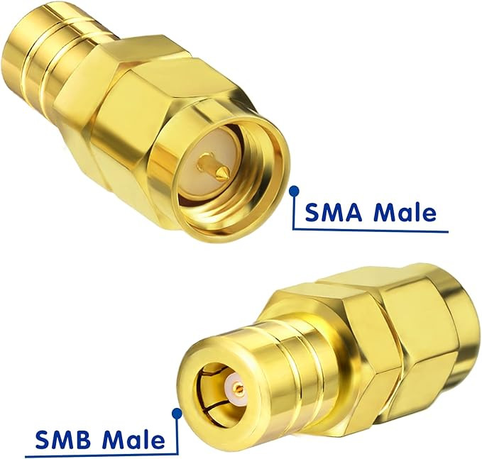

    I had the same problem, I will try with the OEM DAB antenna, there is an adapter to buy between the screwing model (USB adapter) and plugin model (OEM DAB cable)

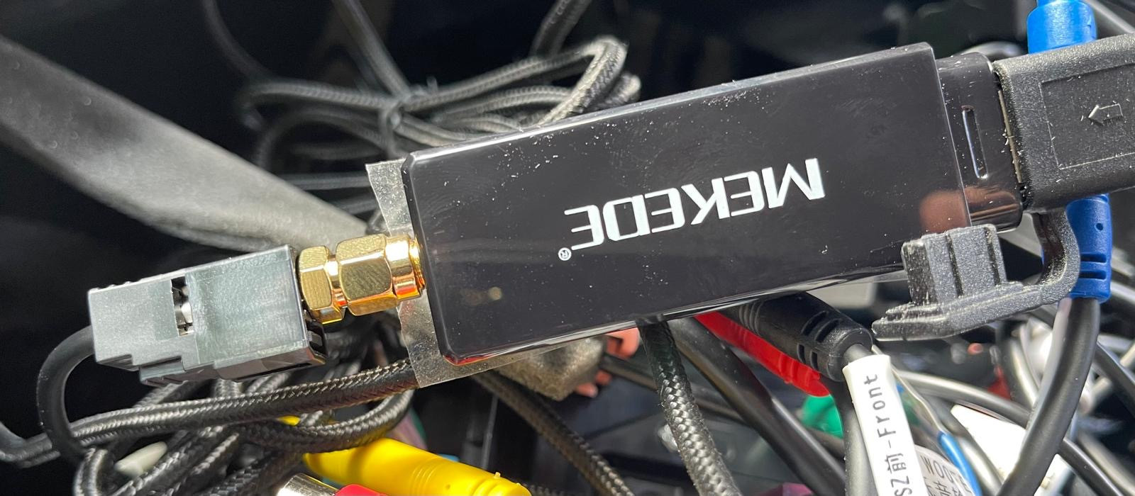

    Hi I tried the SMA/SMB adapter today. It works perfectly. All DAB channels are received at full power (quite a few were with low power with the separate antenna) so I will just remove the provided antenna. There is a small caveat: the physical connection with the SMA/SMB adapter and the OEM DAB is weak. You need some strong « gorilla tape » to make sure it stays connected
      • Edited
      You need to verify if your OEM DAB antenna has small/big SMB and on the DAB stick side male/female SMA

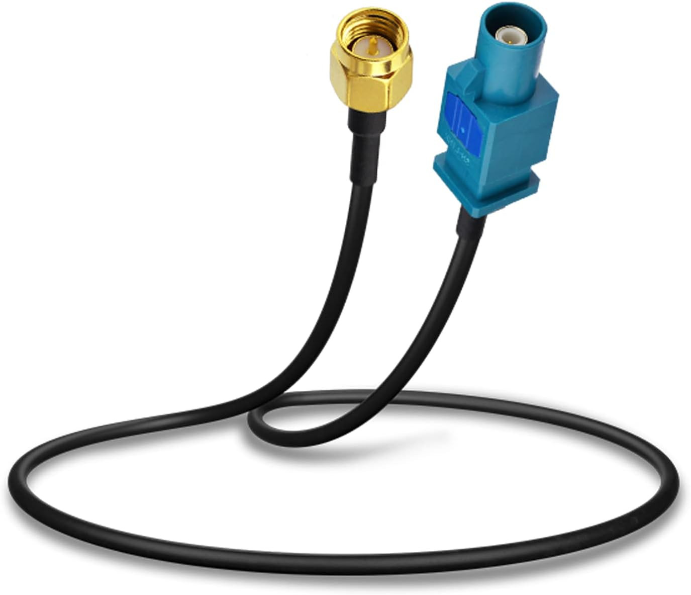

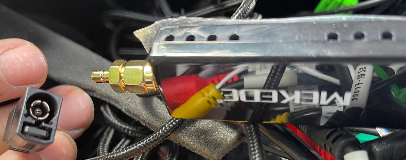

      There are also FAKRA to SMA/SMB adapters
      AK12 I would definitely consider getting something more like this as I can't help but think that taped connection won't be reliable
      Thanks for the suggestion. Yes the Fakra connector is a better option. Definitely more reliable.
