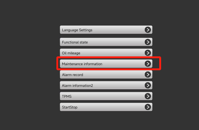

With my factory radio, I could check the oil level through the screen. My Can-Bus connection appears to be working with some other car functions. I have checked the manual and been through all the screens. Am I missing something or is there an application or hardware connection I can add that would provide that functionality?

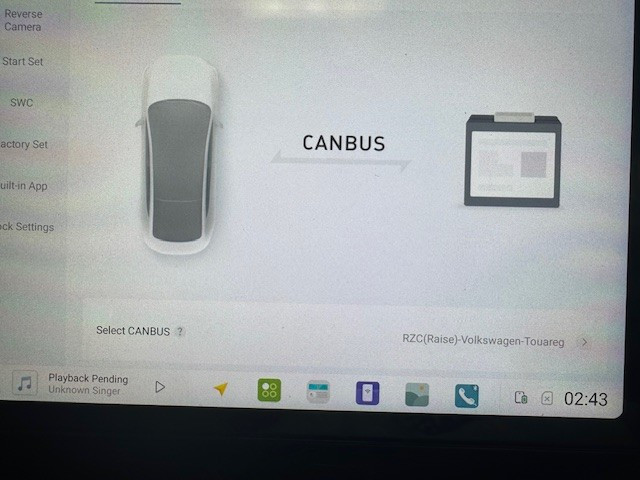

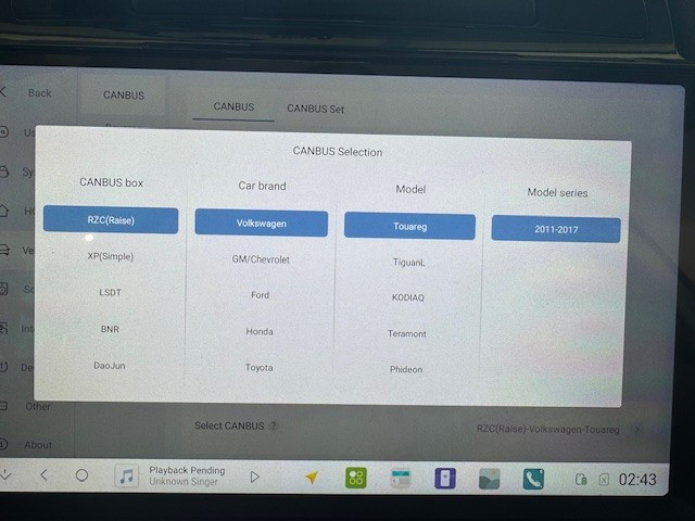

    Treg2012 What brand is CANBUS? Doesn't it show up in the vehicle info?
      dudu-lai see attached

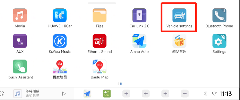

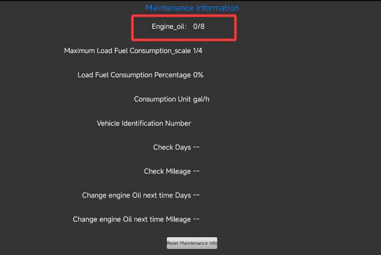

        Treg2012
        Doesn't it show the oil level here?
          dudu-lai Thank you for replying. I cannot find the screen you are showing. Where is it located?

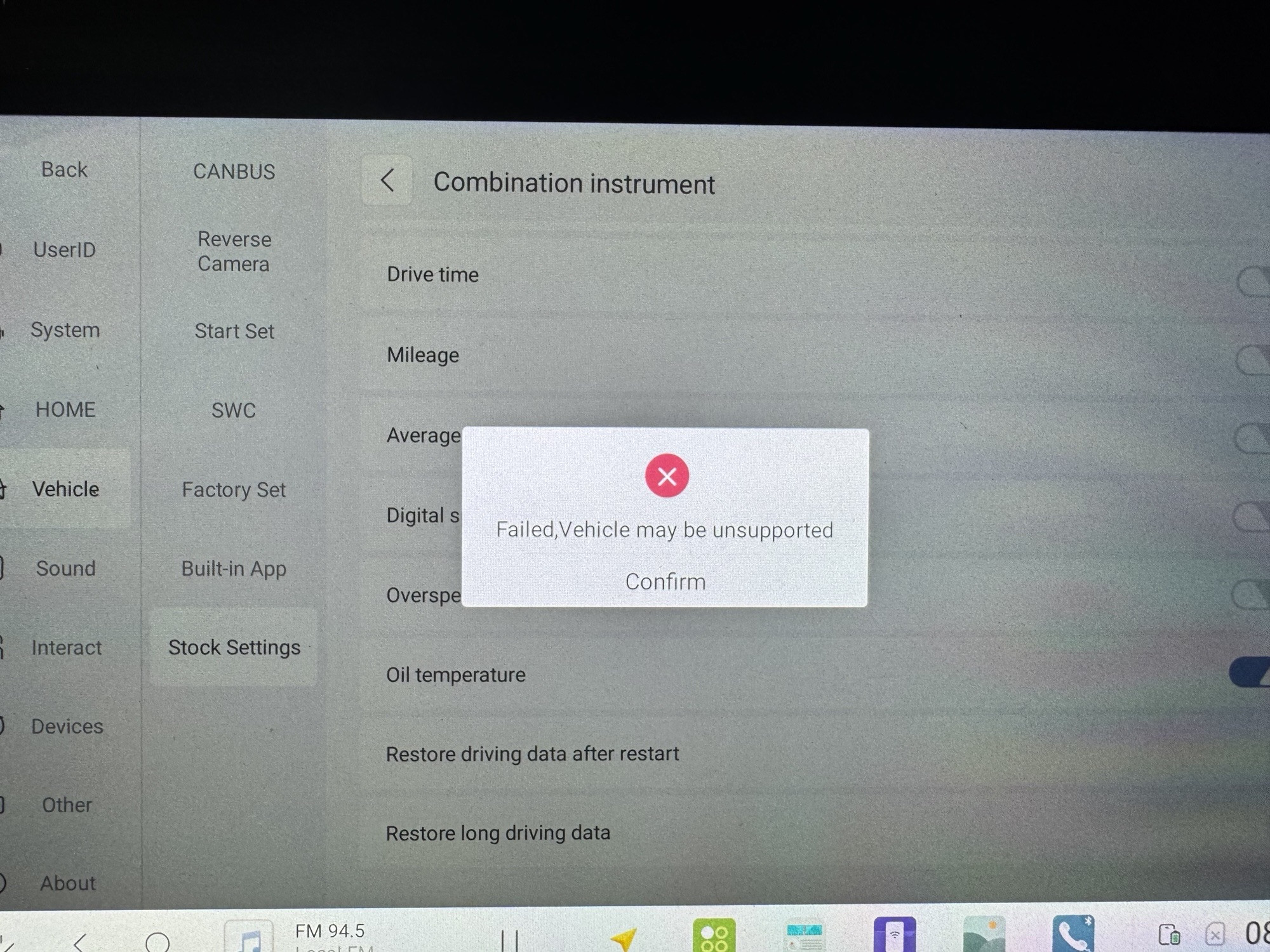

          I have found the "Combination instrument" page but it only has an Oil Temperature option. Also when I click on some of the options it shows the error in the middle of the screen shown in the picture.

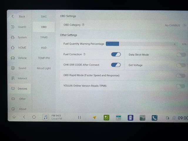

          dudu-lai Here is another screen shot. Notice at the top right corner it states in the OBD Category "No Canbus" but I am connected to the CanBus with one of the supplied interfaces.
            Treg2012
            Thank you. I found it! I was looking under Vehicle Details not Vehicle Settings
