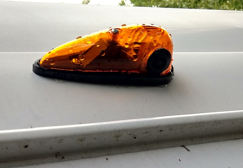

      • the side 360 cameras sold by DUDU are only suitable for mounting on the underside of horizontal surfaces (like under the side mirrors). NOTE: This is only suitable for cars and maybe pickup trucks but NOT for taller or longer vehicles like Cargo or Camper Vans or Motorhome RVs. For this type of vehicle you will need to find a 3rd party compatible camera designed for mounting on the top-side-centre of the vehicle (or manufacture your own adapter to change the mounting of the DUDU side camera)
        ManOfScience
        This is a solution that someone did to mount the under-side-mirror cameras high up on a van.
