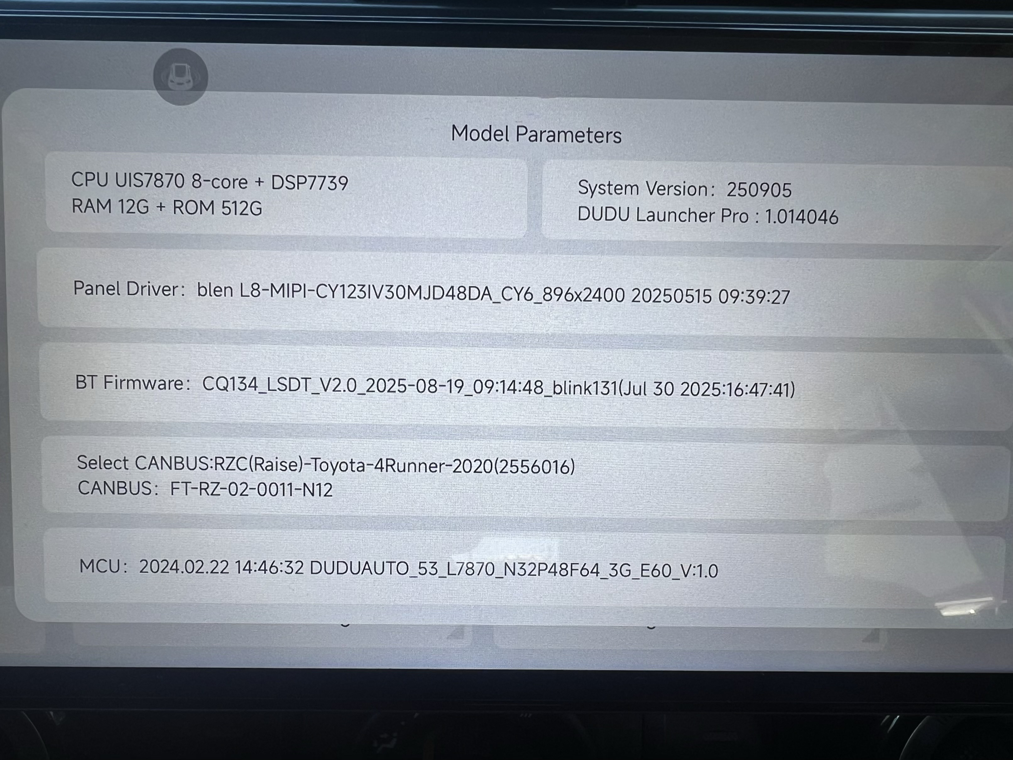

I have not measured the exact delay with a multimeter yet, but based on behavior it does look like the AMP control line is enabled a few seconds after startup (approximately 5 seconds), as described for this MCU version.
Also, after cold boot, there is usually no pop at startup, so the delayed AMP enable seems to be working in that scenario.

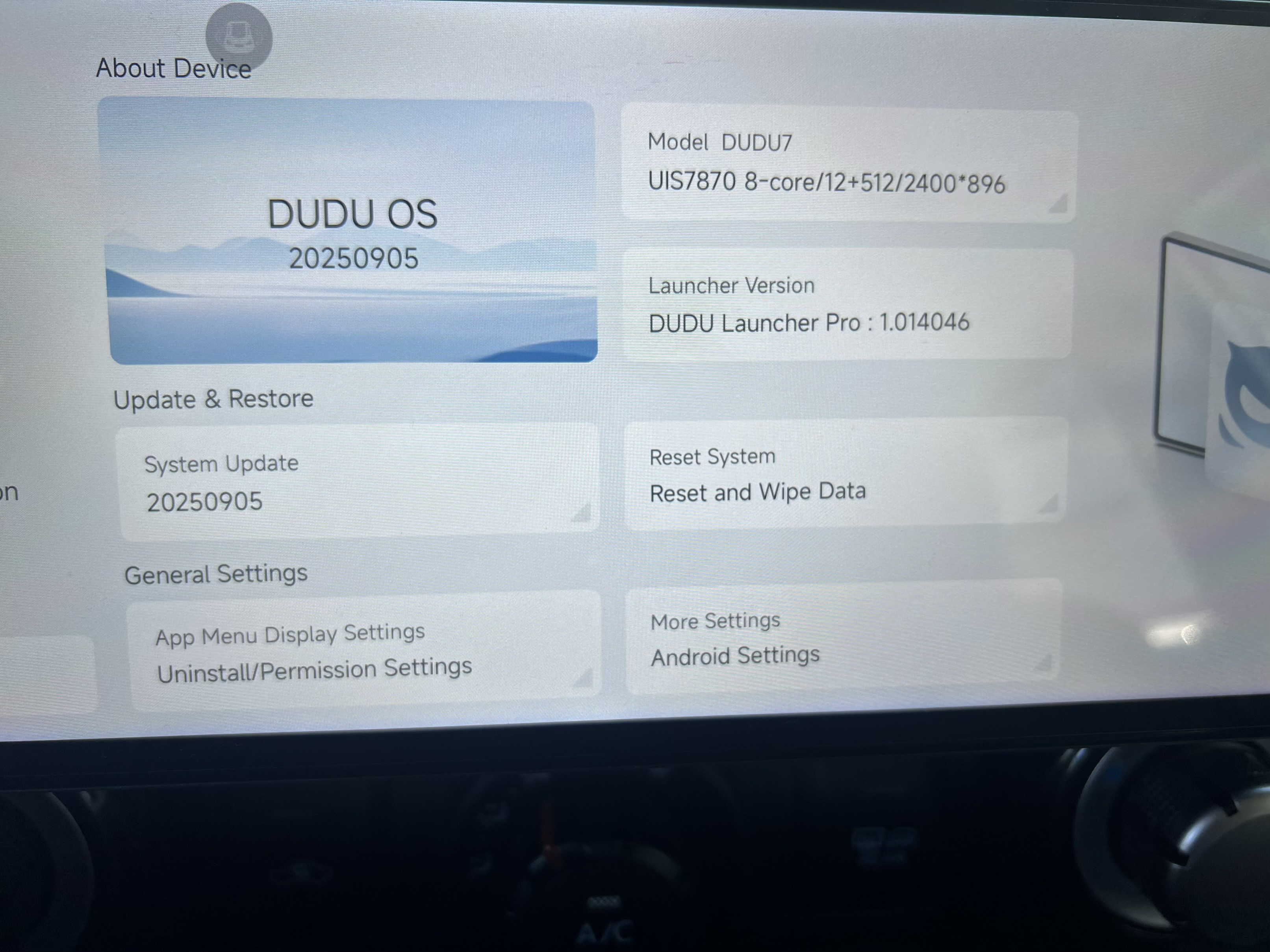

I am using the analog RCA line-out from the Dudu7 directly into an external amplifier (Pioneer GM-6500).
No optical or digital audio output is used.
So my impression is that:
on startup the AMP delay works as intended
but on shutdown and during call initiation, the amplifier may still be powered ON while the audio output or DSP state is muting / resetting, which produces the pop.
