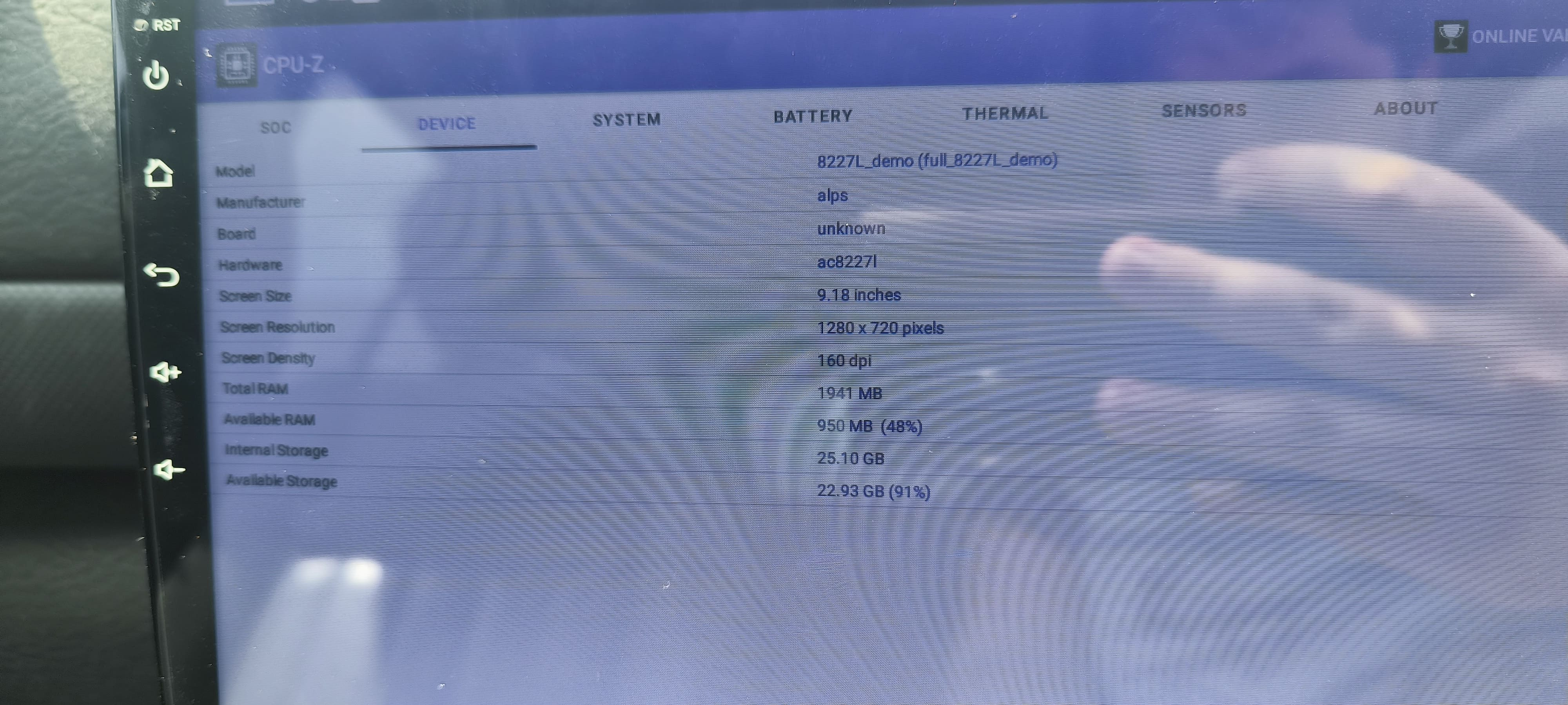

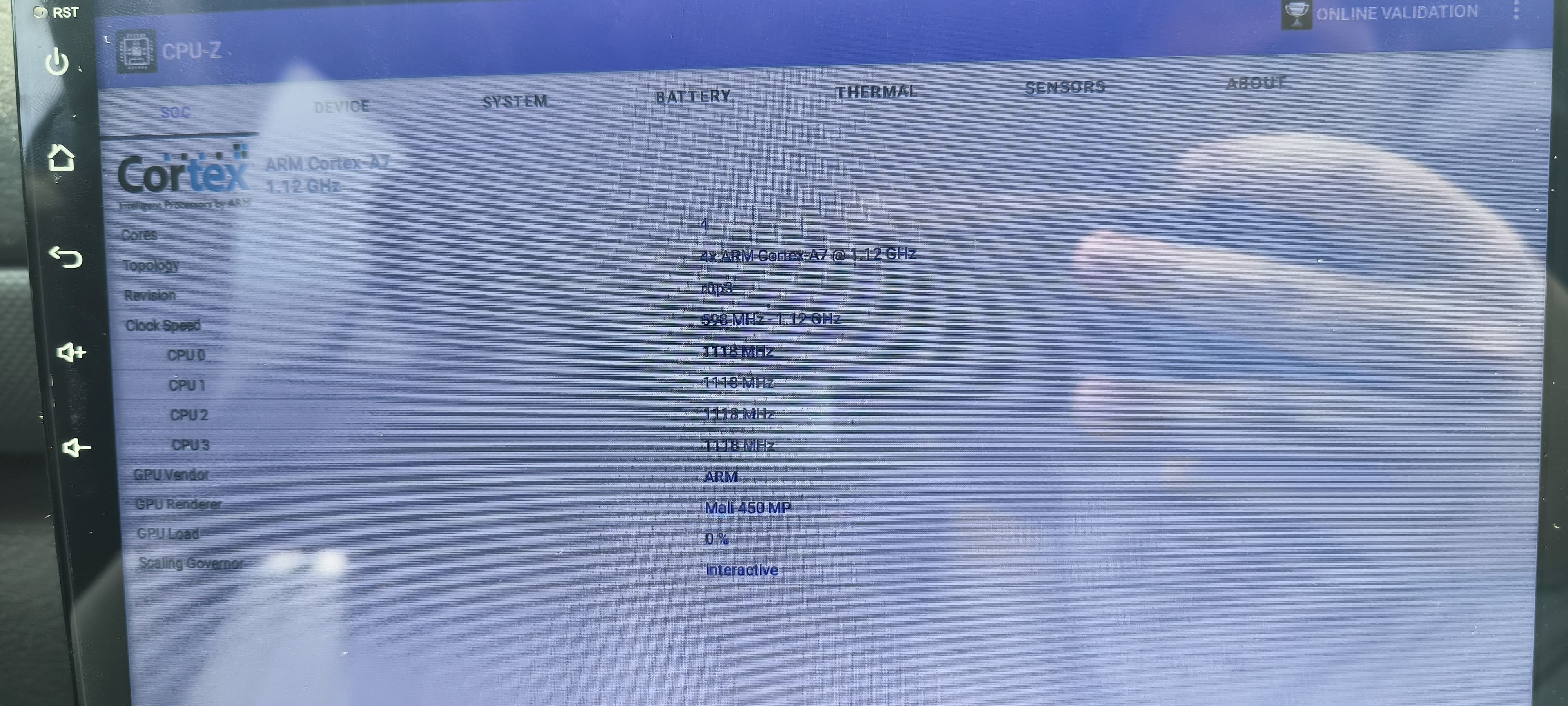

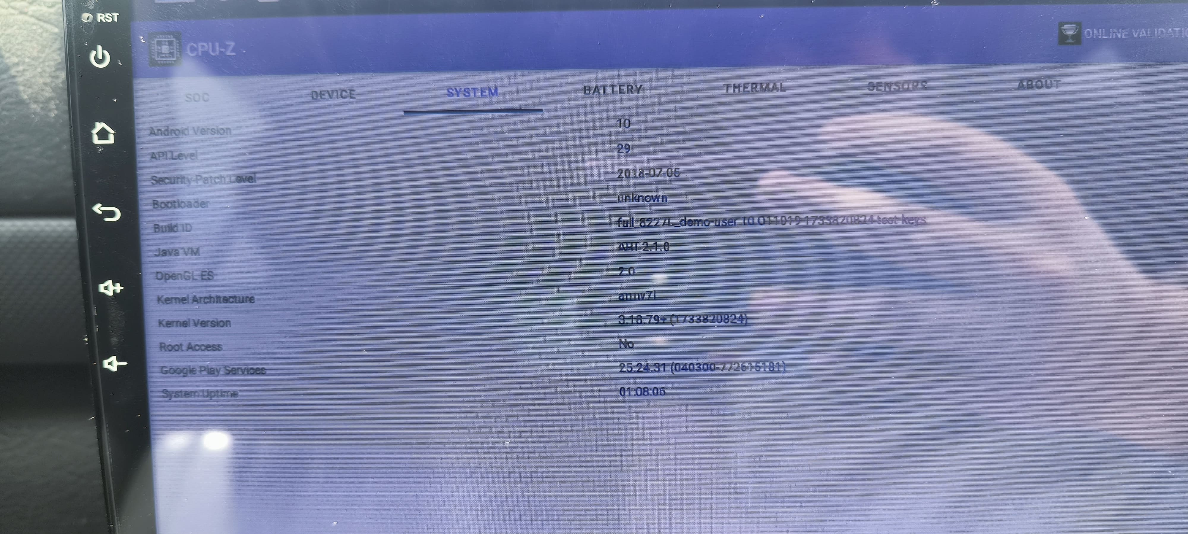

ianespana How can I enable PIP for my head unit? It is running Android 10 (API 29 confirmed with CPU Z), and I was able to install the public signed version, but the option for PIP does not appear at all
DUDU-Meng ianespana The AC8227L is a very low-end processor and can be considered the lowest-end chip for car hosts. It only supports 32-bit systems, and even if your system supports 8227, its performance is not sufficient to run PIP.
