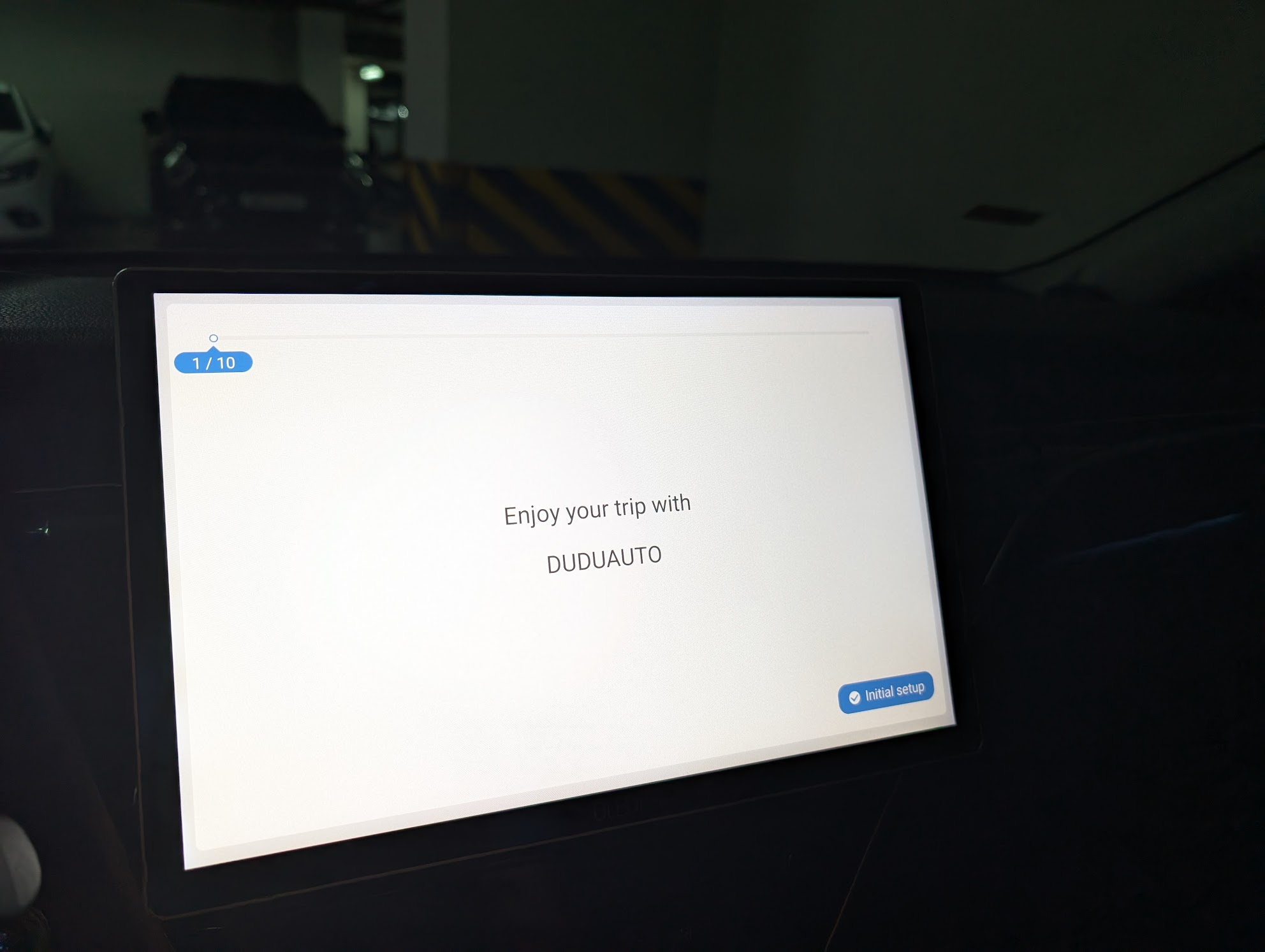

Every time, when I flash logo. The OS boot but require init setup first time and after that reset logo to the duduos logo

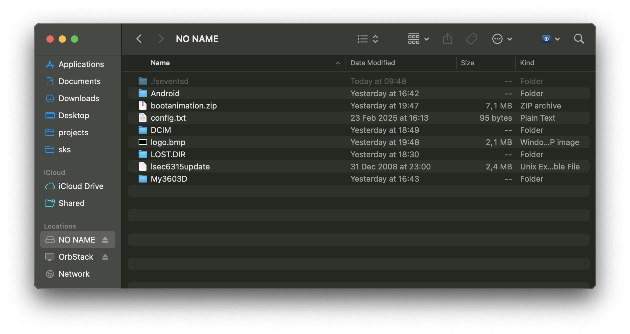

This is my folder structure
Flashing the logo and boot animation was completely successful. However, after each flash, the initialization screen of Dudu appears. After completing the setup, it reverts to the default logo, so I have to go into the settings to update the logo again afterward.

      Chubaka885 Thank you, but I mean is logo.bmp reverted to the default boot logo, you can see my logo.bmp in the screenshot

          tieume Es ist wegen der config.txt
          Jedes Mal wenn man diese flasht kommt der Setup Bildschirm.
          Lösche die Datei und flashe die bootanimation und das logo.
