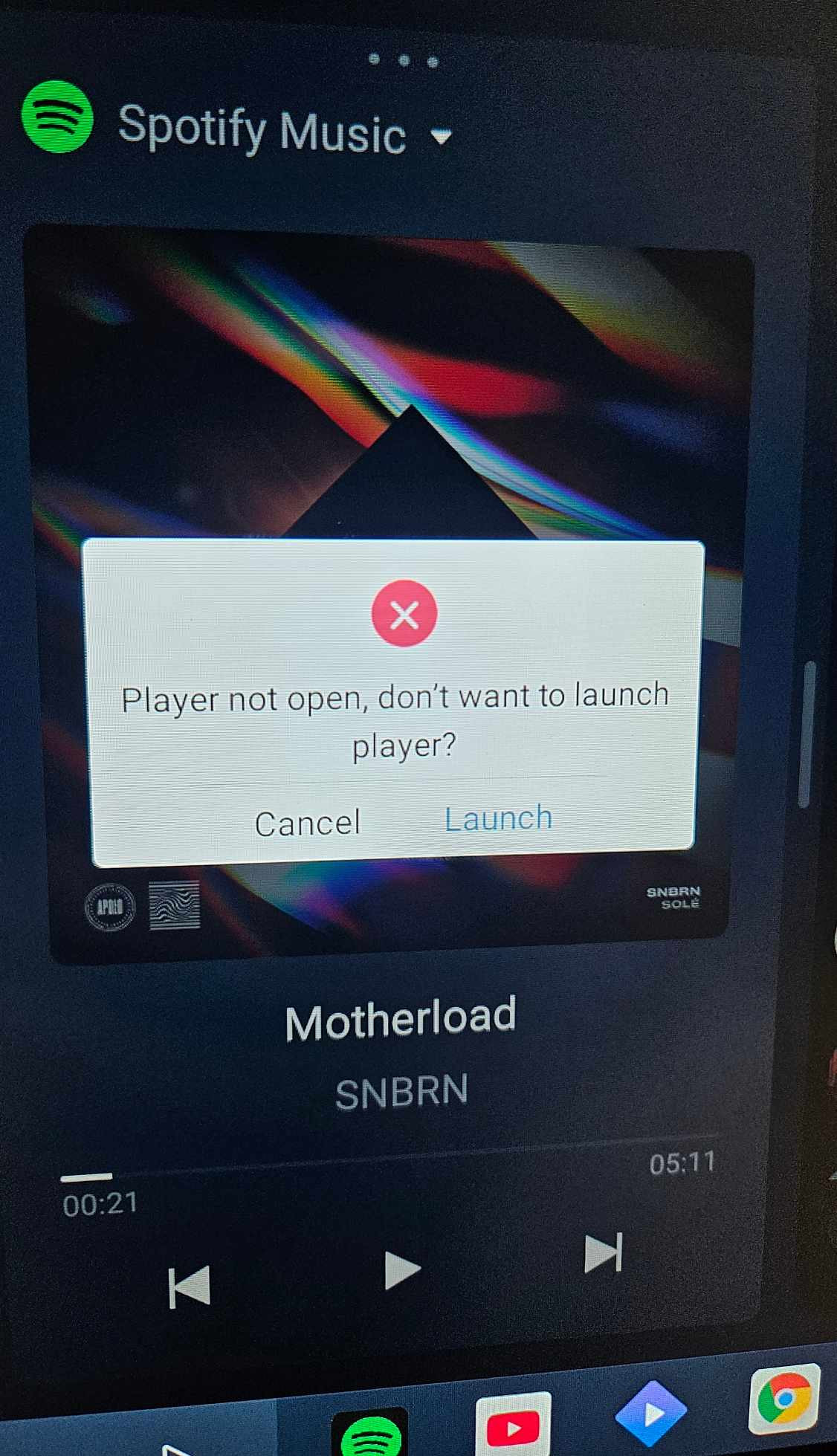

I'm using minimalist mode with Spotify selected in the music widget. Often (but not every time) when I start the vehicle and hit play on the widget, I get no response. The widget appears to have loaded but will not work. I'll need to start the Spotify app manually, then the widget works. Sometimes (not always) when hitting play I get an error message (see image).

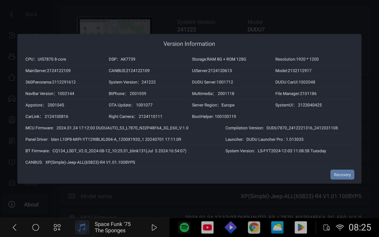

Running DUDU7 3.5.

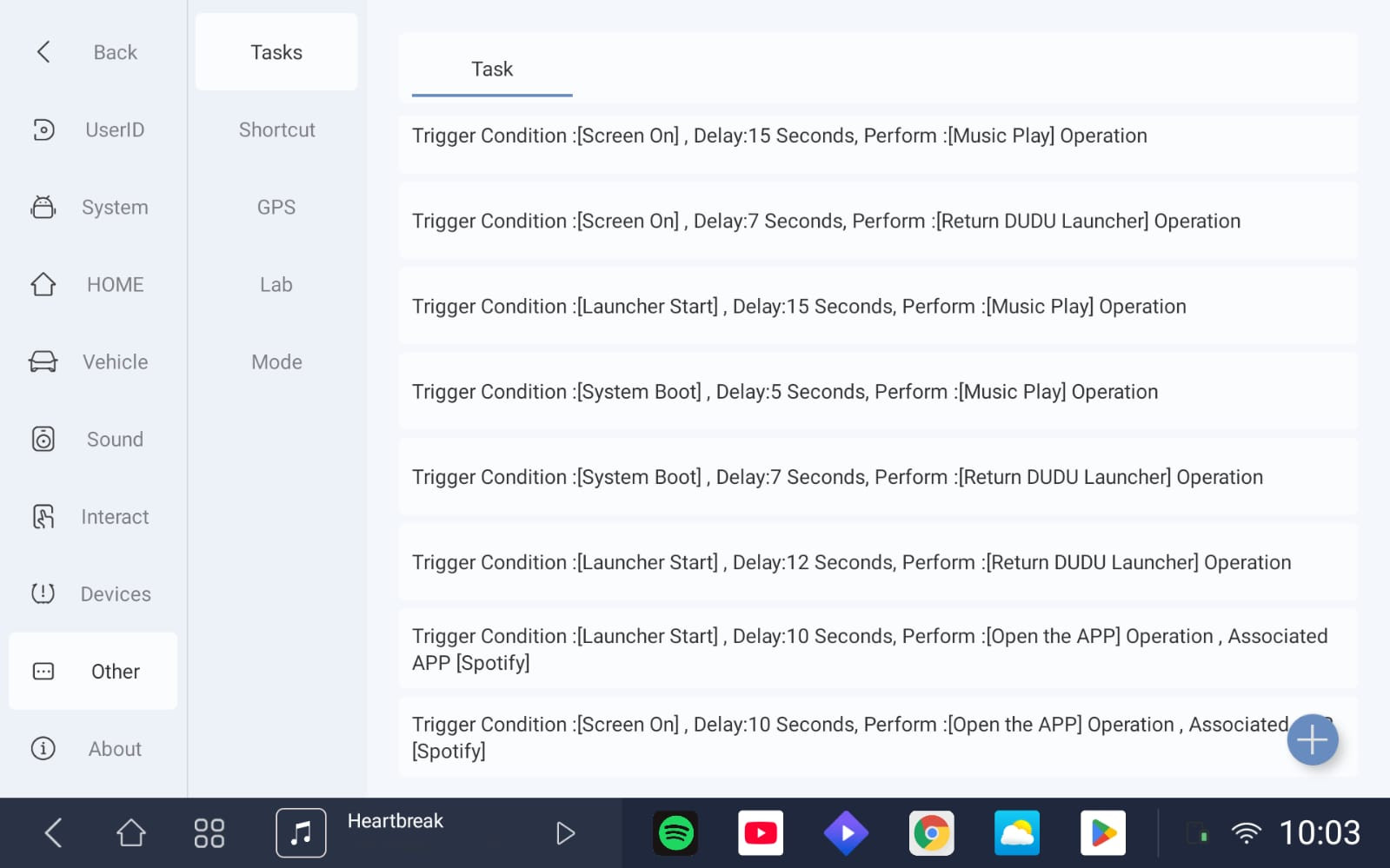

        Thanks for the suggestion. Here's what I've done:
        • Tried a variety of automated tasks and delay timings - open app after launch start, open app after screen on, open app after boot, 5 seconds, 10 seconds, etc. This seems to only work correctly after rebooting. Not after sleep. Current tasks I'm trying:

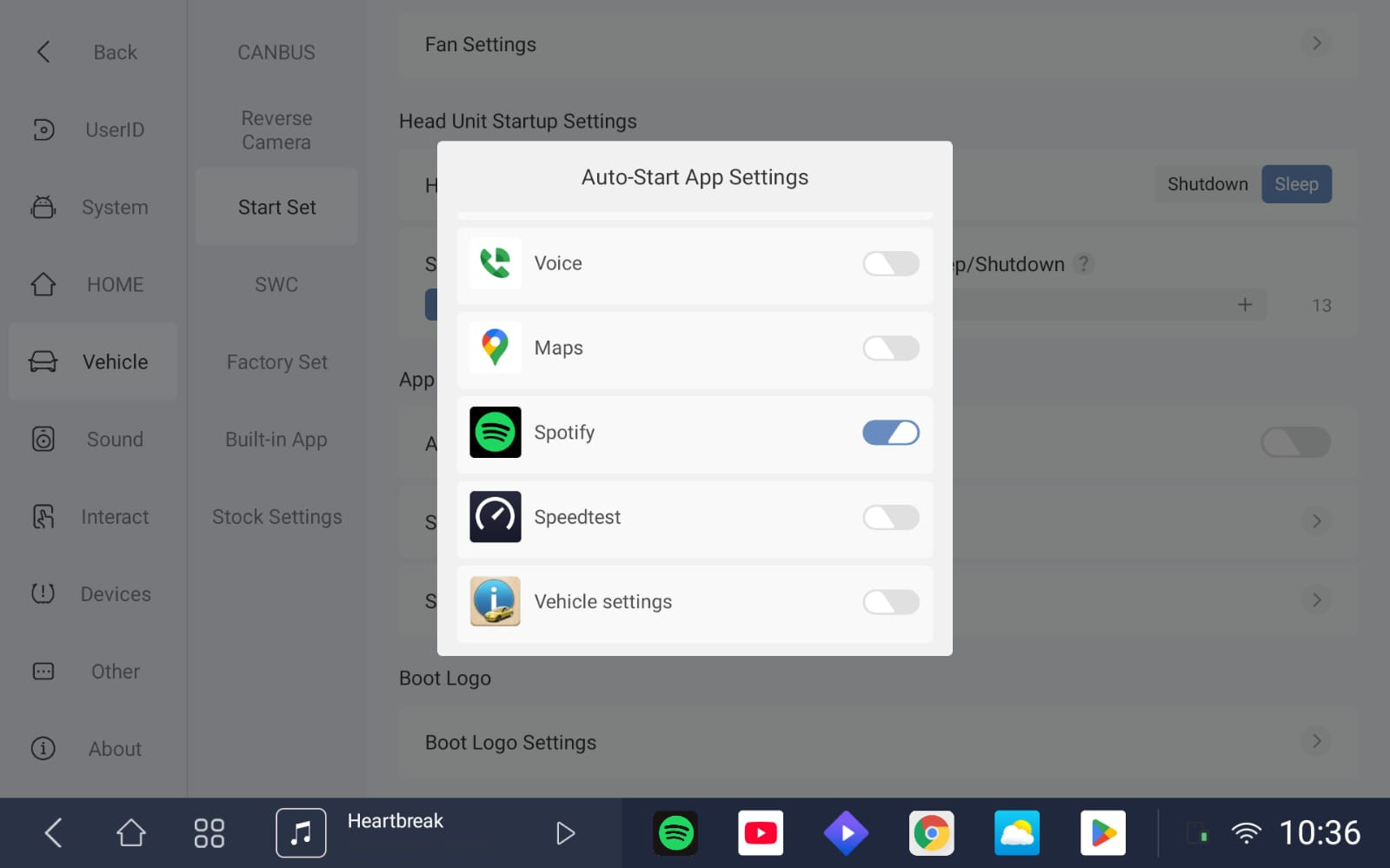

        • Selected Spotify under Start Set, Auto-Start App Settings. I assumed that this would work without needing an automated task. It does not work for Spotify, but it does work for AdGuard.
        • Selected Spotify under Keep Alive (do not sleep settings)
        • Via Android settings, I set Spotify battery management to Unrestricted
        • I've confirmed the failure to autoload doesn't occur with other widget apps in minimalist mode - Whatsapp, Google Maps, MyRadar, etc.
        • I've uninstalled/reinstalled Spotify.
        As far as I can tell, the widget is not loading Spotify automatically, automated tasks will not start Spotify after sleep, and Start Set will not load Spotify.

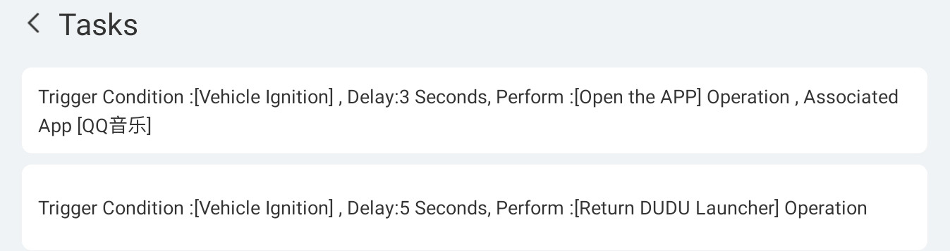

            Hey, for it to act the same as it does for reboot, you need to use the trigger Ignition on, this is the only one that works if you have the sleep mode activated.
            Screen on and System Boot are not compatible with sleep mode
            Try your setup that worked for a reboot with the Ignition on trigger
              CHR12345
              Oh wow, that worked! And it works when turning on to accessory mode as well as after starting the engine. I didn't even try "vehicle ignition" because it said "use this option if frequent hibernate" which didn't seem to apply to my situation. I had only tried the triggers under the Head Unit category.
              Thanks man! I've been trying to figure this out for a month. 🤣
              hrtloop Auto-task, change the trigger to vehicle ignition.
