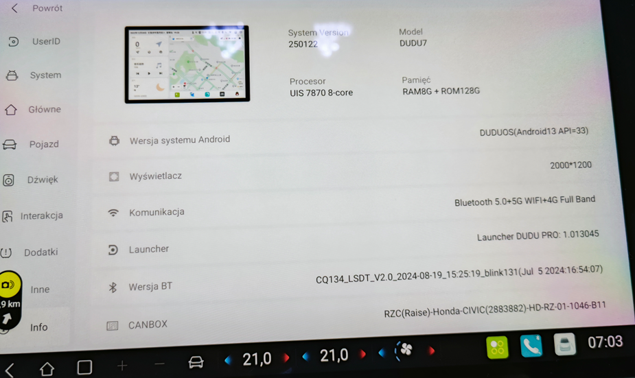

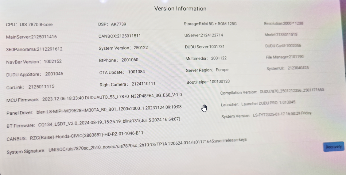

michal0111 Honda Civic 2017 Xgen EU. After turning on the air conditioning using the button on the AUTO knob, the air conditioning compressor starts, to turn off the only compressor , I go to the Climate Control menu and press the illuminated ON/OFF button to the left of the air flow rate and absolutely nothing happens, I press it again and nothing happens. Only turning on the AC on the right side of the air vent turns on the light, and after clicking AC again, the compressor turns off. So probably the information about the compressor status is not updated. https://www.youtube.com/watch?si=Yc_5TTZ9Fjq3d5Gz&v=T8fhs_EMiNg&feature=youtu.be

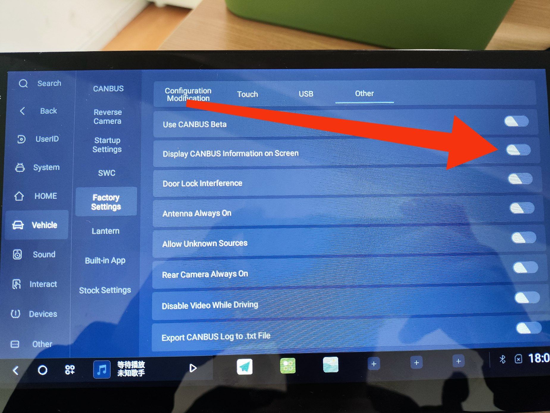

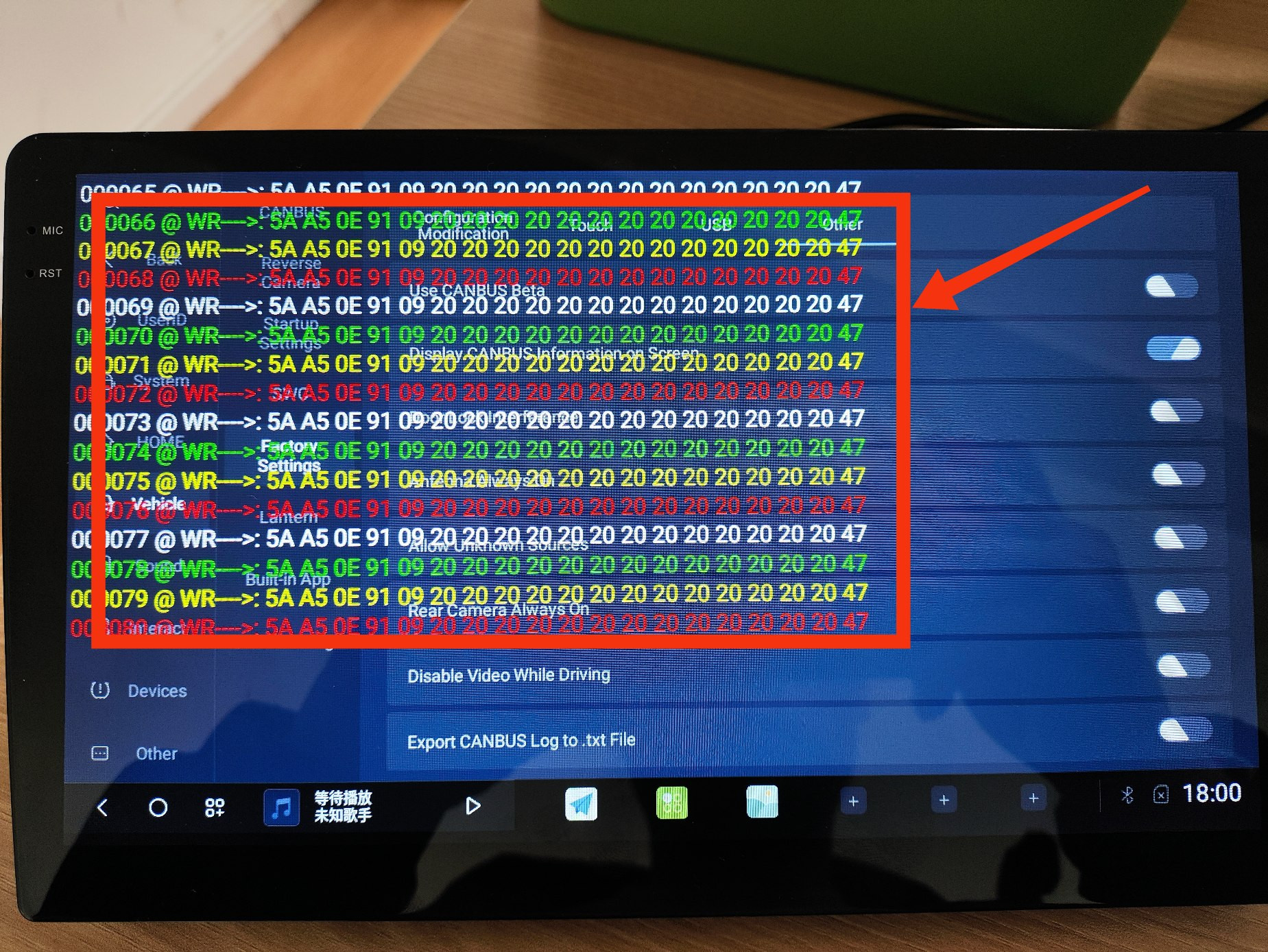

DUDU-Meng 1.Open this option Setup>Vehicle>Factory Set>Other>Protocol Information Printing 2.Operate the air conditioner and record video on your cell phone with hovering logs. 3.Open this option Setup>Vehicle>Factory Set>Other>Export CANBUS Log to .txt File 4.Open the Files app and send the log file from the canBusALog folder in the root directory here. 5.Send me the recorded video along with the CANBUS log TXT file.
michal0111 Link to the file and video, unfortunately valid only for 7 days, I cannot upload a .txt or .rar file here https://www.filemail.com/d/uczpdpvxrafshum
DUDU-Meng Please reshoot it. There's no hoverlog in the video. Give all the abnormal functions a go, and the hover log will show up.
