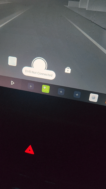

I have installed the DVR Camara that came along with DUDU7. I have installed all the hardware and apps as mentioned in wiki-dudu.
I am getting following issues -
  1. When I launch 2K DVR app, I Get a message saying 'DVR NOT CONNECTED ' though I have connected the DVR using USB

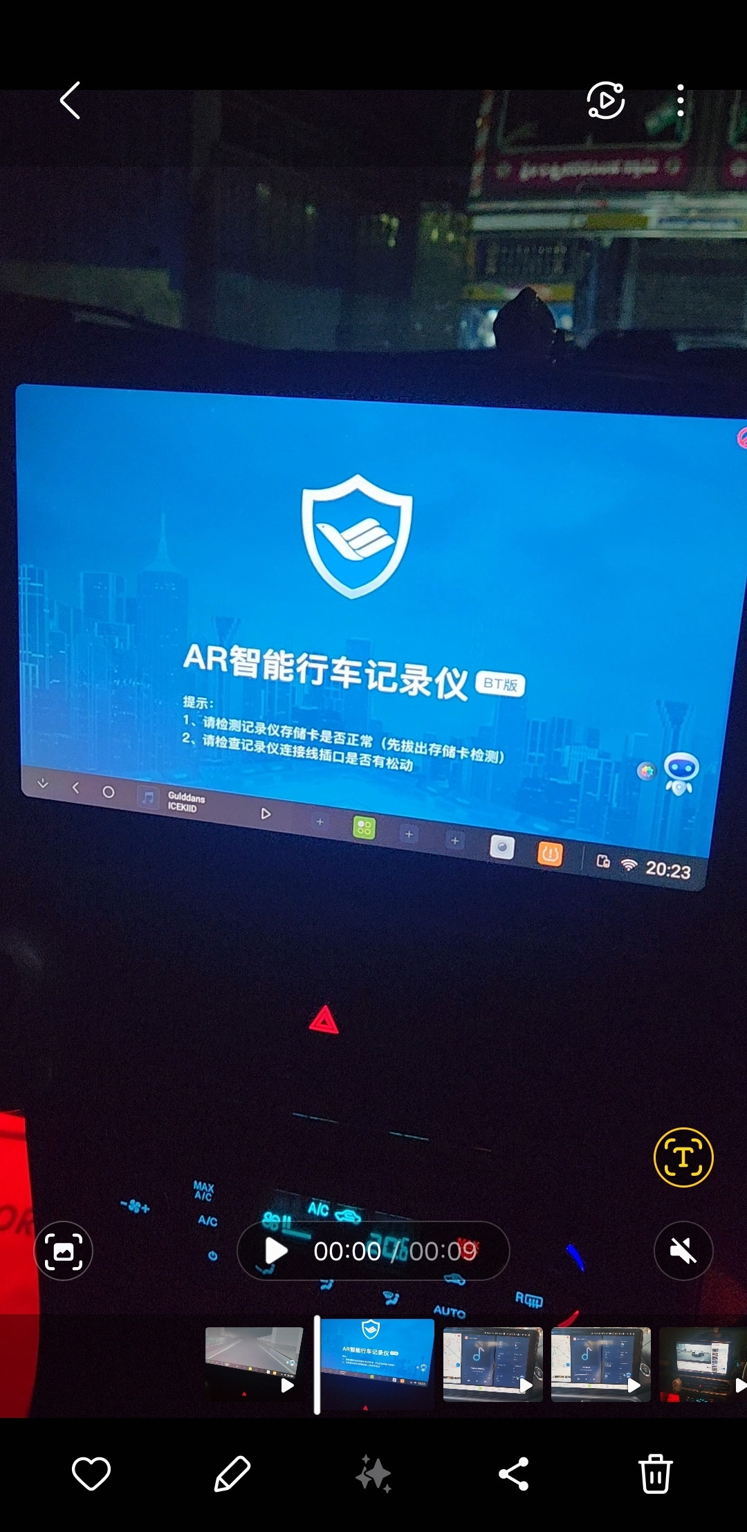

    Here is the image. The video/Camara turns on for 2 second and this page pops up and again it turns on after 2 second. This keeps on happening.
    2K dvr This is not the application.Take a picture of the recorder hardware.
    The picture that I uploaded few minutes back had a app install file in USB3 and the wiki-dudu instructed me to install that app to run my front DVR Camara
      Mitz You can see the picture of the recorder with this application, right?
      Yes but it's keeps fluctuating. The blue screen keeps pooping up. The video/picture is not stable.

        Yes, lot of fluctuations.
        When I open the app, the video switches on and the blue page comes back after 1sec. Then again the video switches back on for 1sec and again blue screen comes back. This happens continously.
